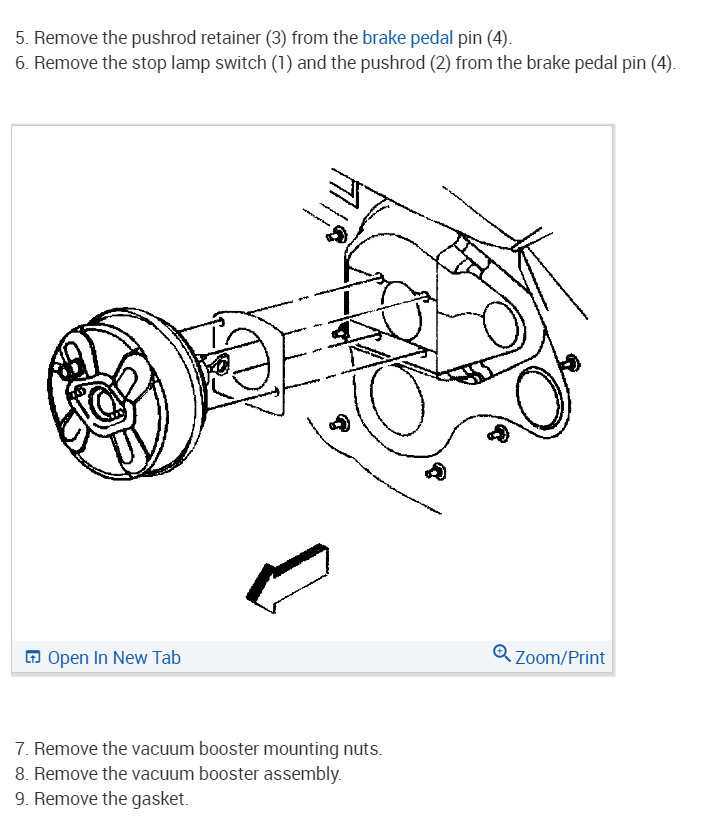

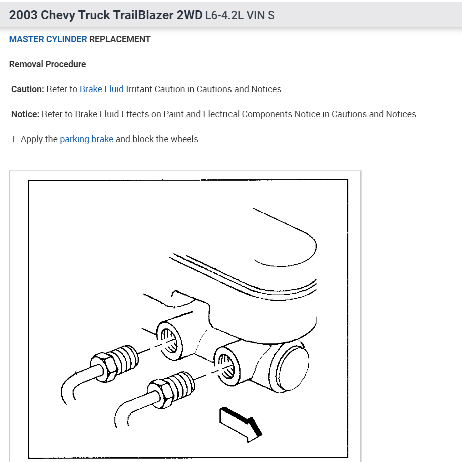

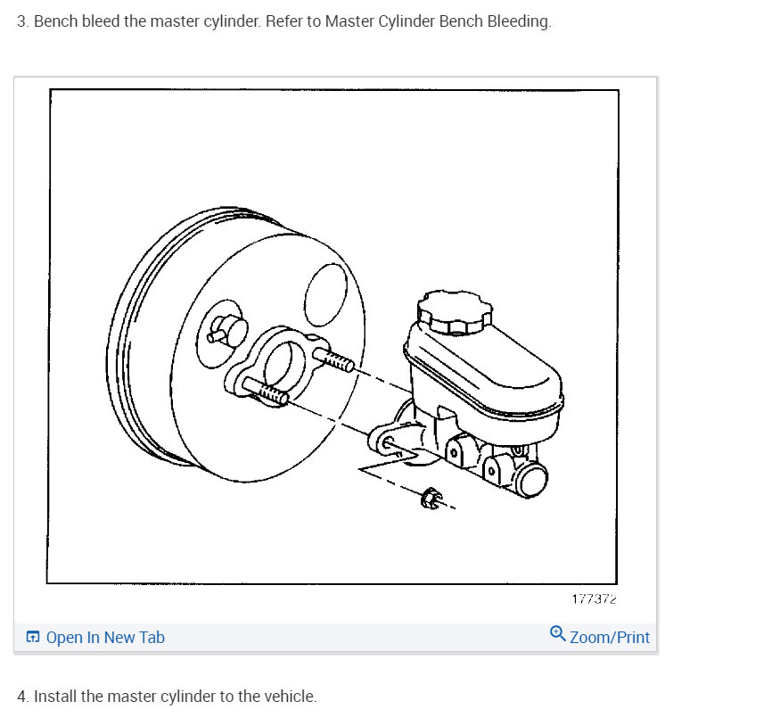

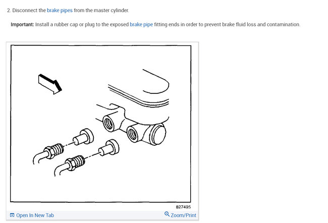

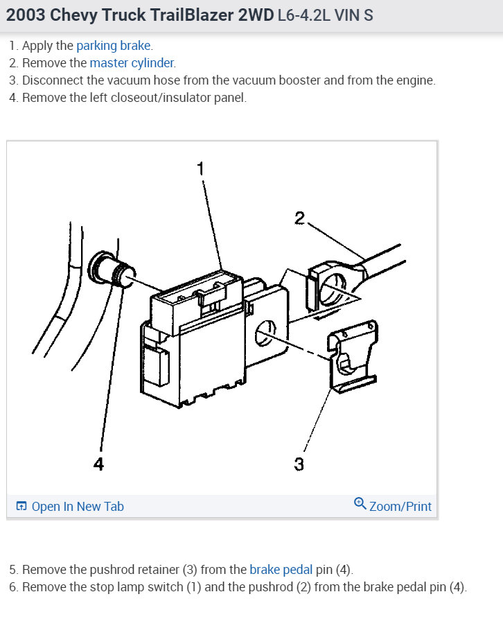

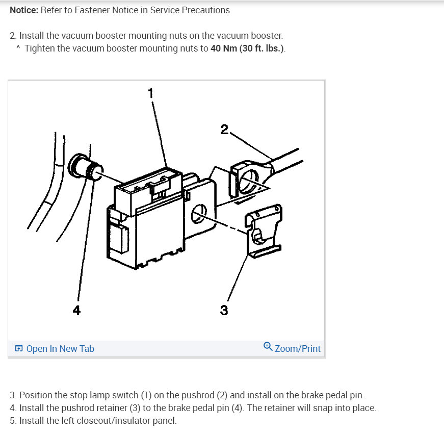

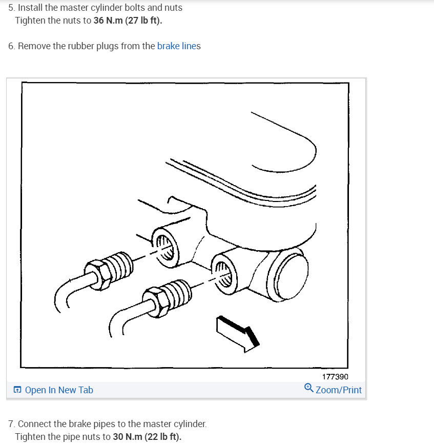

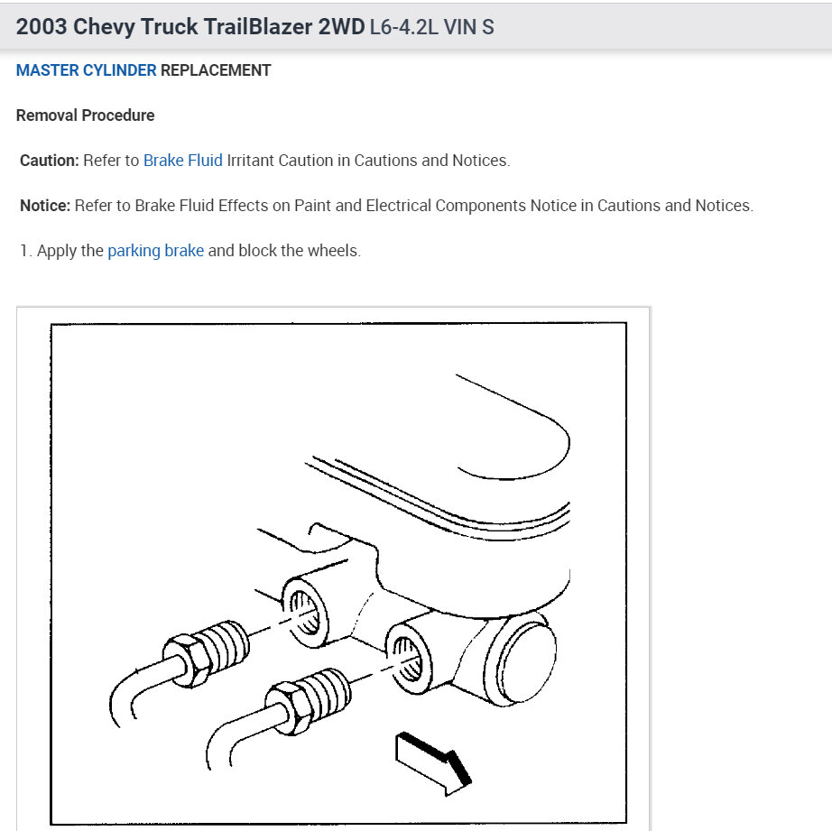

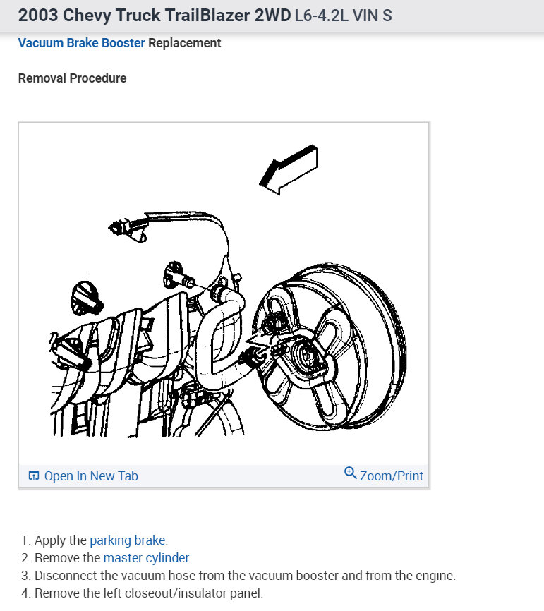

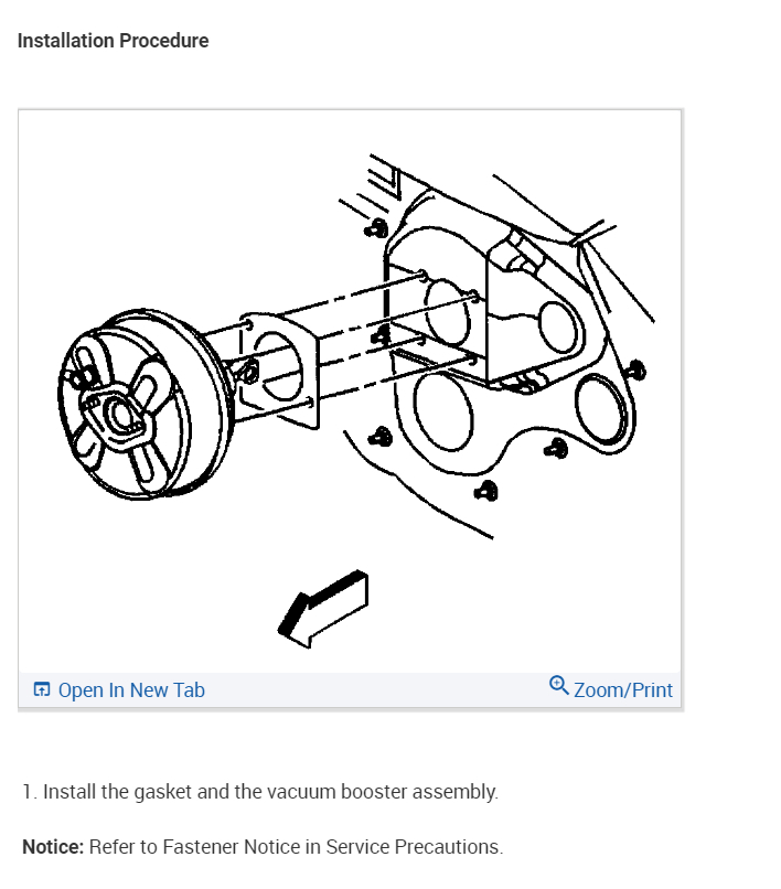

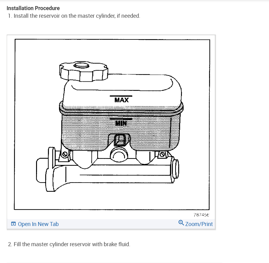

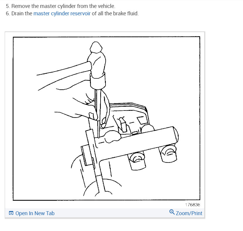

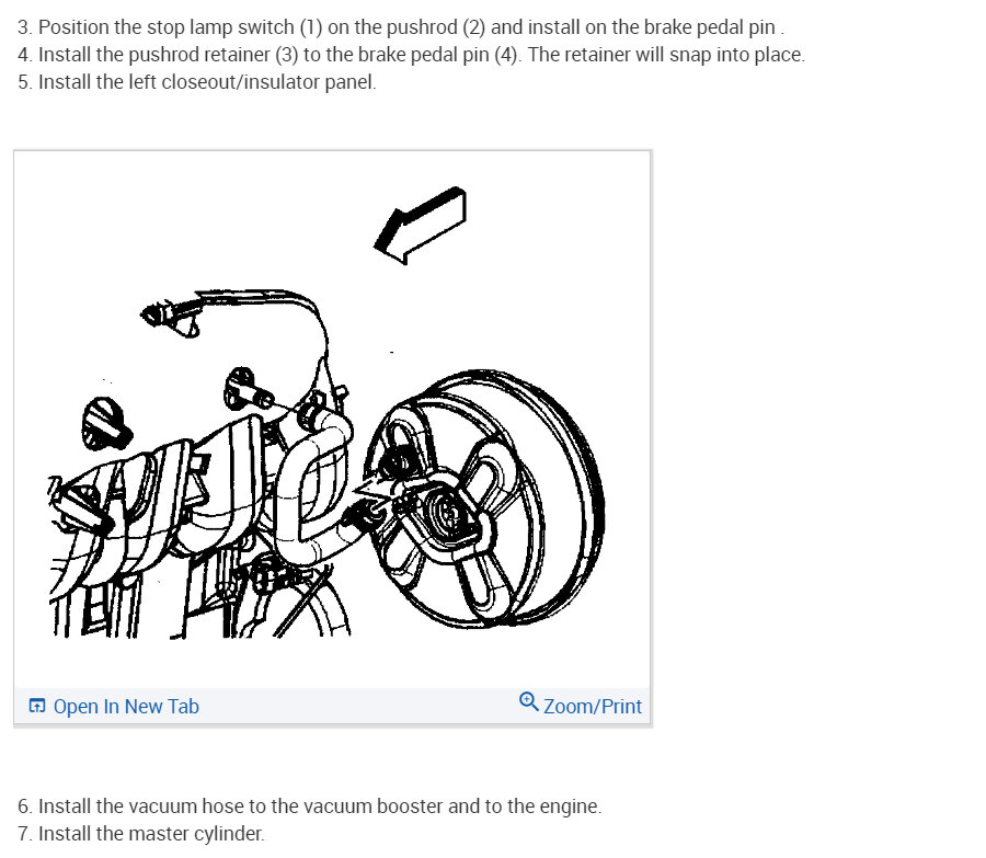

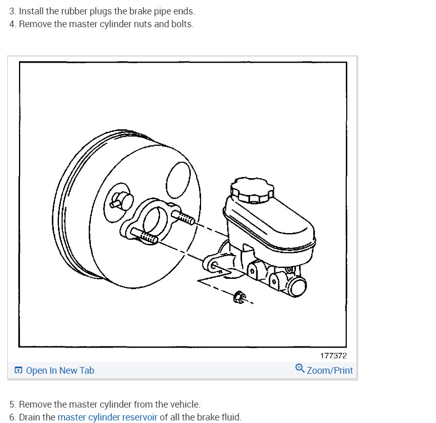

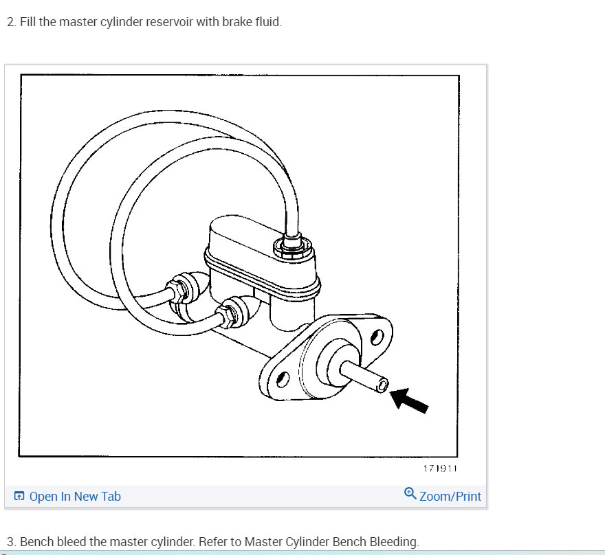

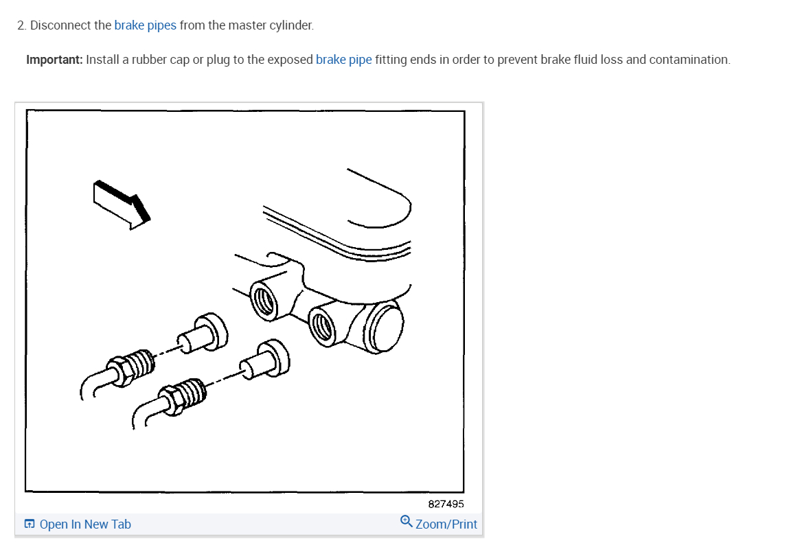

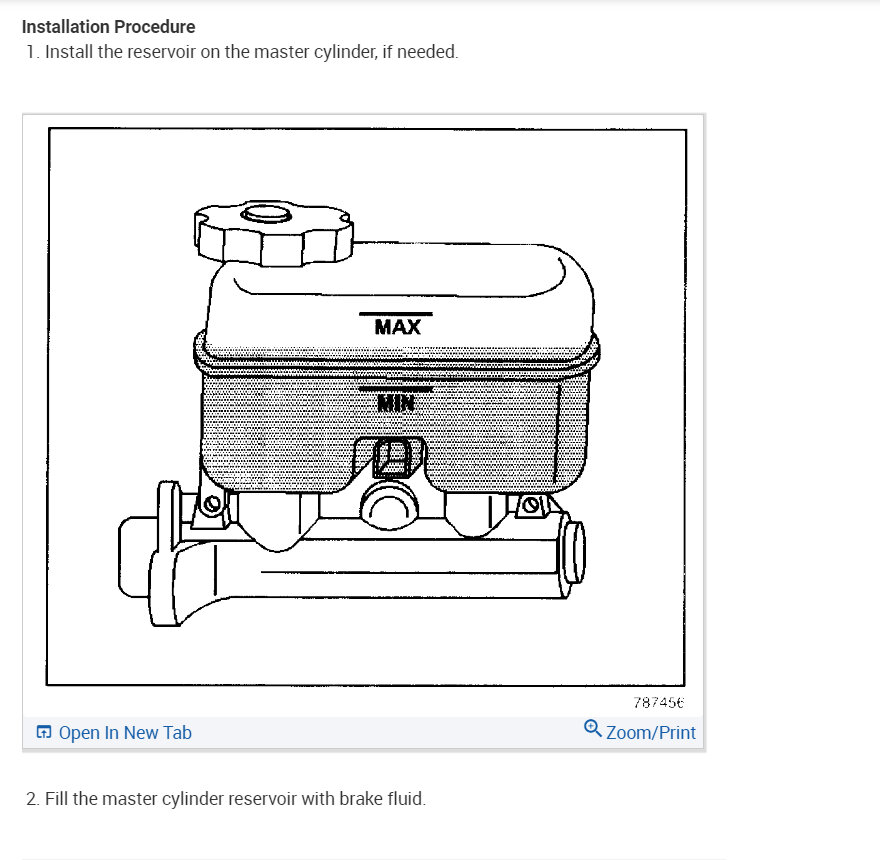

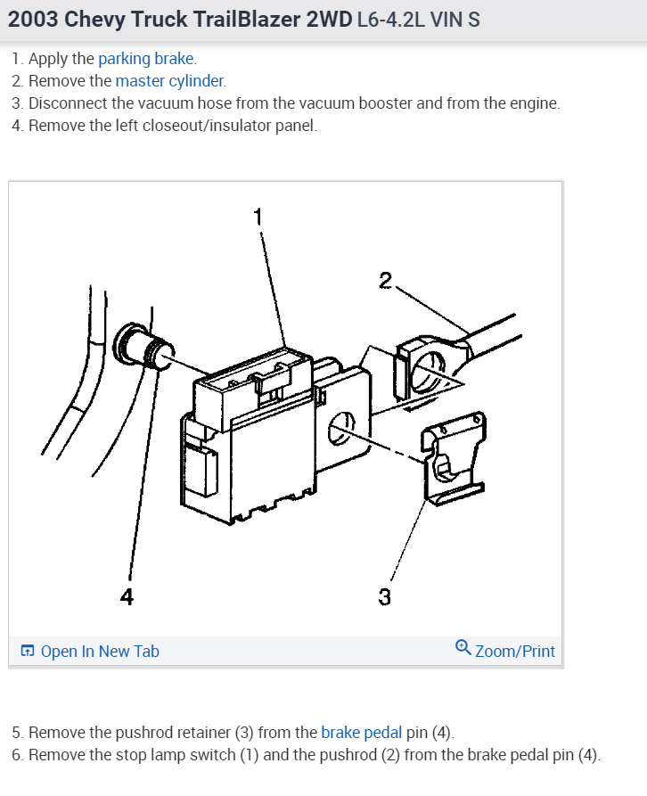

It sounds like the brake booster or brake master cylinder needs to be replaced, can you tell me when the vehicle is having the issue are the front wheels (both) hot? If so, this will be the problem. Please go over this guide to help:
https://www.2carpros.com/articles/a-comprehensive-guide-to-fixing-automotive-brakes-locking-up
This video will help as well:
https://youtu.be/WDxvEQrMkBg
