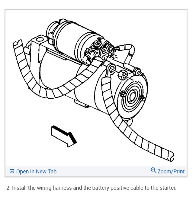

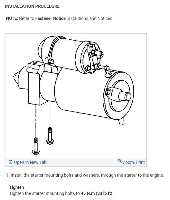

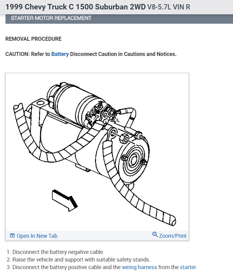

What size socket is used to remove the starter?
Jul 15, 2019 at 10:56 AM
SCGRANTURISMO
  • 4,897 POSTS
Fastener or"Bolt" sizes do not go by the size of the head. They go by the width of the fastener(either (M)etric or Automotive Standard Excellence(ASE)(standard),length of the fastener, and pitch of the threads. A 15 MM socket should work for the mounting bolts. Please get back to us and let us know how it turns out.

Jul 15, 2019 at 1:24 PM
  • 110,244 POSTS

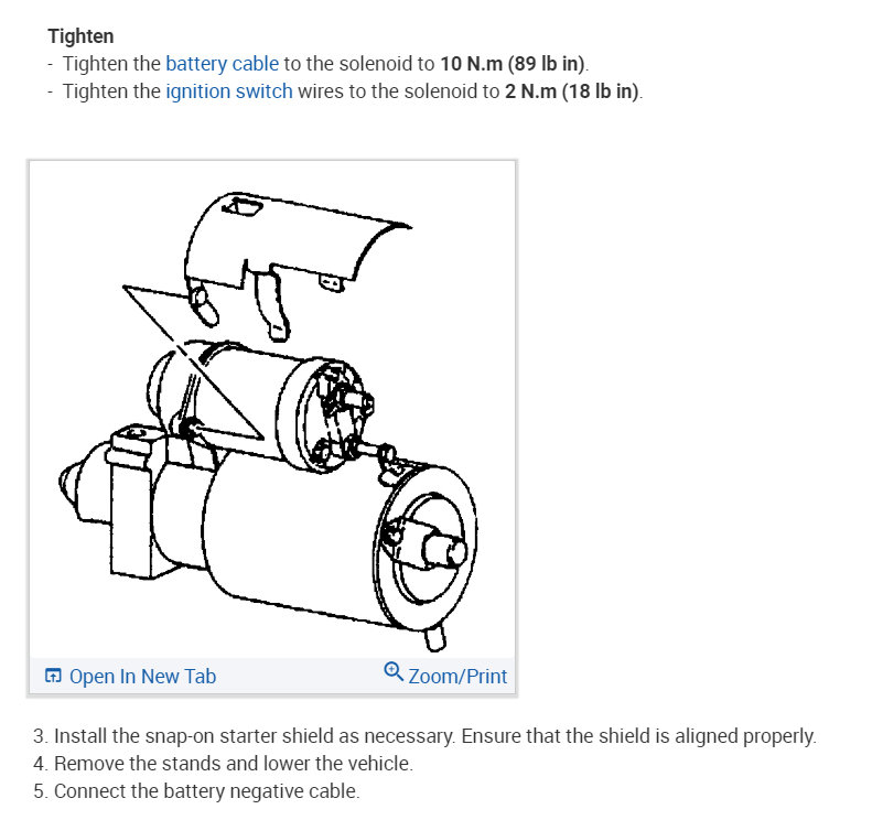

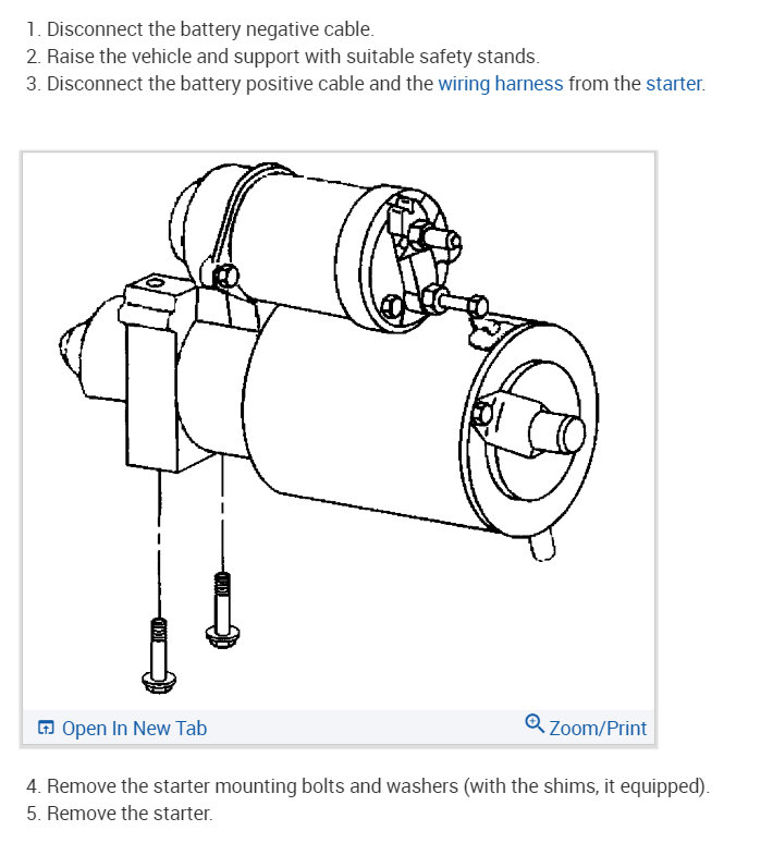

the hex size isn't listed in the manual. However, I believe it is either 14mm or 15mm. Keep in mind, you will need to remove the wiring from the solenoid. Just make sure the battery is disconnected before you start. Check out the diagrams (Below). Please let us know if you need anything else to get the problem fixed.
Here is a link that explains how in general a starter is replaced:
Here are the directions specific to removal and replacement of the starter for your vehicle. The attached pictures correlate with the directions.
REMOVAL PROCEDURE
CAUTION: Refer to Battery Disconnect Caution in Service Precautions.
1. Disconnect the battery negative cable.
2. Raise the vehicle and support with suitable safety stands.
3. Disconnect the battery positive cable and the wiring harness from the starter.
4. Remove the starter mounting bolts and washers (with the shims, if equipped).
5. Remove the starter.

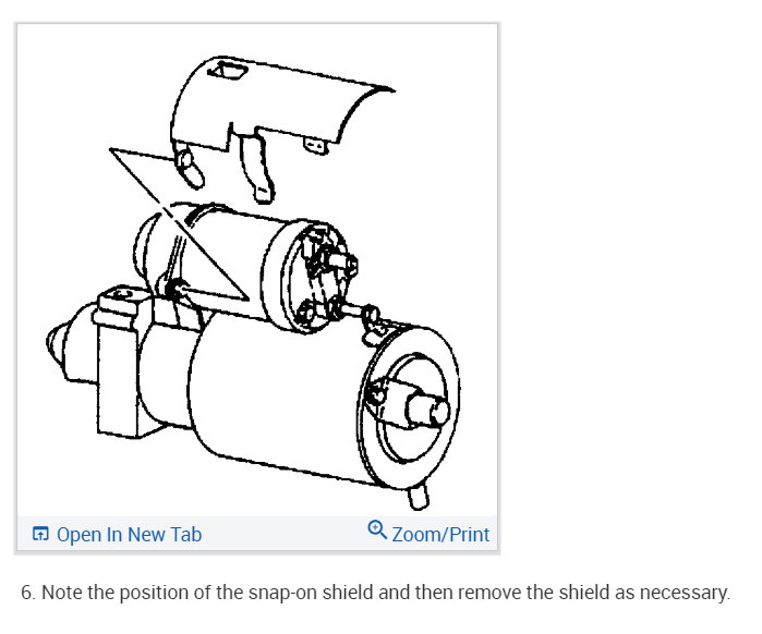

6. Note the position of the snap-on shield and then remove the shield as necessary.
INSTALLATION PROCEDURE
NOTE: Refer to Fastener Notice in Service Precautions.
1. Install the starter mounting bolts and washers, through the starter to the engine.
Tighten
Tighten the starter mounting bolts to 45 N.m (33 lb ft).
2. Install the wiring harness and the battery positive cable to the starter.
Tighten
- Tighten the battery cable to the solenoid to 10 N.m (89 lb in).
- Tighten the ignition switch wires to the solenoid to 2 N.m (18 lb in).
3. Install the snap-on starter shield as necessary. Ensure that the shield is aligned properly.
4. Remove the stands and lower the vehicle.
5. Connect the battery negative cable.

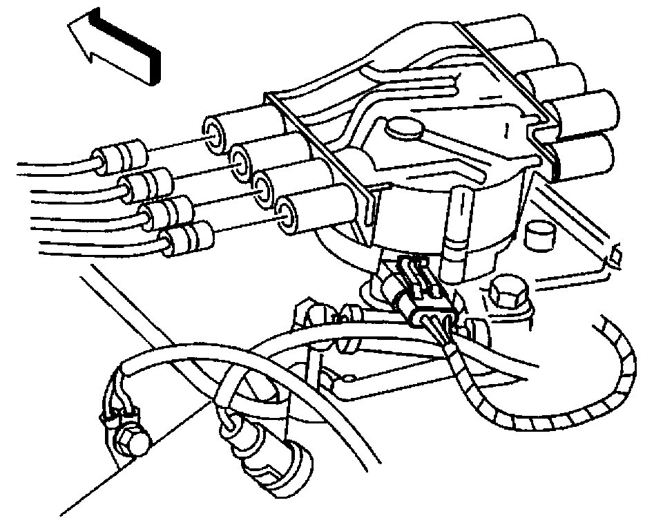

I ask becuase I need to replace the Camshaft Positioning Sensor.
The YouTube video I viewed explained the starter needed to be removed in order to access and replace the sensor.
Thank you fellas and God bless you.

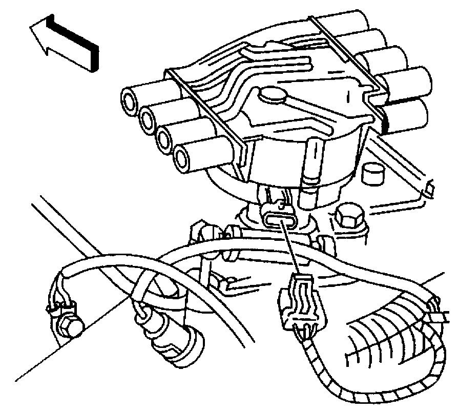

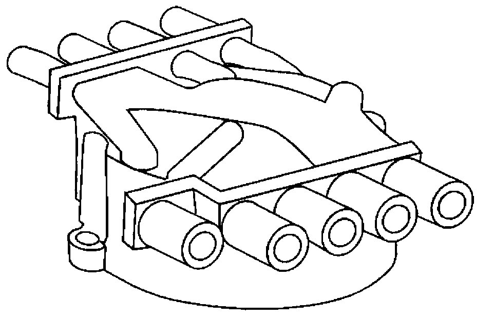

Jul 15, 2019 at 2:14 PM
  • 110,244 POSTS
Welcome back: Check out the diagrams (Below). Please let us know if you need anything else to get the problem fixed.

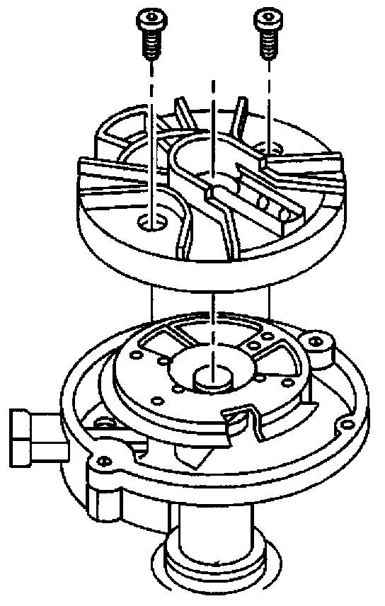

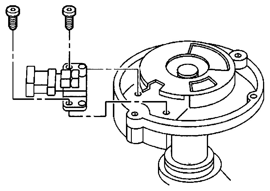

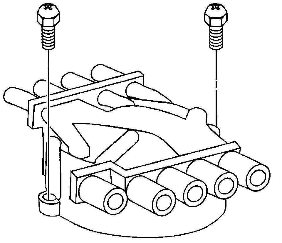

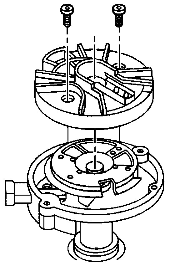

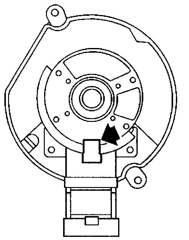

Do you mean the camshaft sensor or crankshaft position sensor? If it is the camshaft position sensor, you are at the wrong place on the engine. Behind the starter is the crankshaft position sensor. The camshaft position sensor on this vehicle is in the distributor.
Here are the directions for replacing the camshaft position sensor. The attached pictures correlate with the directions. Also, when you remove the distributor cap, make sure to make which spark plug wire goes to which tower on the distributor cap. They must be put back in the same place or ignition timing will not be correct. If possible, leave them connected and carefully move the distributor cap out of the way.
1. Disconnect the negative battery cable.
2. Disconnect the spark plug wires and ignition coil wire from the distributor.
3. Disconnect the Camshaft Position (CMP) sensor harness connector from the distributor.
4. Remove the distributor cap screws.
5. Remove the distributor cap.
6. Remove the rotor screws.
7. Remove the rotor.

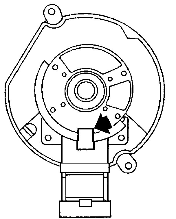

8. Align the square slot in the reluctor wheel with the CMP sensor.
9. Remove the CMP sensor fasteners.
10. Remove the CMP sensor.
IMPORTANT: Do not use the old cap screws, CMP sensor screws, or rotor screws. Use replacement screws that have been coated with a thread locking compound. Precoated replacement distributor cap and CMP sensor screws can be acquired using P/N 10475922 (pkg of 10 screws). Precoated replacement rotor screws can be acquired using P/N 10475924 (pkg of 10 screws).
1. Align the square slot in the reluctor wheel with the CMP sensor.
2. Insert the CMP sensor through the reluctor wheel slot.
3. Install new CMP sensor mounting screws.
Tighten
Tighten the screws to 1.6-2.8 N.m (14-25 lb in.).
IMPORTANT: The locating tabs on the rotor are necessary for correct alignment of the rotor. If the tabs are missing or damaged, replace the rotor.
4. Install the rotor onto the reluctor wheel.
5. Install new rotor screws.
Tighten
Tighten the screws to 1.5-2.4 N.m (13-22 lb in.).
6. Install the distributor cap.
7. Install new distributor cap screws.
Tighten
Tighten the screws to 1.8-3.0 N.m (16-26 lb in.).
8. Connect the CMP sensor harness connector.
9. Connect the spark plug wires and ignition coil wire.
10. Connect the negative battery cable.

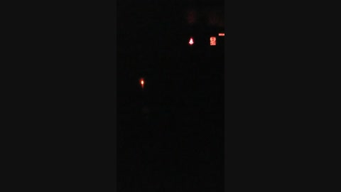

Is sounds like its trying to start but bogs down and stops.
Jul 16, 2019 at 1:17 PM
  • 110,244 POSTS
Welcome back:
Is it possible for you to record what it is doing on your cell phone and upload it? That way I can hear and see what is happening.
Jul 16, 2019 at 1:31 PM
LUIS
  • 6 POSTS
Thank you. did it upload?
Jul 16, 2019 at 2:09 PM
  • 110,244 POSTS
Welcome back:
Yes it did upload. I have to be honest, it sounds like it could be a timing issue. Not being there makes it tough, but when it cranks, do you notice how the starter speeds and slows down? That is usually an indication of either a compression issue or timing.
