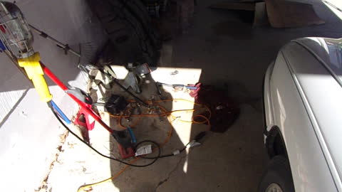

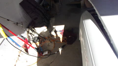

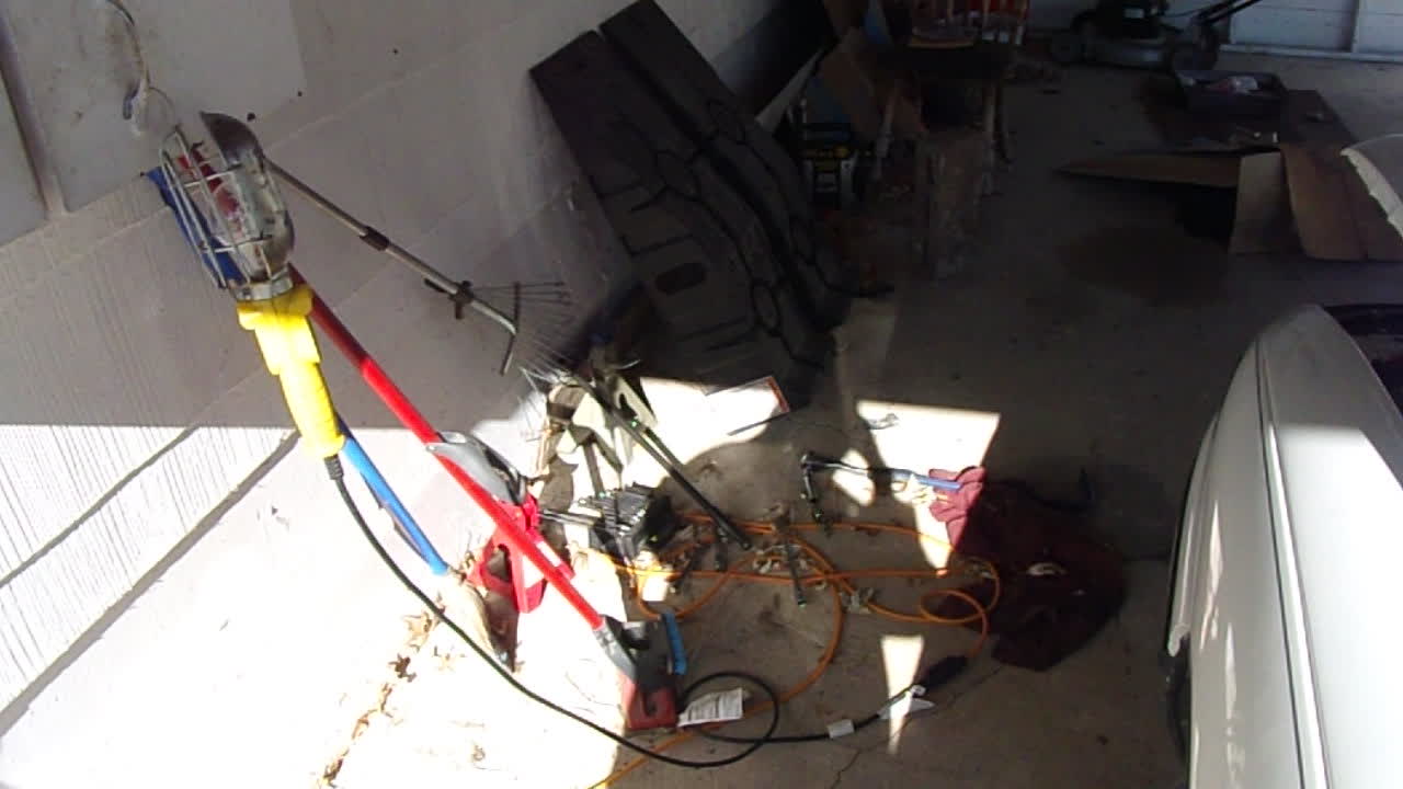

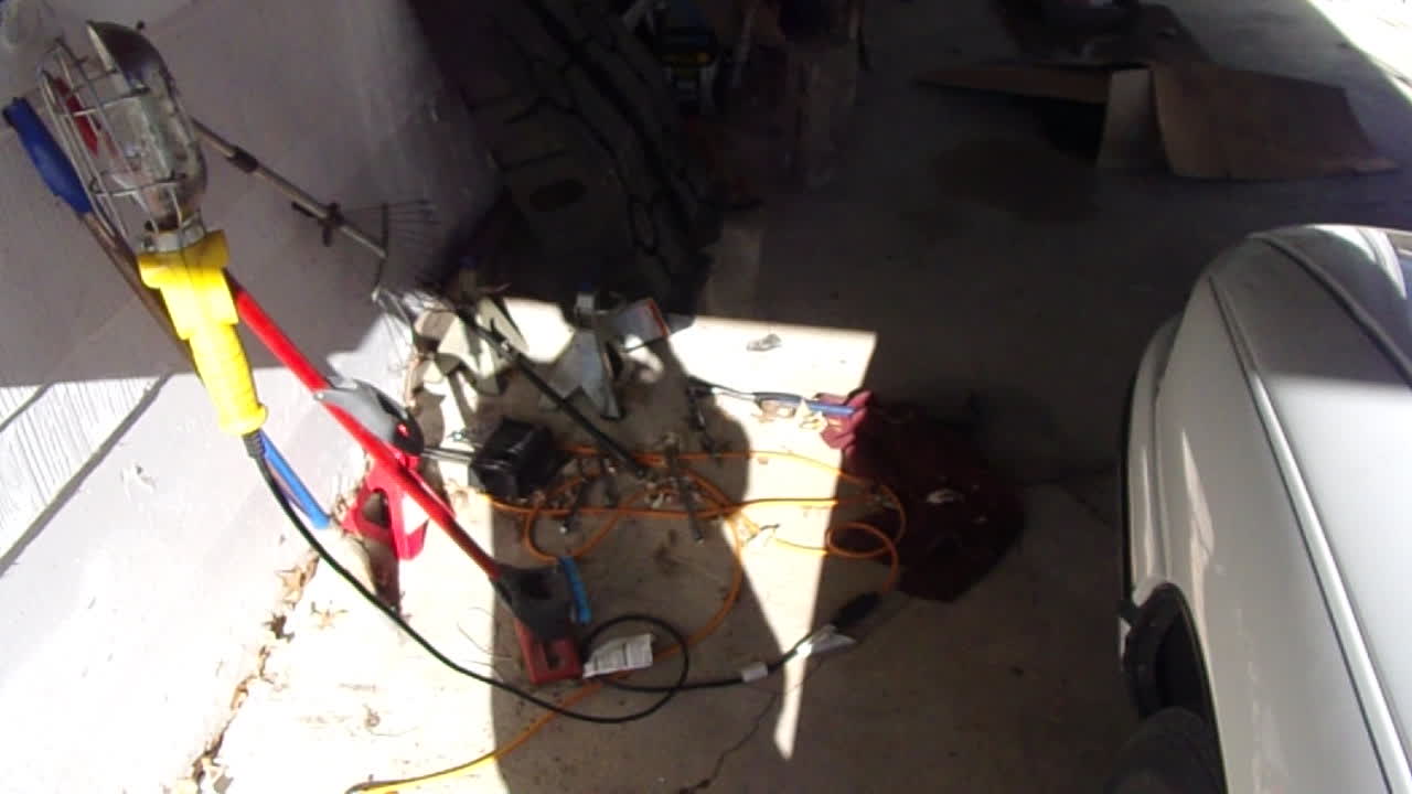

I didn't know that the camera I'm using wouldn't record the sound. I'm trying to send 2 short videos, so we shall see.
I'm sure you can see how bent that hinge is, to the point that the bottom part of the hinge will catch on the metal under it and will not allow the hood to raise very far. I'd suppose I could put something under the floor jack I had on the front of the bumper cover, I'm almost sure the hood would buckle enough to allow me to raise it a bit higher, it buckled enough to raise it that far. I could always take a big hammer to bend the hood back down a bit if needs be. At this point I'm not horribly concerned about looks but functionality, for the time being.
I don't know how far the bolts on the top of the fender go back so I don't know that I could get them all out at this point to remove the fender.
The chip in the windshield I had done, not the deer.
The car drives and handles about as well as it did before the old Buick got hungry for deer meat...

Thanks for the videos, they help. Yep, that is a predicament. Since the hood is bad anyway you are going to need to reverse the damage by attaching a chain or strap to the hood and pull it towards the front of the car to help bend the hinge back. This might be a body shop issue; they have the right equipment to force the hood forward. The windshield is broken as well so that ship has sailed, if you don't have a crack in the glass, it will have one after a few months. I don't like telling people to apply force in projects like this because it can cause injury if not done correctly.
