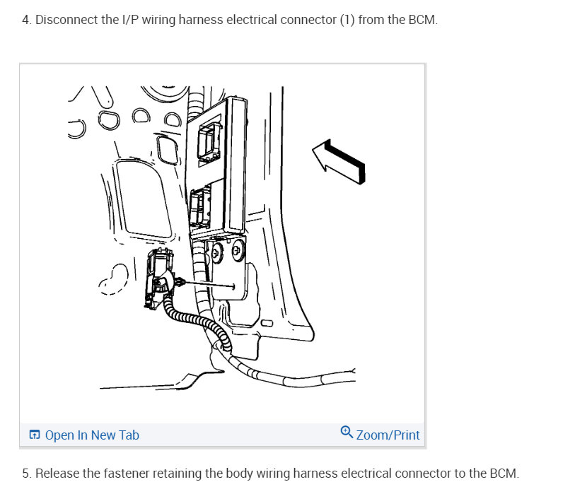

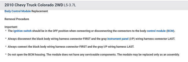

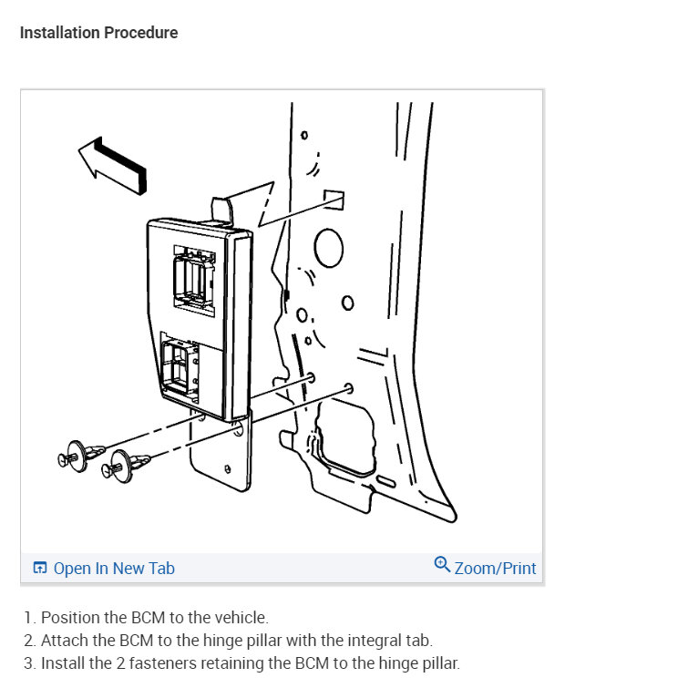

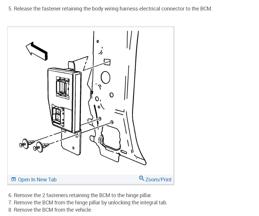

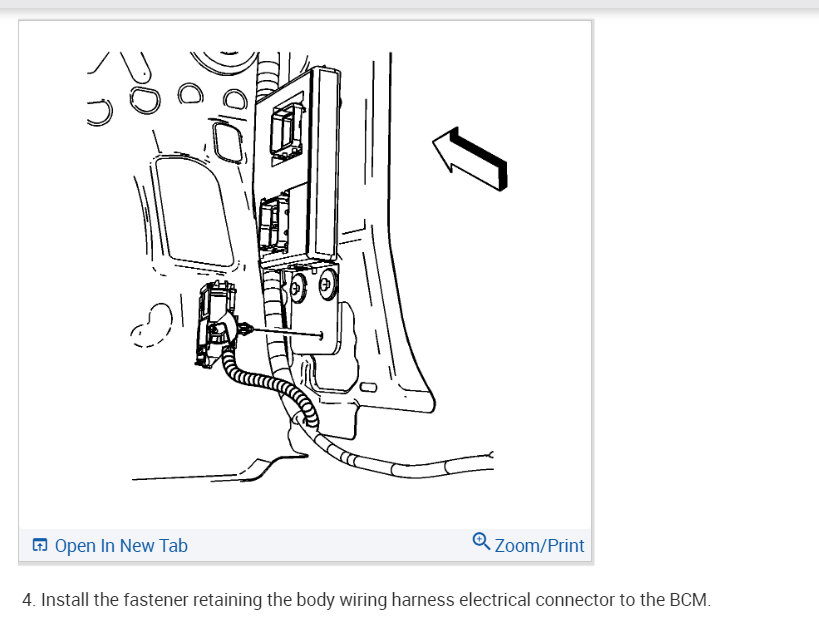

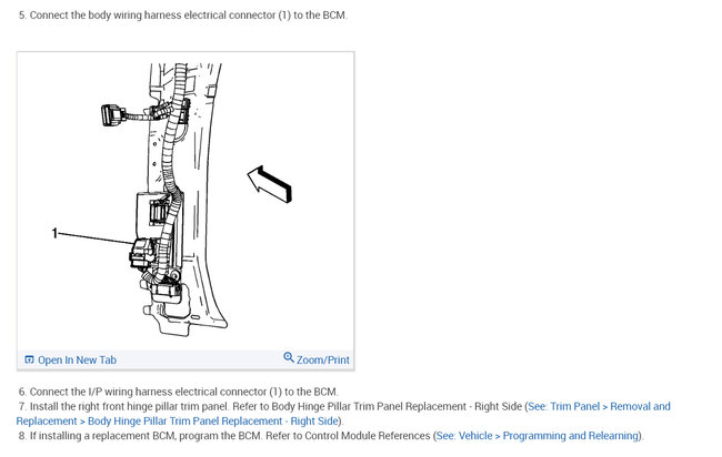

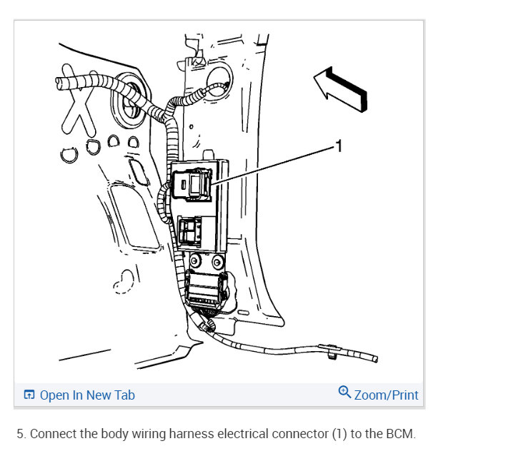

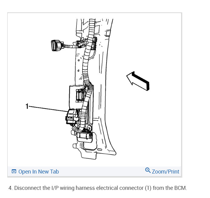

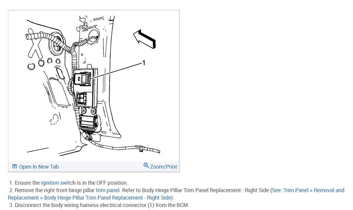

Here are the instructions on how to change out the BCM to make sure the job is being done correctly:
The ignition switch should be in the off position when connecting or disconnecting the connectors to the body control module (BCM).
Always disconnect the black body wiring harness connector first and the gray instrument panel (I/P) wiring harness connector last.
Always connect the black body wiring harness connector first and the gray I/P wiring harness last.
