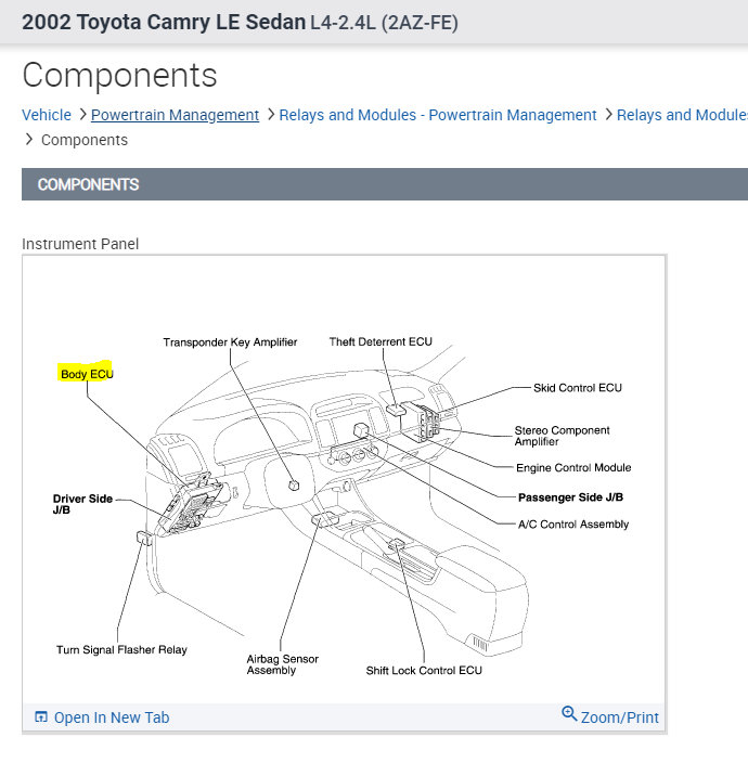

trying to find the location of the BCM to remove and replace the BCM.
Mar 10, 2022 at 11:19 PM
SQM
  • 6,383 POSTS
You have selected the engine as a 1.4L. However, in the United States they only offered these in 2.4L engine. So, the information below is for the 2.4L.
The body control module is located under the steering column by the left knee, behind the panel.

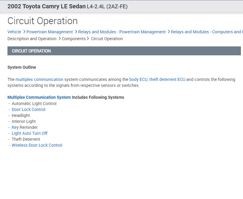

I wonder if the anti theft got triggered while you were changing out the BCM.
Is the security light on or flashing on the dash? Which will explain why it is not starting.
https://www.2carpros.com/articles/how-to-reset-a-security-system
