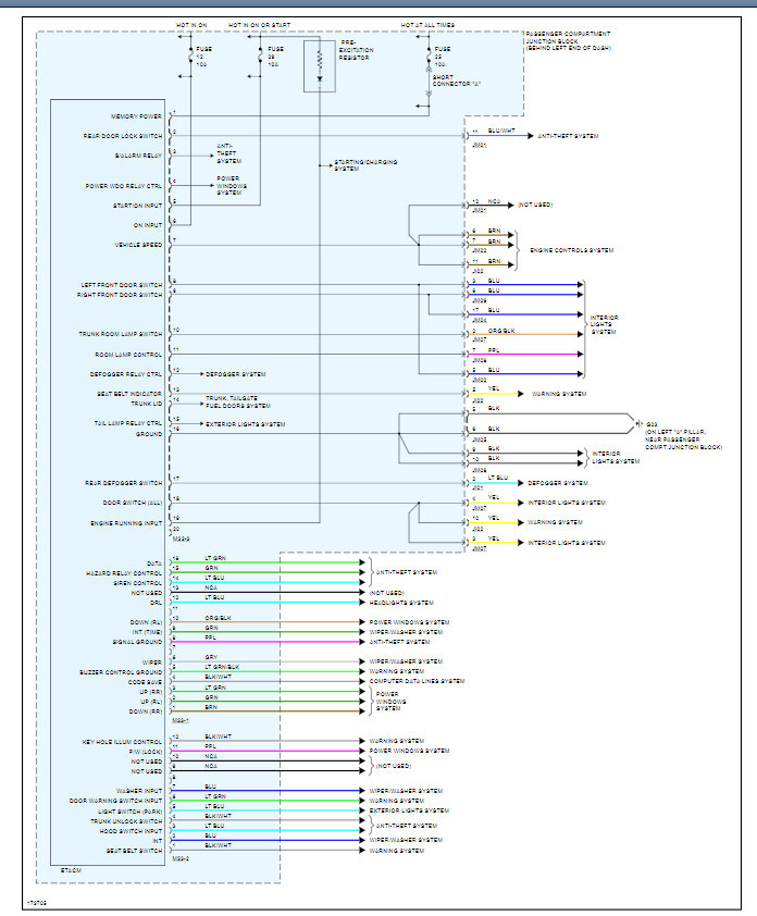

Can somebody please tell me where the body control module is located on my vehicle listed above?
Aug 5, 2020 at 9:12 AM
It appears you don't have a body control module but instead a passenger compartment junction block which is located behind the left side of the dash. I attached the wiring diagram for this component.
Was there a specific reason you are needing the BCM?

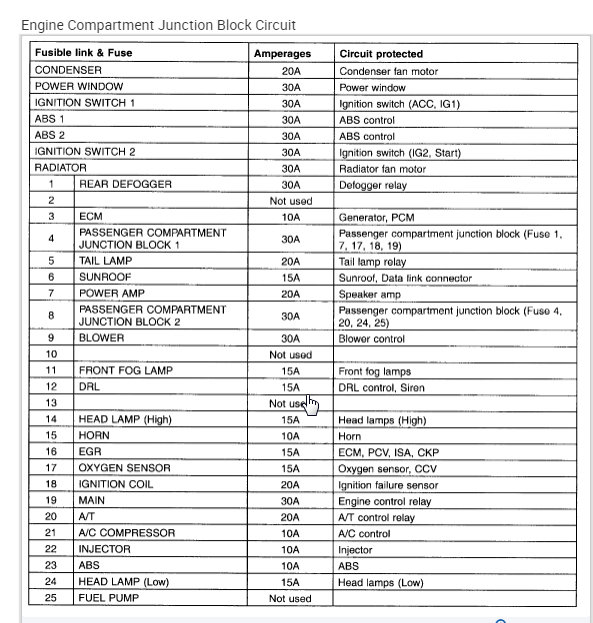

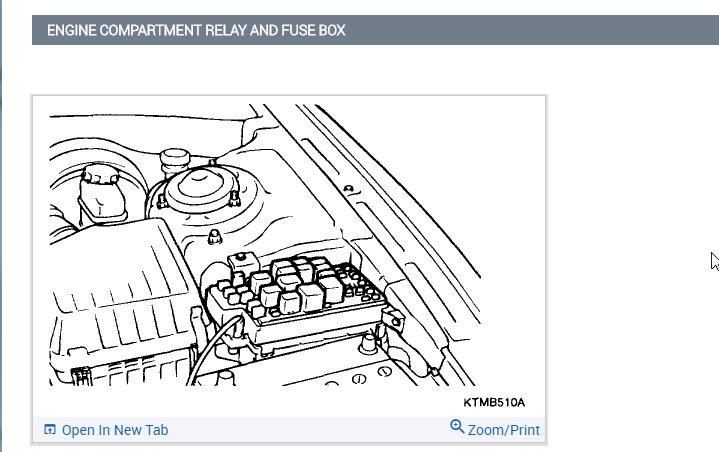

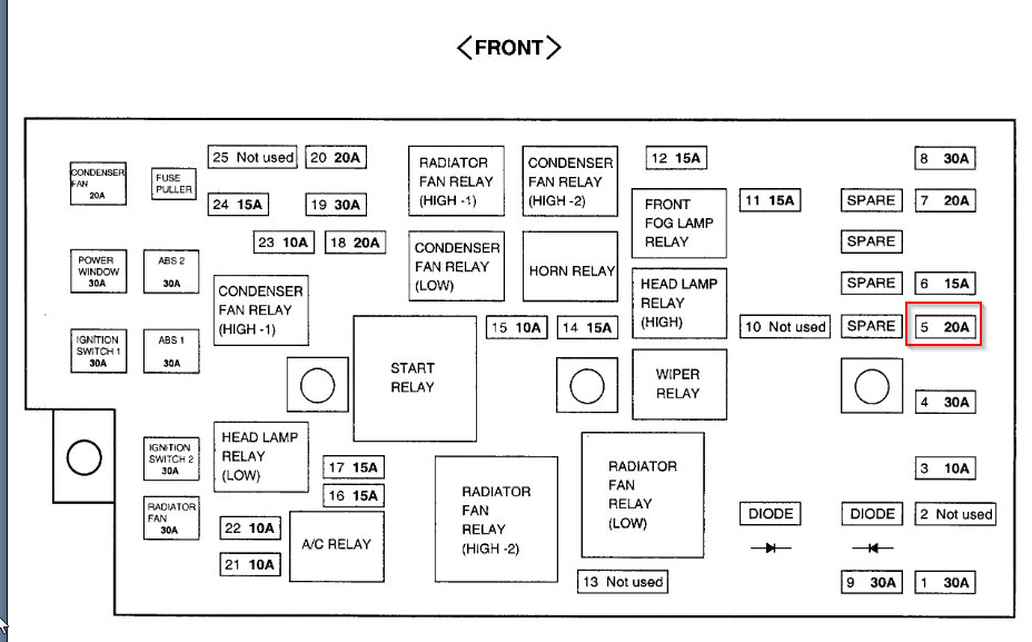

Set brake lights aren't working. I replaced the brake switch and I didn't fix it. I checked the fuses under the hood they are fine the under the dash fuse box has me confused because sometimes it'll have power at the fuse other times it won't. also when the brake lights don't work the controls don't work and hazard lights don't work, but when the brake lights to work I have see control in hazards. do you have any idea on what could be the cause?
Aug 6, 2020 at 2:51 AM
Just to be clear, you have power at times and sometimes you don't on the fuse shown in this diagram? If that is the case, then you have a wiring issue to the junction block or the junction block has an issue on the circuit board. Clearly it is unlikely to be a wiring issue to the junction block or all the fuses would be effected. If you have found intermittent power at this fuse, I would replace the fuse block.
