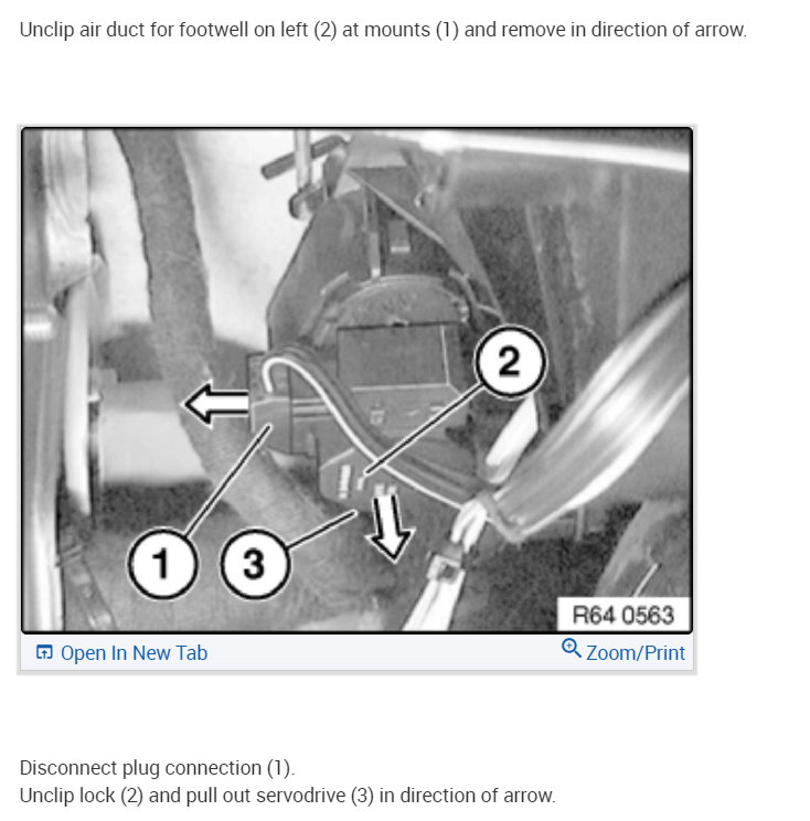

No cool or hot air comes out of the front vents but air comes out of the rear vent. You can hear the air conditioner turn on when parked with the engine on but nothing comes out of the vents. At high speeds on the freeway you can feel some cool or hot air out of the vents but you must put your hand to the vents. It’s like everything works but its not blowing it out.
I don’t know if there are separate blowers for front and back vents. If anyone can help me with this I would greatly appreciate this.
Jul 8, 2009 at 11:45 PM
DOCHAGERTY
  • 9,606 POSTS

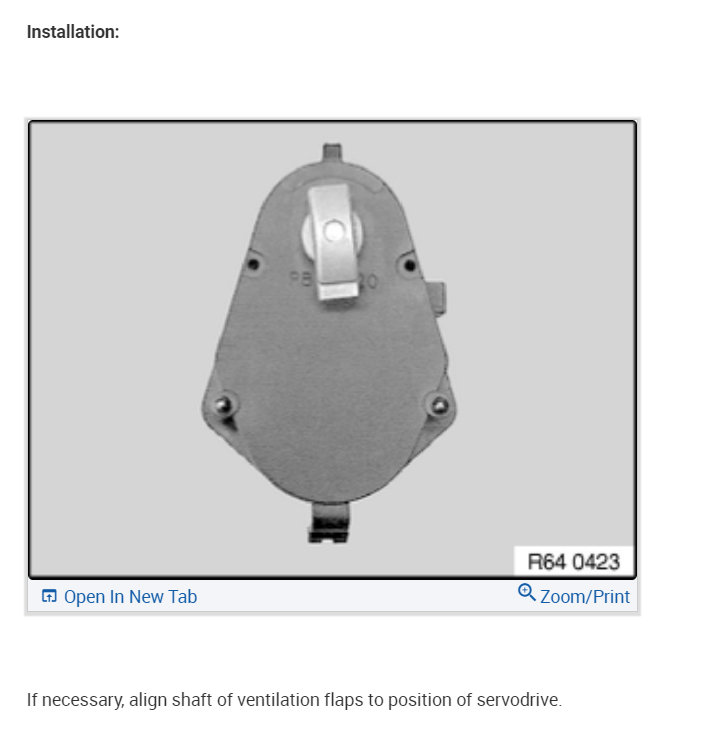

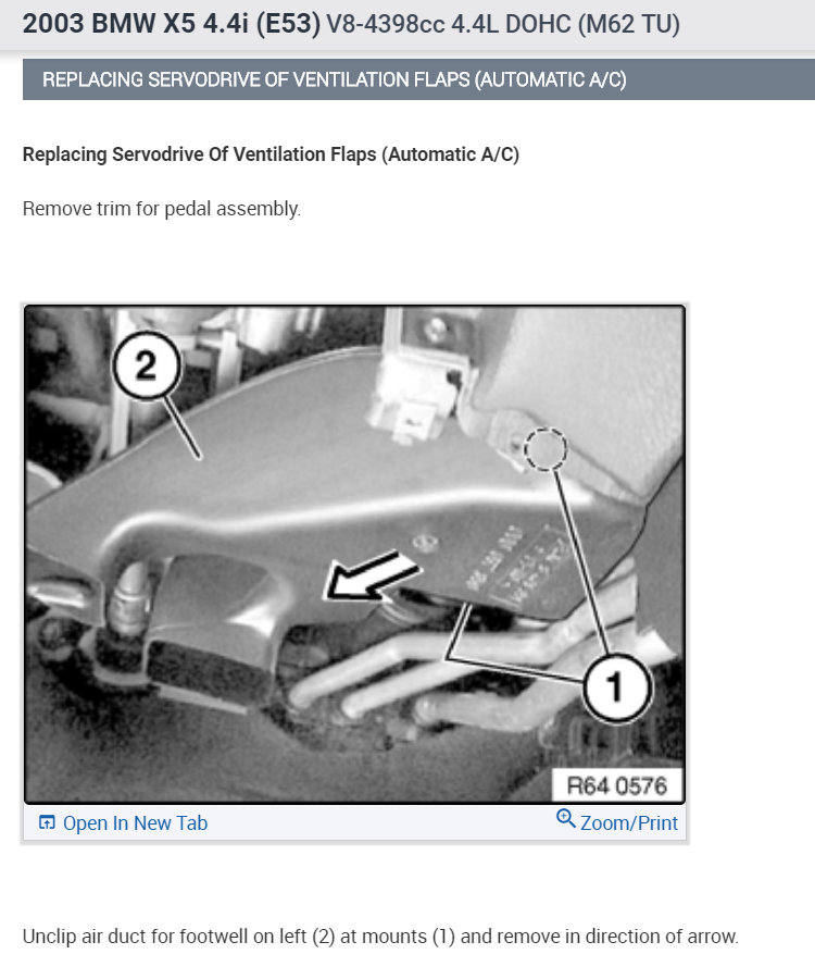

It sounds like the air flap servo motor is not working here are diagrams and instructions below on how to fix it. Check out the diagrams (Below). Please let us know what happens.
Jul 11, 2009 at 5:05 AM
5393ED
Thanks for this post I had this problem and had to get a new servo motor cost me $133.00 I love this site
