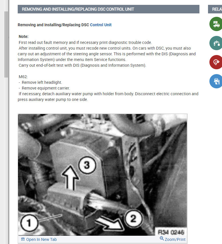

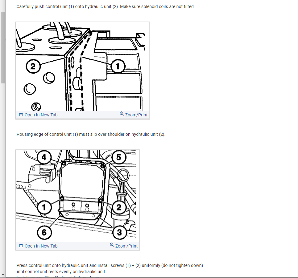

The DSC control module may have an internal fault and could require replacement.

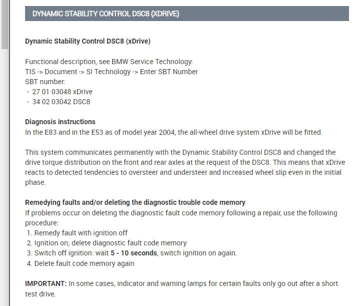

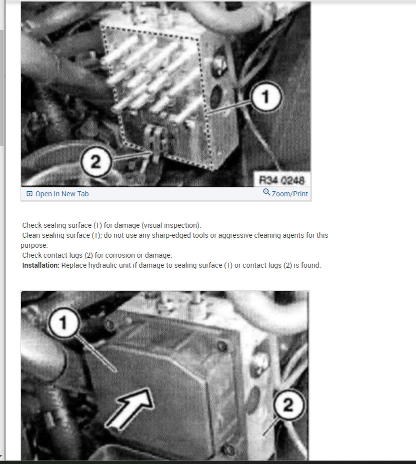

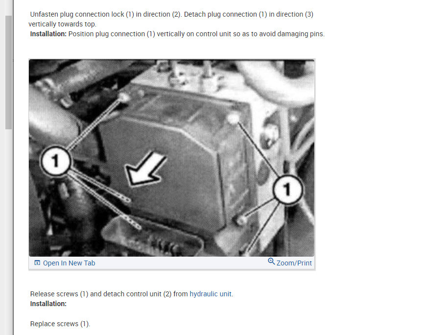

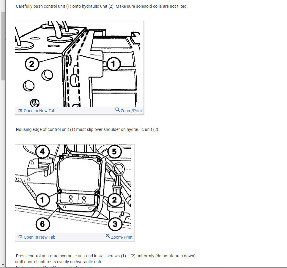

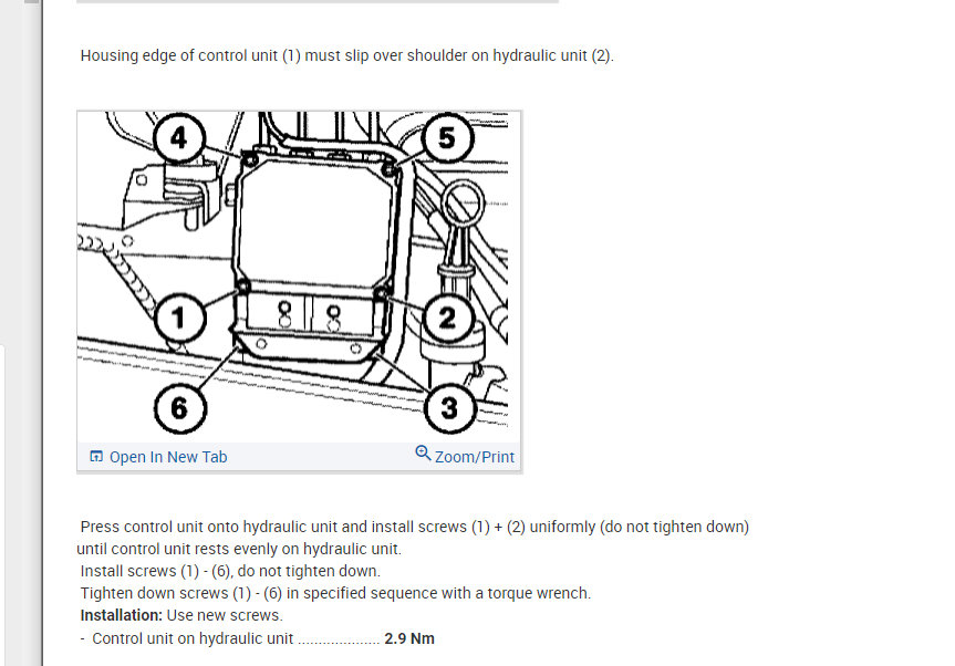

I assume you have some codes that would point to this as being the issue and if so, let us know what they are.
Here is a guide that will help with replacing a more traditional ABS module but this is basically what this is:
https://www.2carpros.com/articles/how-to-replace-a-abs-controller
I attached the info below from the manual so that you can review this and get this replaced.
Please let us know if you have other questions.
Thanks
