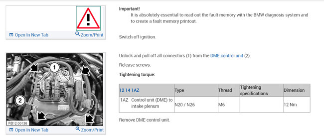

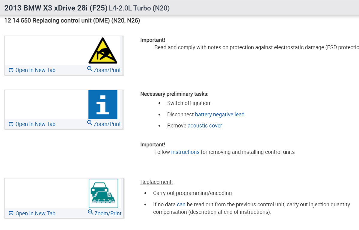

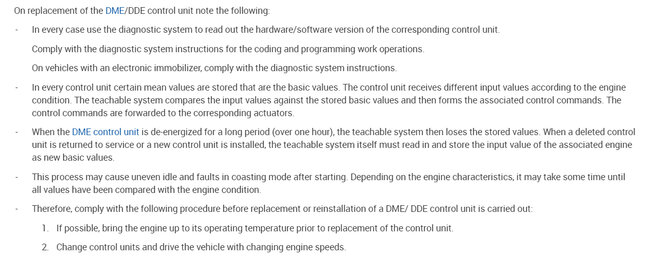

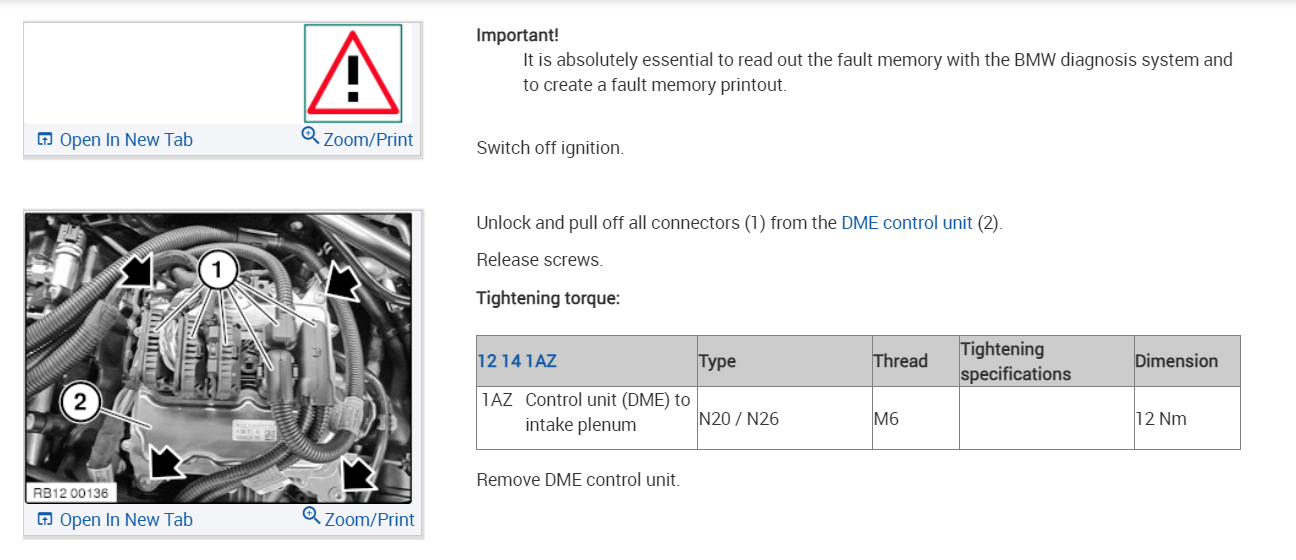

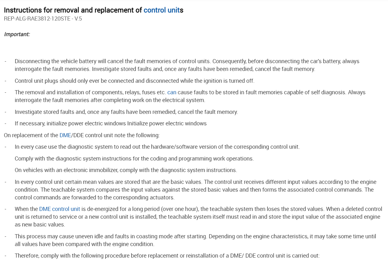

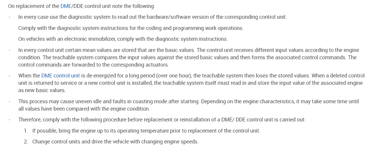

Can you do me a favor and clear the codes, then without starting the engine run the codes again to see what comes up? If the codes come back without running the engine the DME is bad or needs reprogramming. Here is the location of the DME and how to change it out. You can get a preprogrammed unit by searching Google or Ebay. Also did you check the camshaft position controls, you can get the connectors mixed up on this car, they do not have a specific connector for each like most cars.
Sep 11, 2023 at 6:25 AM
LARRYLARSON
  • 7 POSTS
Thank you for the information. It helped me eliminate one more possibility.

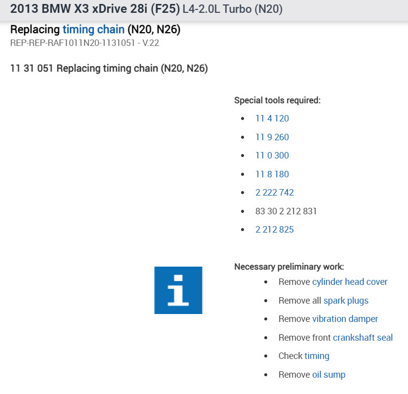

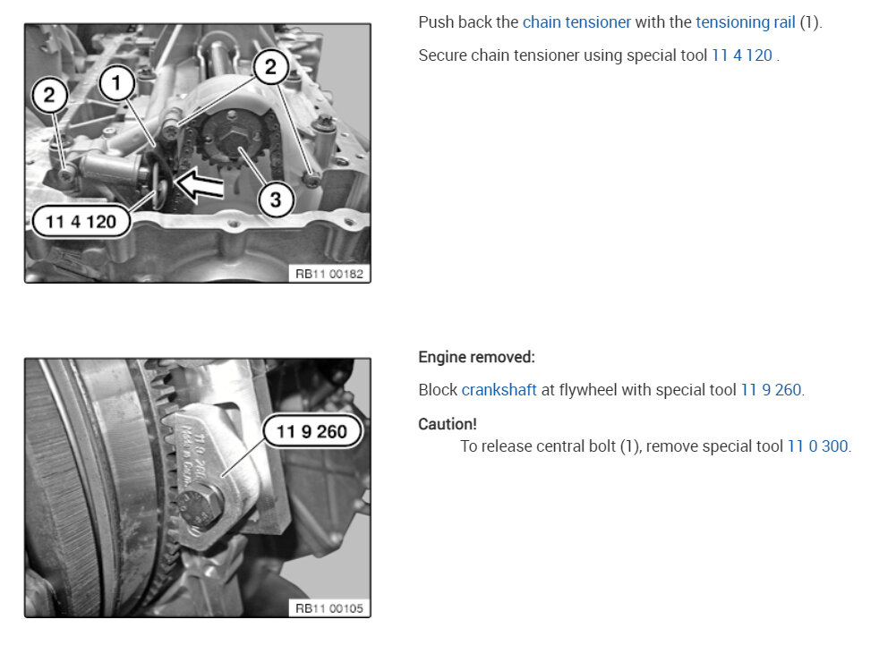

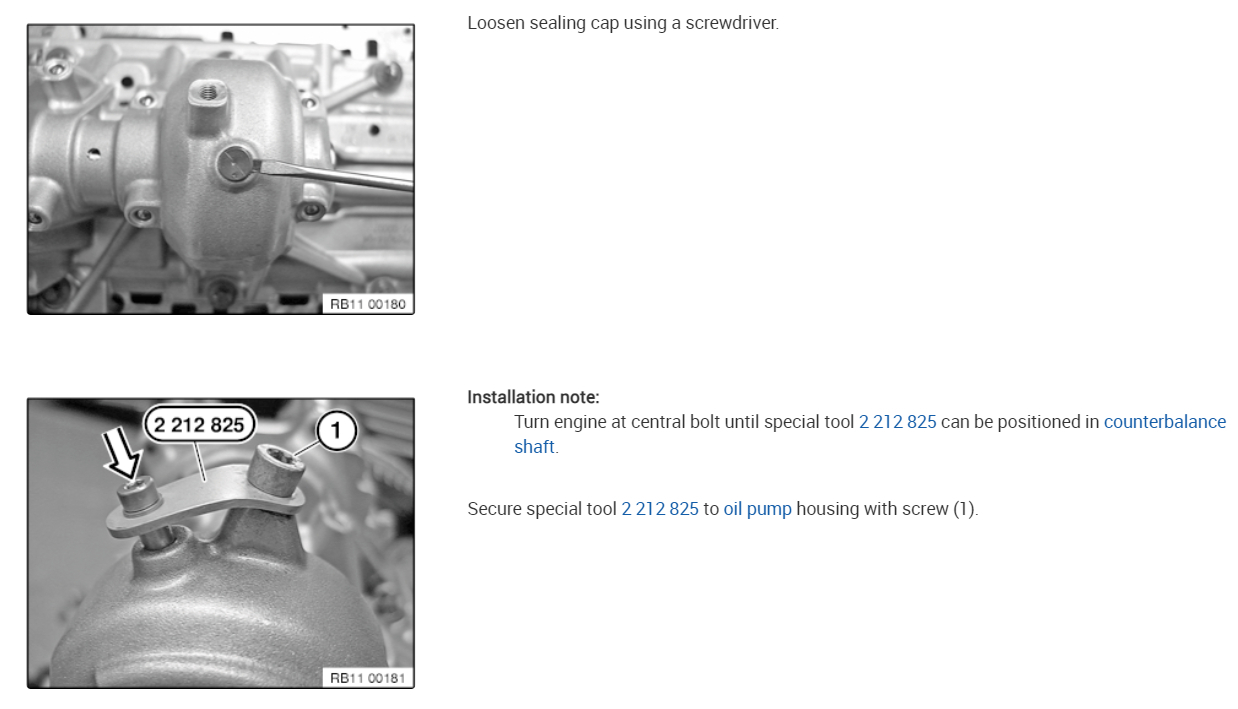

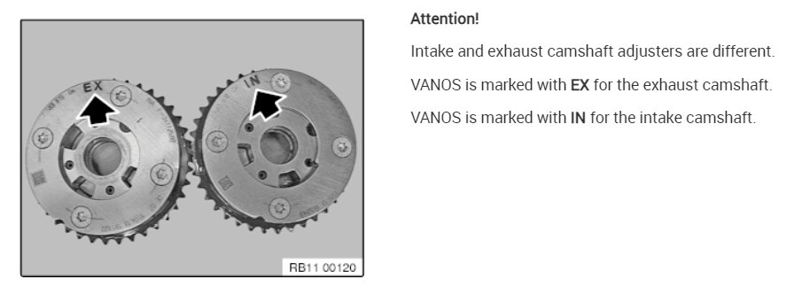

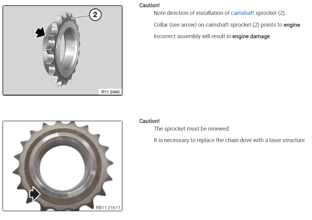

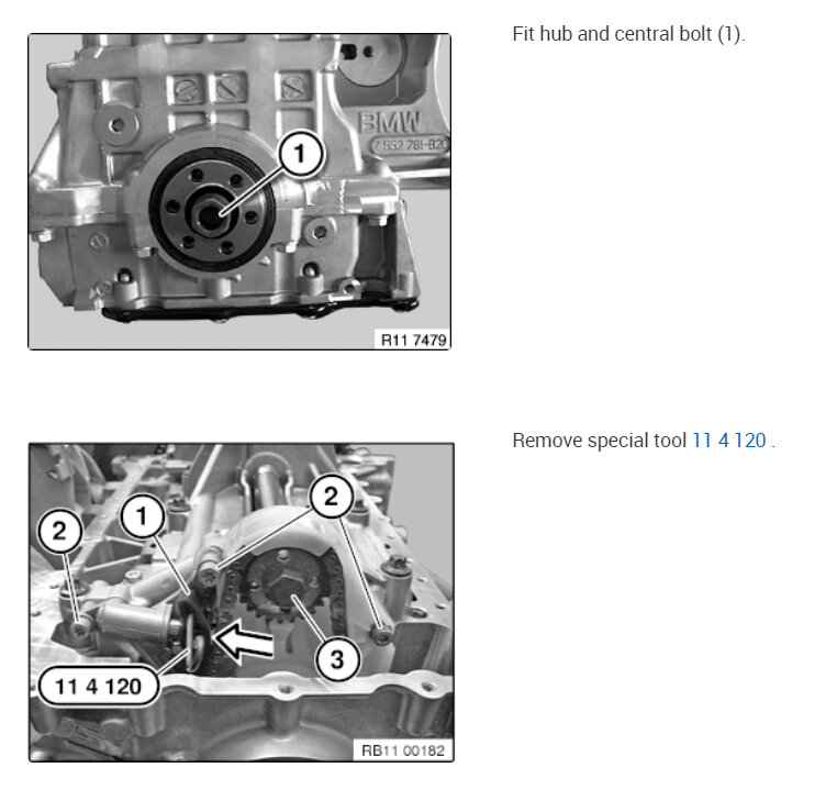

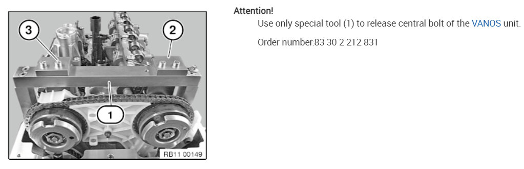

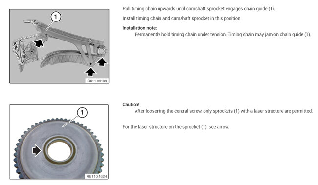

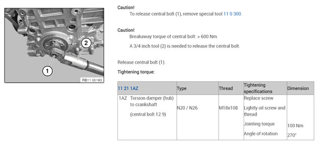

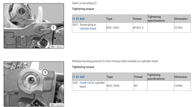

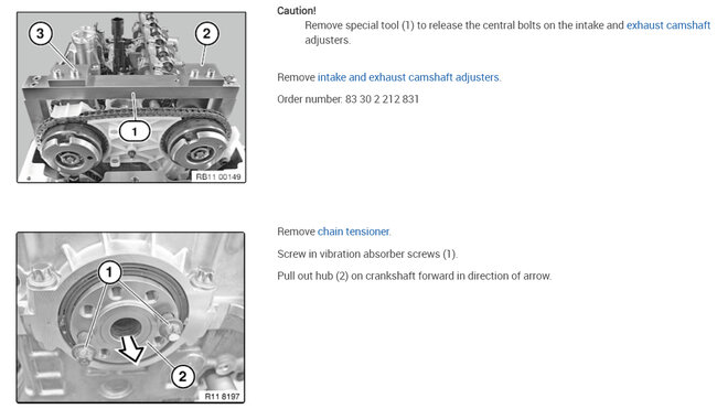

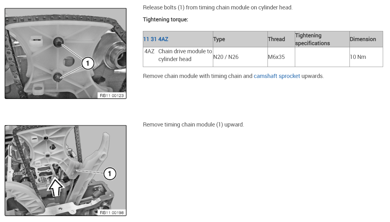

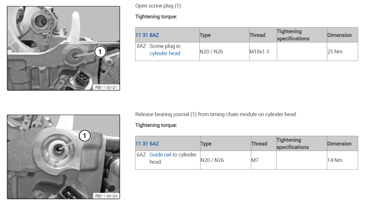

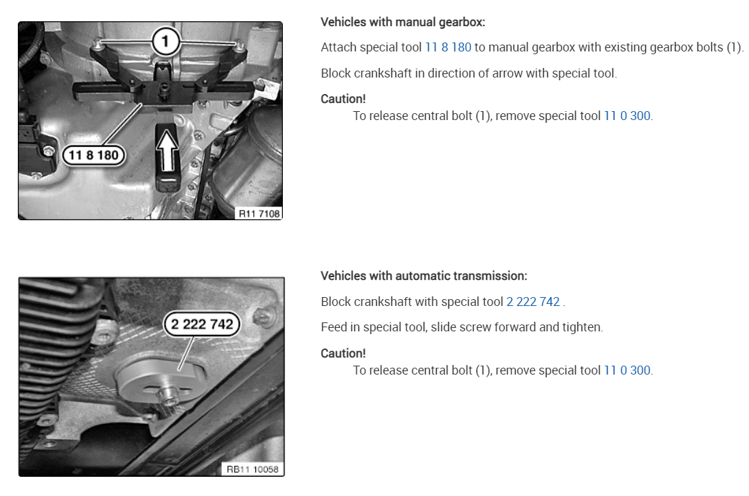

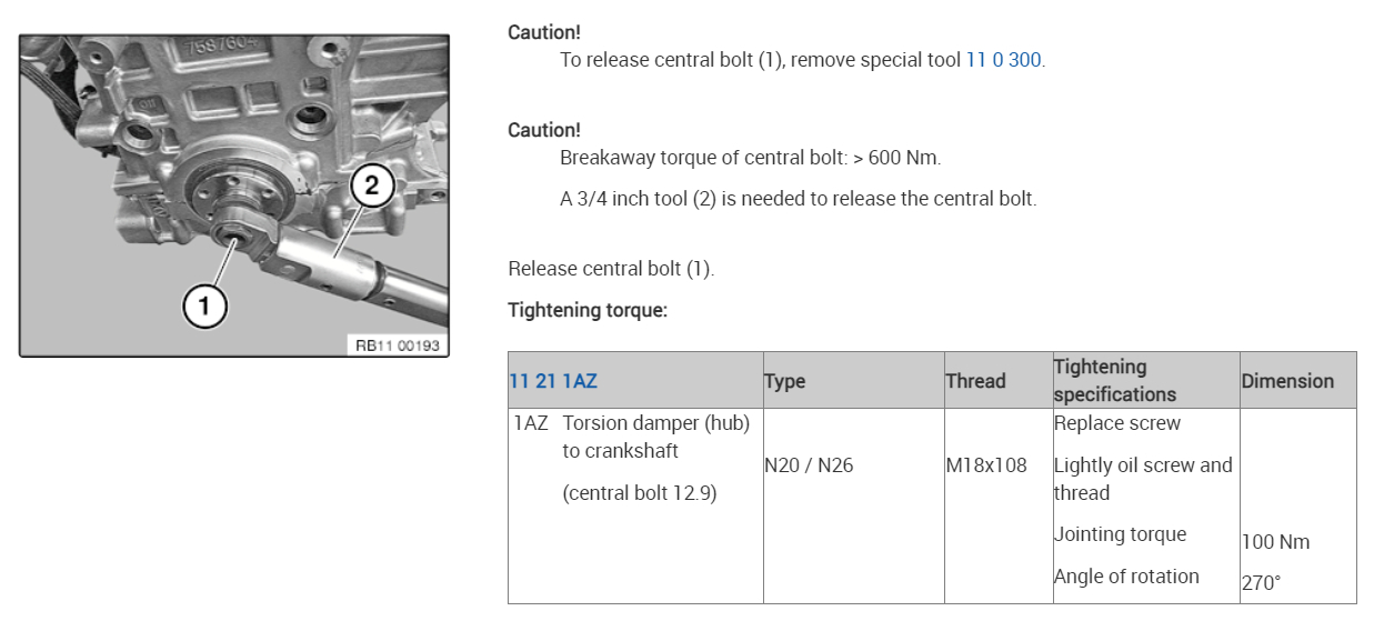

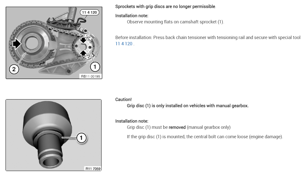

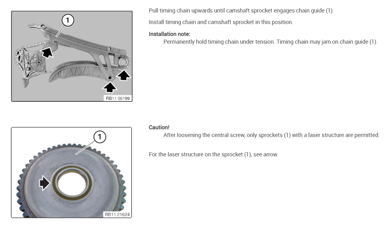

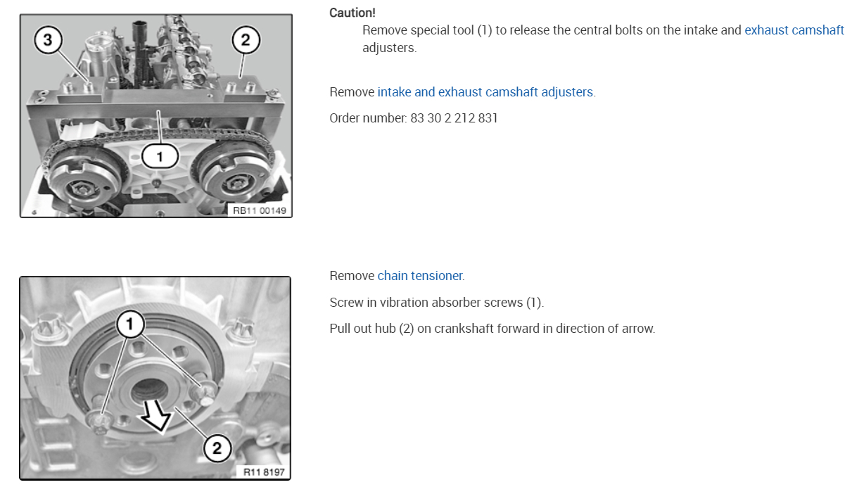

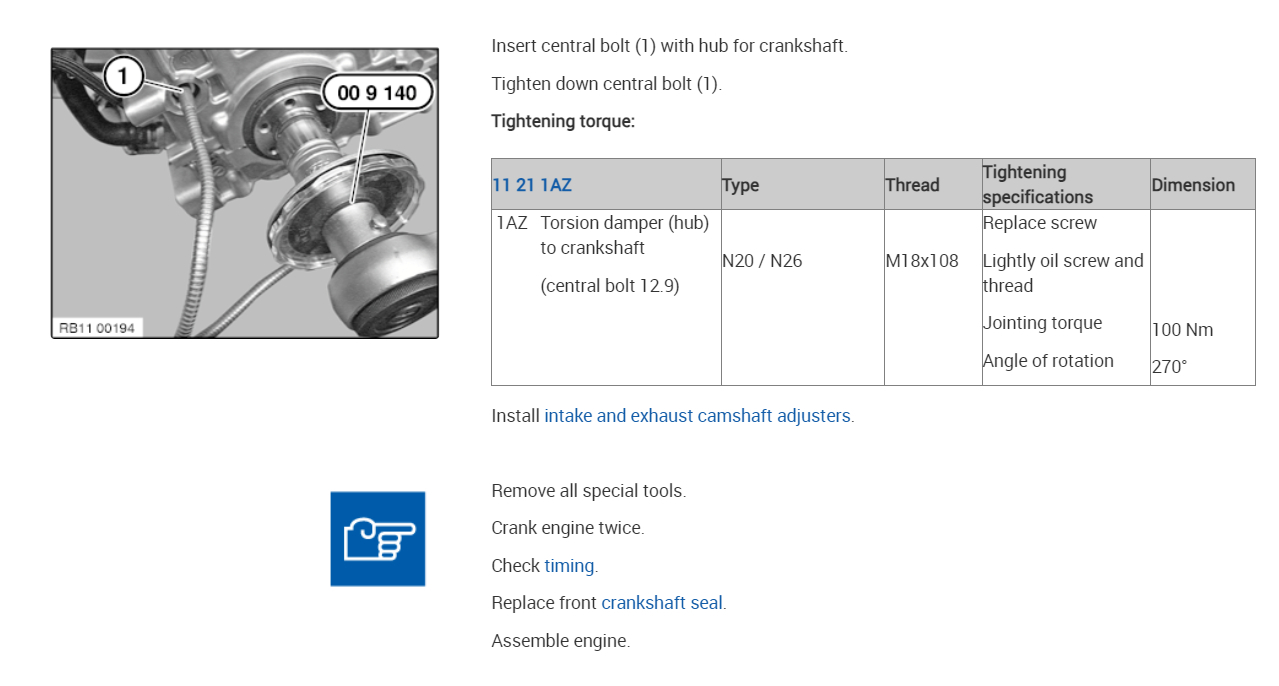

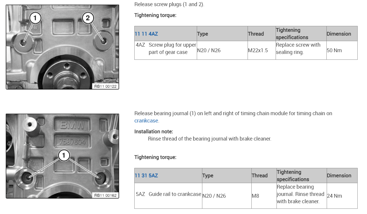

It sounds like the timing chain marks might be off, there are a handful of special tools to do the job, can you check the procedure below to confirm the installation? Also, the intake and exhaust Vanos are different and cannot be interchanged. Check out the images (below). Please let us know what you find.
Sep 14, 2023 at 3:26 AM
LARRYLARSON
  • 7 POSTS
I purchased the specialty tool set to install the timing chain kit. I was meticulous in the reassembly of the engine. I guess I don't understand why "deleting adaptations" would change the Dtc's. I have read of more than a few owners that have had the exact same thing occur to them. No one seems to know why this happens or a remedy for it.

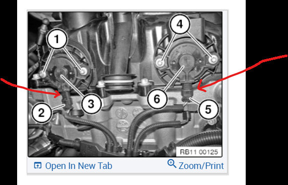

I am wondering if the engine has low oil pressure and not actuating the VANOS correctly. Also, I have seen the electrical connectors get mixed up from side to side for the actuators, I know you think they can't be mixed up, but they can. BMW does not have designated connectors like most car companies, try to switch them side to side.

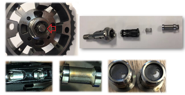

When you replaced the timing chain, chain guides and tensioner did you also replace the camshaft gears and center oil control valves?
The oil control valves (OCV) are built into the camshaft gear retainer bolts and are prone to sticking and possible metal mesh failures.
Issues with these could cause the camshaft installation issues with the engine running as the camshaft gears cannot adjust as commanded as the oil supply is insufficient.
The VANOS actuators push onto the pin (red arrow) in image.
You can remove the oil control valve inners by removing the circlip of either center bolt.
See a good video on VANOS actuator testing also showing the OCV:

I did not change the camshaft gears. I did, however, disassemble and clean the oil control valves. Using a 12-volt power supply I electrically actuated the VANOS with the following results: the intake side caused the engine to falter while the exhaust side caused the engine to falter and the die. I switched the wiring on the VANOS actuators, and it made no difference. I would appear to me that the actuators are not receiving the command to operate.
