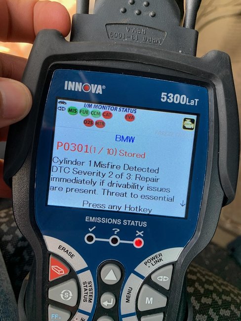

They gave him this code reading.

The code indicates a cylinder 1 misfire. Two things. First, that will cause a power loss and drivability issues. Second, if it has been that way for an extended time, it can damage the catalytic converter.
Has the misfire been repaired?
Let us know.
