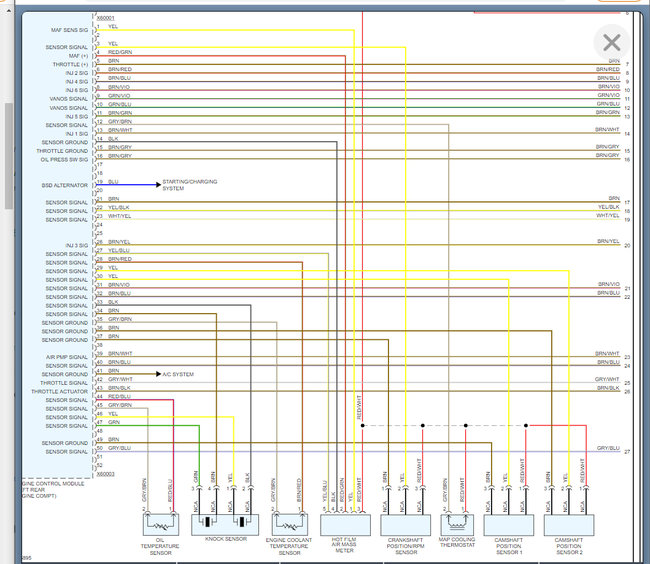

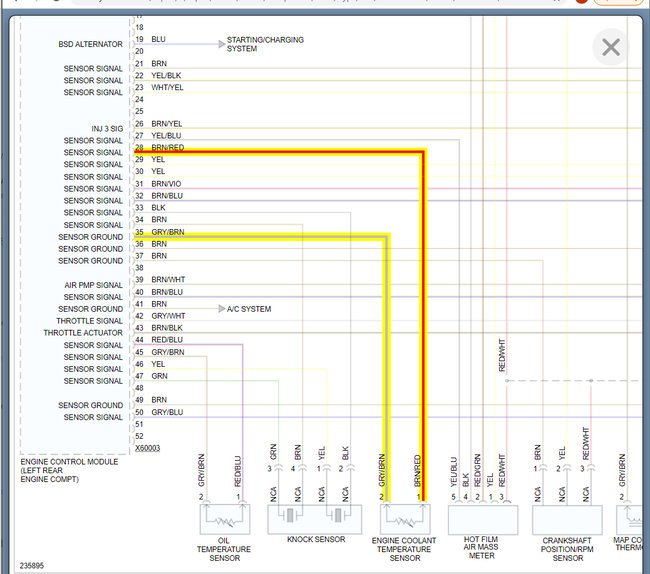

It doesn't sound like the engine is actually overheating. Since that is the case we most likely have an issue with the temp sensor or the ECM.
The way to test this is when the issue is acting up we need to monitor the temp that the sensor is telling the ECM with a scan tool.
Here is a scan tool that can do this. Basically any scan tool that can monitor live data will be able to do this.
https://www.youtube.com/watch?v=Mb7whGkD8vw
Please see the wiring diagram below for more info but I suspect if the temp sensor is reading correctly then the ECM is giving the incorrect data to the cluster.
Please let us know what you find and we can go from there. Thanks
