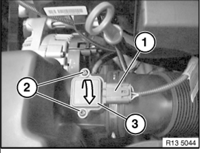

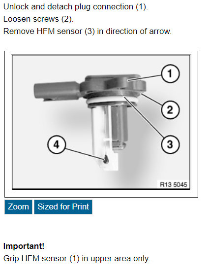

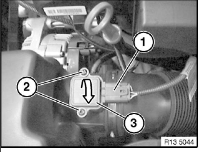

Yes, I have seen the MAF sensor cause this issue. What happens is the hot wire becomes contaminated which is normal for that many miles. When this happens the sensor is off which makes the engine lean but not enough to cause a check engine light. Here is a guide to help you see what you are in for and diagrams below that will help you see what it will be like on your car:
https://www.2carpros.com/articles/how-to-replace-a-mass-air-flow-sensor-maf
