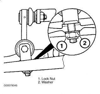

Hello - Here is the info you requested. CONTROL ARM Removal 1. Raise and support front of vehicle. Remove front wheel. 2. Disconnect stabilizer bar link from control arm. Release nut (1). See Fig. 9 .

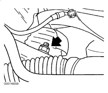

3. Install one wheel lug bolt and install a piece of wire from lug bolt to coil spring to prevent brake hose damage. See Fig. 17 .

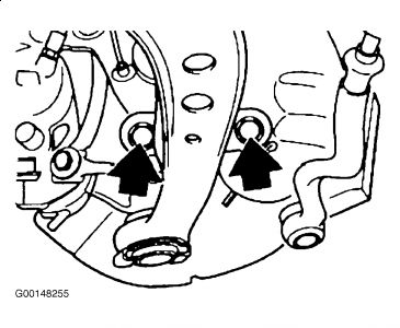

5. Remove 2 strut-to-steering knuckle bolts and discard. See Fig. 19 .

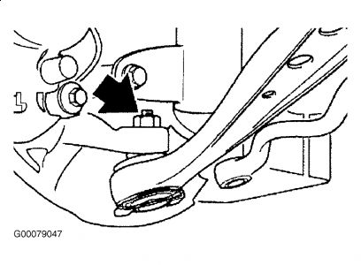

6. Remove upper strut-to-steering knuckle bolt and lock nut. Remove control arm-to-steering knuckle ball joint nut and discard. See Fig. 20 .

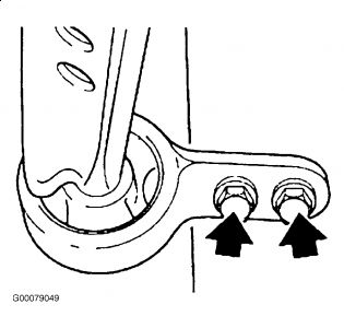

8. Remove tie-rod from control arm and suspend tie-rod aside. Remove control arm bracket-to-subframe bolts. See Fig. 32 .
https://images.2carpros.com/forum/automotive_pictures/248015_32_4.jpg
9. Unscrew nut and knock ball joint loose with a plastic hammer. Remove control arm. See Fig. 22 .

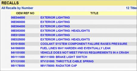

Hello - Also, it looks like you may have some recalls on your vehicle. The dealer may fix these for free. Please contact the dealer service department, give them the VIN number of your car and have them check on these to see if they apply to you.
