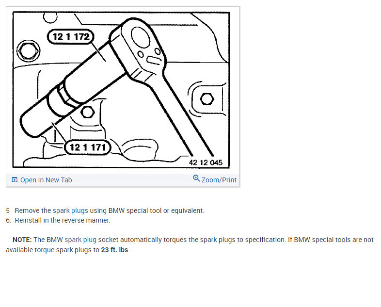

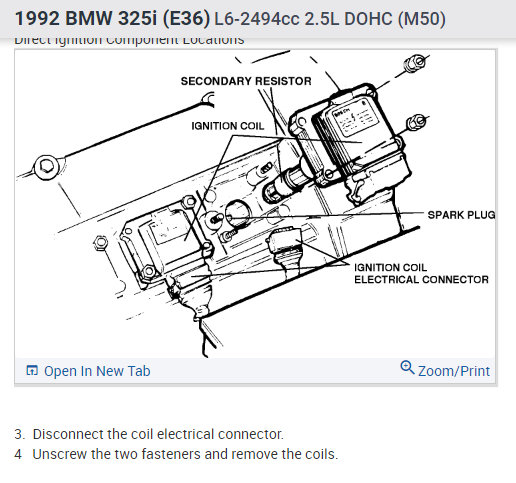

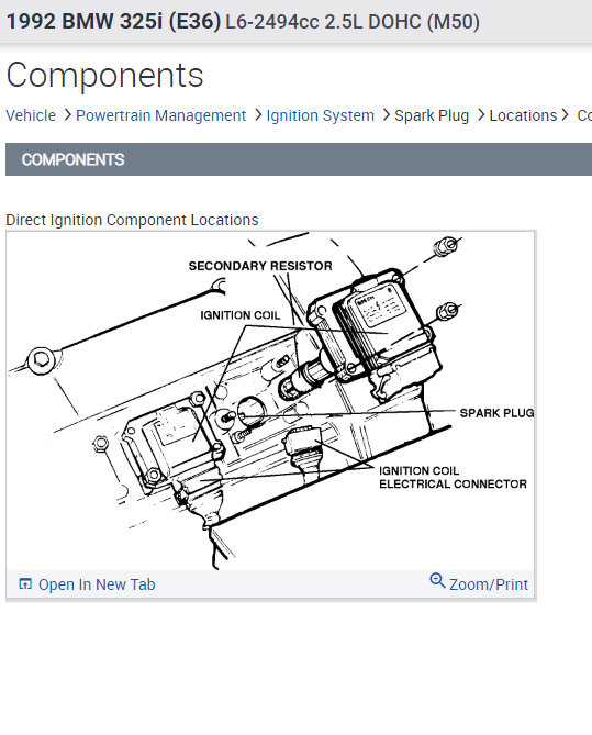

Check the plugs and coils and verify you have spark. If it has not been done do a basic tune up.
https://www.2carpros.com/articles/how-to-tune-up-a-car-engine
