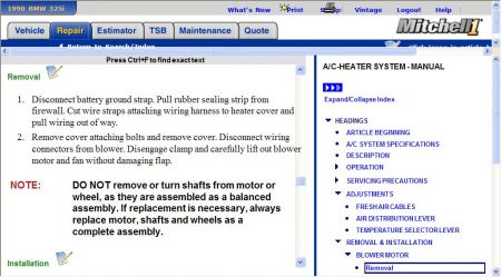

Can I access the blower motor from the engine compartment or do I have to go through the dash?

If its a manual AC/Heater system see below

The E-30 blower fan is accessed through the engine compartment. Also replace the resistor pack while you are in there.
