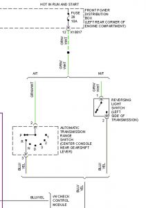

my brake light problem is when the car is in park and I push on the brake the brake lights work when I put the car in drive or reverse and apply the brakes the lights do not work. I have replaced all of the bulbs and still the same problem???? It is a 1994 BMW 320i with 78,000 miles/ 4 door

Sounds like a problem that may be in this area. First check the fuse on this circuit, then check for power coming out of the which ever switch (transmision) you have.
https://images.2carpros.com/forum/automotive_pictures/30961_beem_1.jpg
https://images.2carpros.com/forum/automotive_pictures/30961_mitchel_5.jpg
I should also mention that this is for a Canadian 325i as I have no listing for a 320i.
