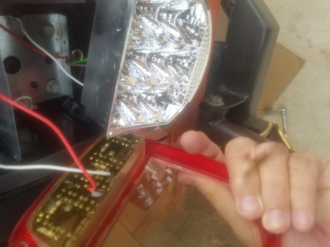

Blowing brake fuse every time I activate the brake. Running lights work fine, but also do
not have turn signals. I have installed a new brake switch and turn signal actuator.

I have disconnected the rear taillights (at the main connector under dash) touched brake and blew the fuse.
I next disconnected the steering column connector and reconnected the rear lights. Touched the brake and no brake light, but the fuse remained good.
When I reconnect the steering column and touch the brake, the fuse blows.
I even replaced the turn signal actuator with attached wires and it still blows the fuse. Frustrating.
The Jeep has no trailer pigtail.
The connector attached to the brake switch at the peddle there are two wires, one dark red with a black line shows 12 volts, the other wire, a lighter red has nothing when the column connector is disconnected. When I reconnect the column wires the same lighter red wire shows that its grounded. Is this supposed to be?

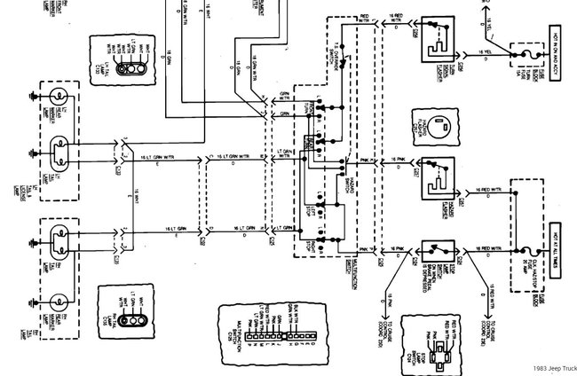

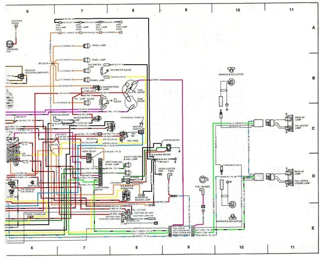

The attached shows the brake lamp circuit. The pink wire should not show a ground. It feeds the multi-function and hazard switches. Remove the brake bulbs then see if the short is gone if not (I suspect it will still be there) turn the signal switch to left and right does the short go away in either or both positions? If it is gone to one side, the other side has the short. If it does not go away it is something in the hazard circuit.

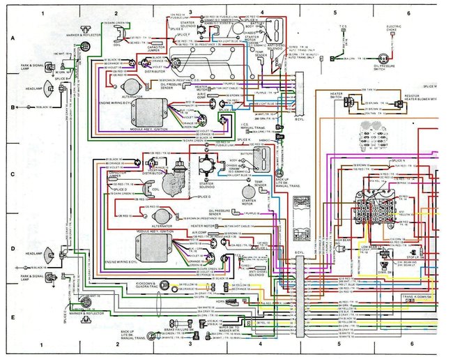

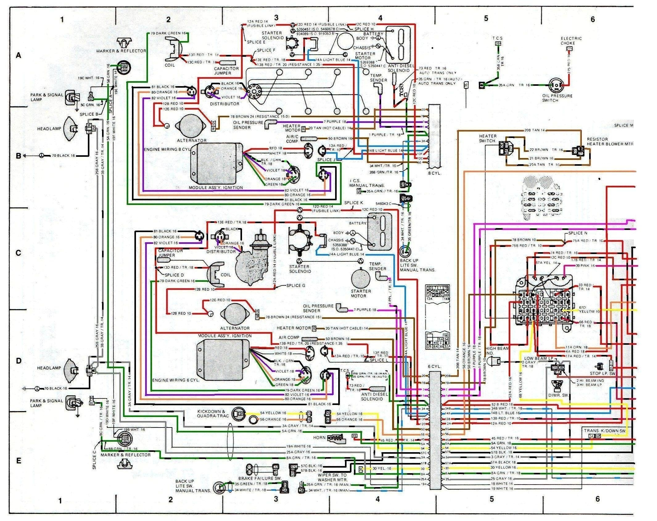

I have the 1979 AMC diagram that I colored the wires, I will remove the lighting from the overall diagram to make it easier to read if you like.
Thanks for assisting STEVE W.!
The Medic
Nov 1, 2018 at 9:51 AM
CJ MEDEVAC
  • 11,004 POSTS

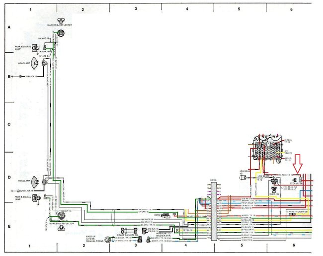

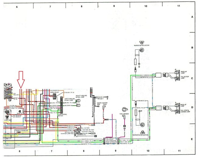

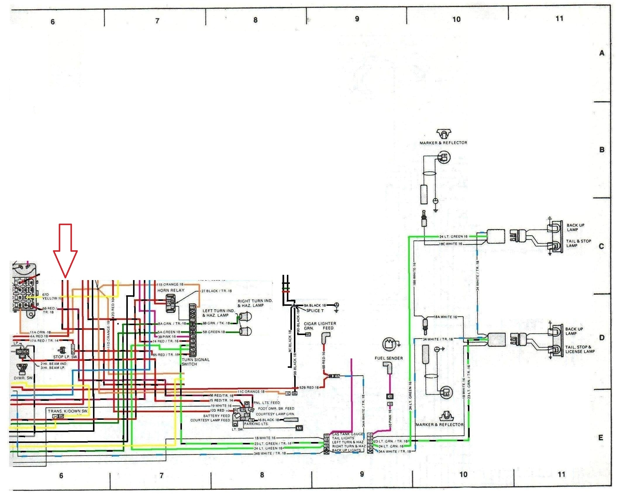

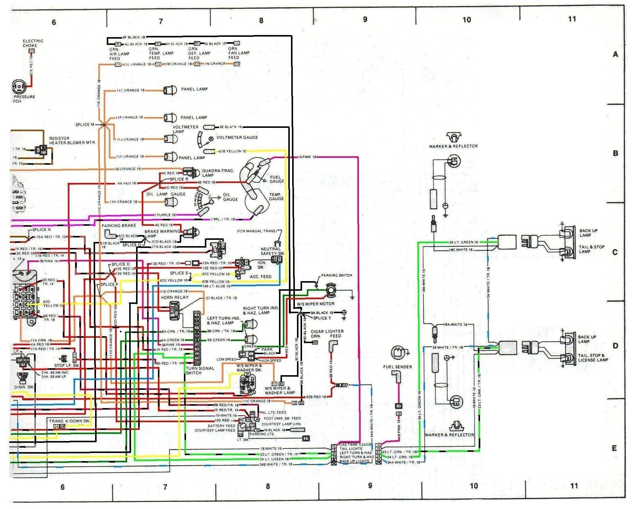

Okay, four diagrams-I colored them years back.
White wires are shown "black" (Duh)
Tracer stripe colors were not provided on the diagram.
So I colored the wires (base color which was shown) and I "dotted line" in black or blue for the ones with tracers (it does make it a bit easier to identify them)
(I had no choice as I was not going to tear every tracered wire out of my Jeep to see what color it was!)
Some "tight spots" you really have to look where the wire goes. The wire writing on the wire might confuse you.
This is a 1979 diagram, the lighting portion is probably the same, this year did not have a computer.(which was a good thing!)
Below are the full diagram (left and right) and the lighting part I tore out of the full diagram (left and right)
The diagrams overlap-I "red arrowed" about where the stop light switch is located.
The Medic
