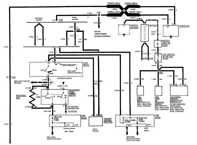

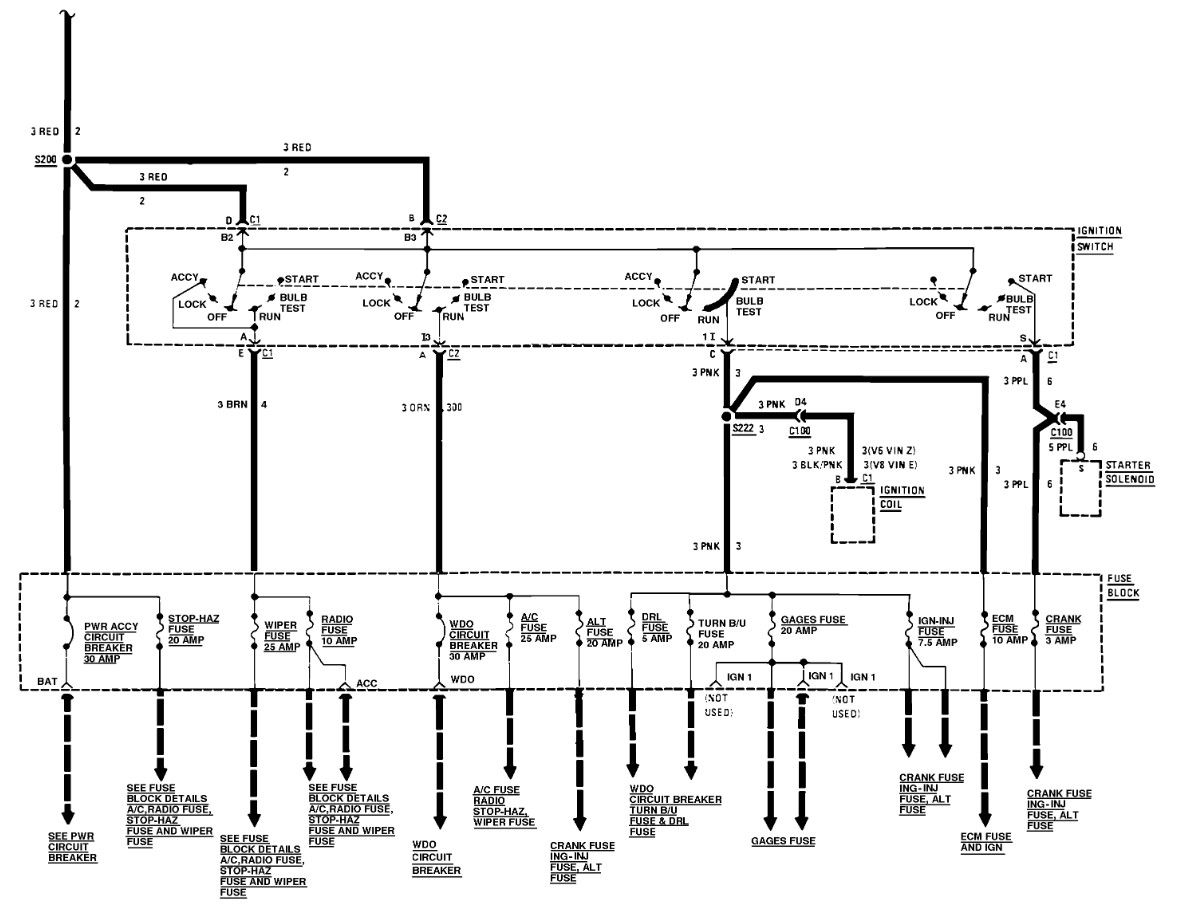

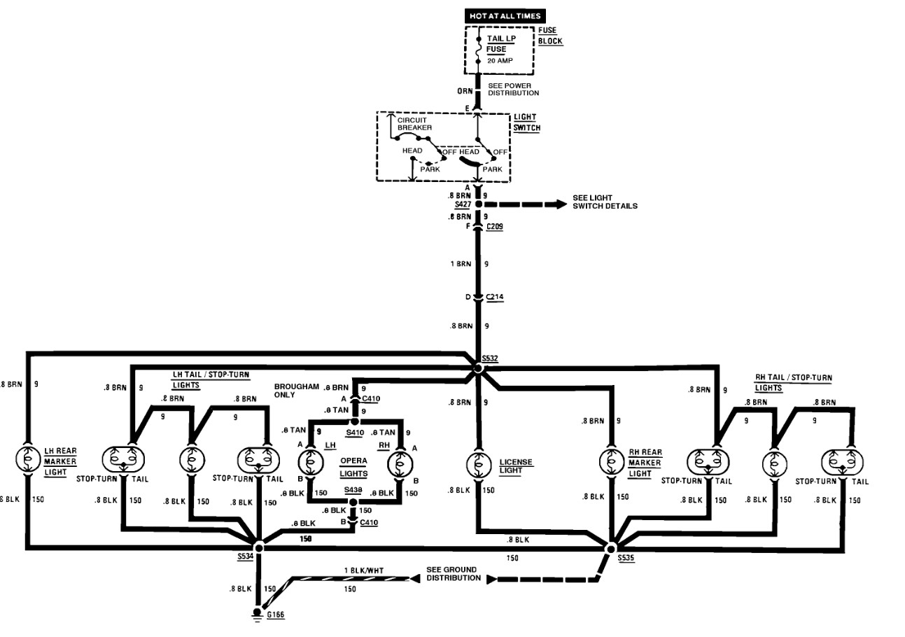

I was driving down the road and the cluster fuse blew. Came home, tried replacing it and as soon as the key was turned on it blew again. After doing a little wiring looking the taillight fuse blew as well. Now I replaced both fuses and only the cluster fuse keeps blowing. I noticed that the blinker indicators are lit up on the dash with the taillight fuse in now if I remove the taillight fuse the cluster loses power keep in mind that the cluster fuse is blown at this point and removed as well. Where would be a good place to start looking into my issue?

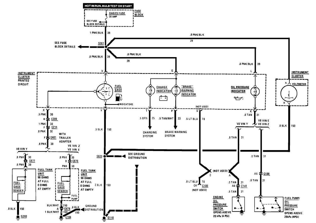

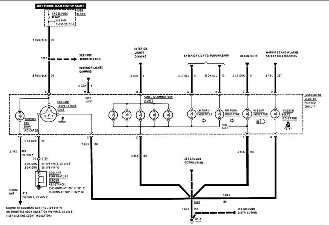

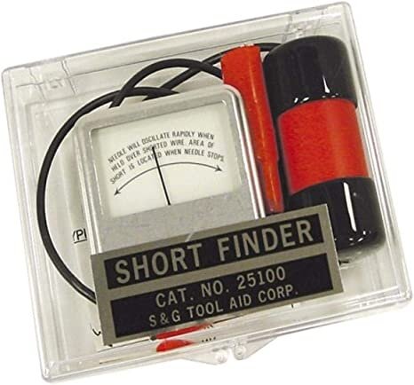

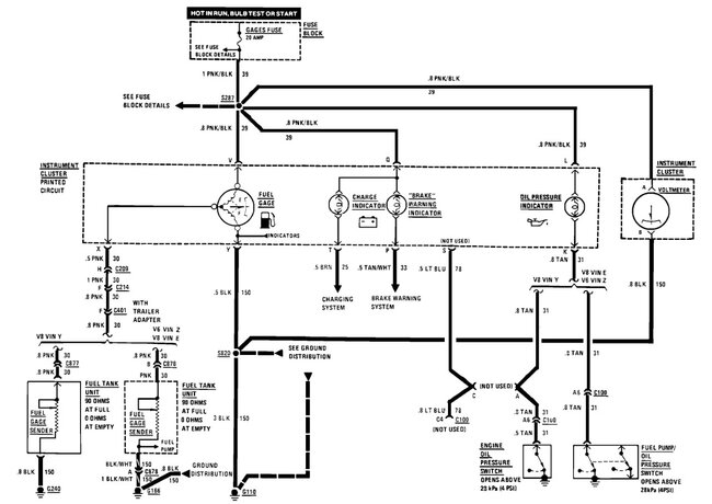

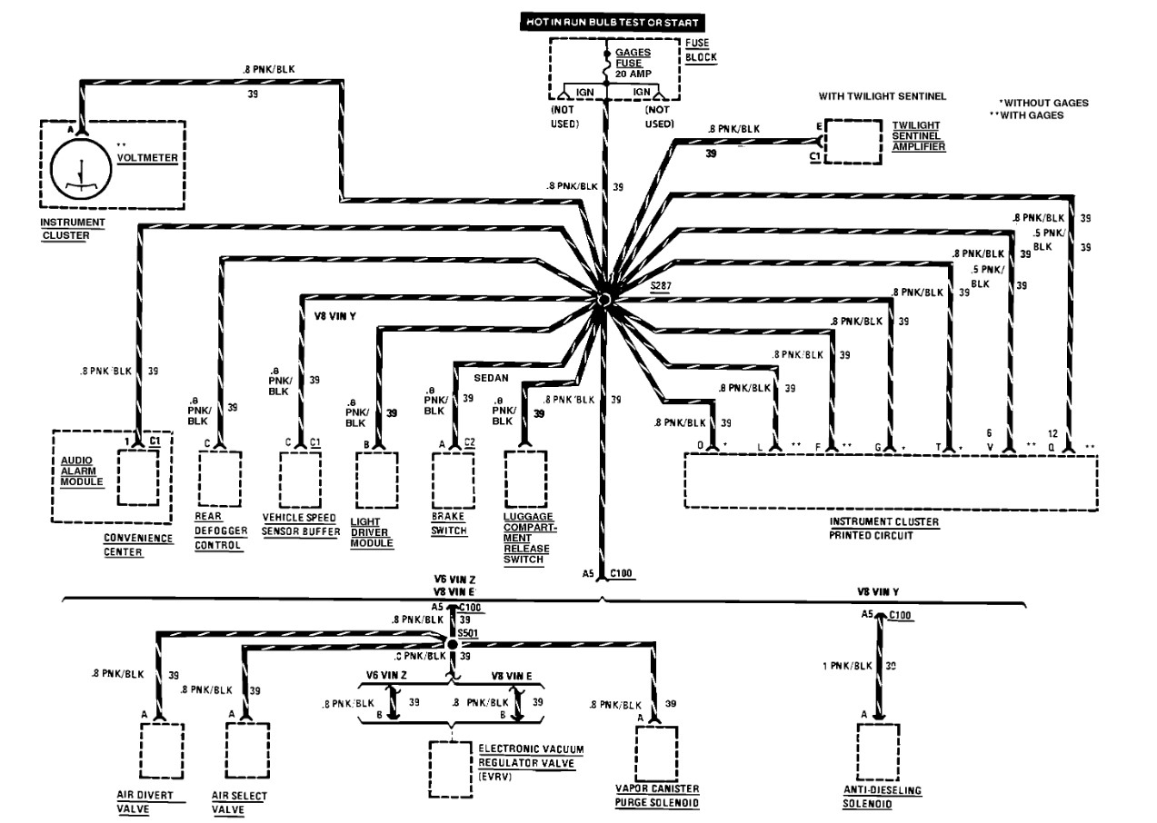

The fuses in that car power multiple circuits other than just the gauges. Your description sort of sounds like the tail fuse is back feeding power into the gauge cluster. That would explain the dash getting power when you put the fuse in. It sounds like you have a short in the gauge circuit. The problem is that finding that short is going to take some work. To start you will need something like a short finder like this one:
https://www.youtube.com/watch?v=TZrCrBx4uFY

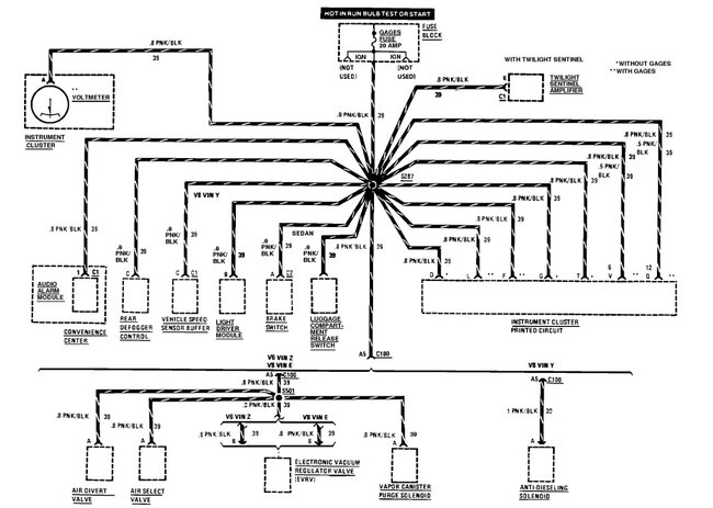

Then you will probably need to locate splice 287 above the fuse block on the left side of the dash and test each branch circuit from it to find the one with the short They are all the same Pink with black stripe. Then to verify it you would then cut the wire and install a fuse. Then follow that wires circuit to its load and repair the problem. Attached are the relevant wiring diagrams.

What I would do is to find the splice, then go to the component listed as being fed from it. Like say the brake light switch, unplug it, does the short go away? Then go to the cluster itself, unplug it, check again. If you buy the short finder I added, inside it is nothing more than a self-resetting circuit breaker, you can change that piece out for different ones by just buying a different breaker in the parts store. I have made a few of them with different ratings and painted the PVC tube with the color of the fuse. If you hit Amazon with Auto-Reset Mini ATM Circuit Breaker, you will see the type I used. You can also use the stud versions the parts stores sell. It will likely take a bit to find because unlike more modern cars they fed a lot off of the single fuse.

I found the short was out under the hood at the blower motor relay.
