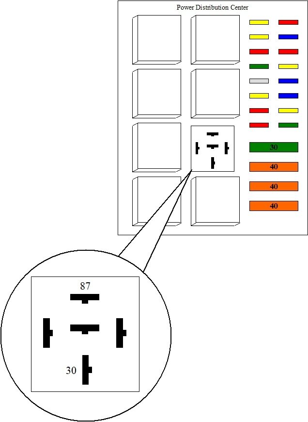

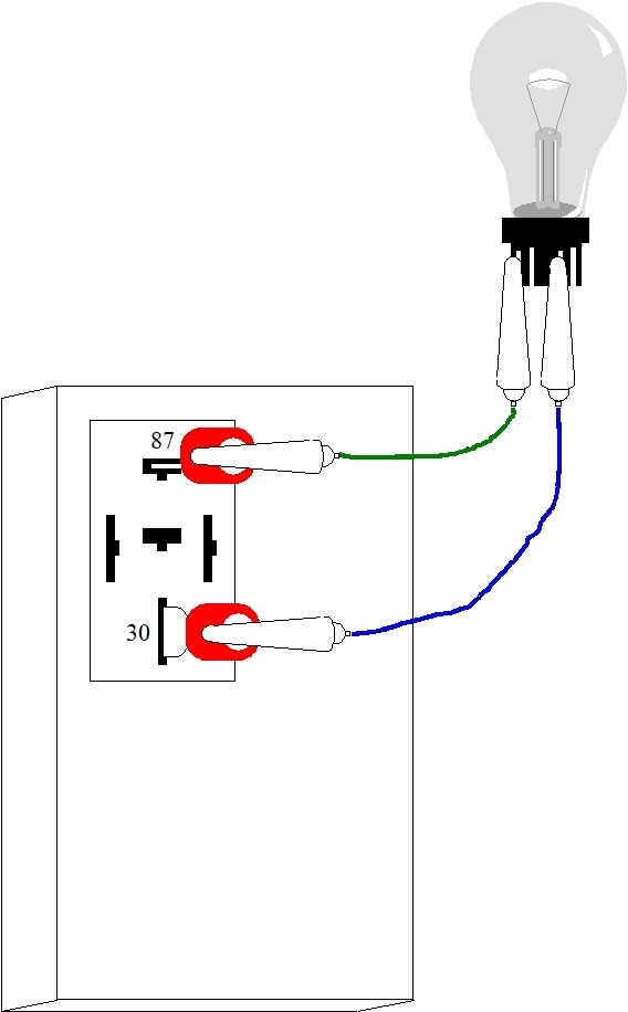

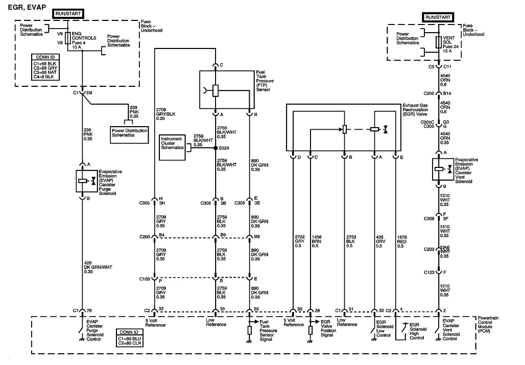

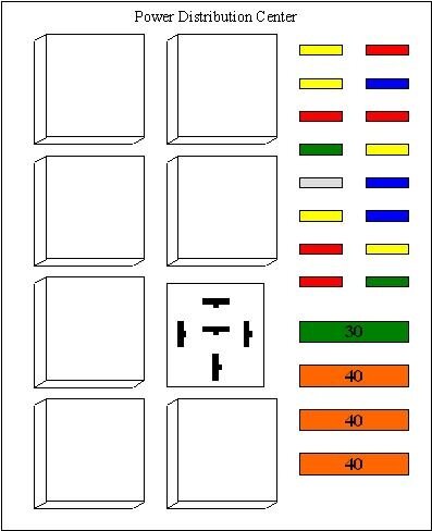

Here's a trick that will help so I don't need to buy stock in the fuse manufacturer's company. Plug in a 12-volt light bulb in place of the fuse. When the short is present, the bulb will be full brightness and hot, so be careful what it's laying against, but it will limit current to a safe, roughly one amp. When you do something to remove the short, the bulb will go out or dim. In this case it will likely go dim as current will be flowing through the fuel pump.

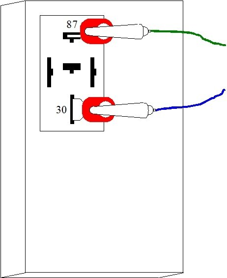

The problem with this is that circuit only gets turned on for one second when you turn on the ignition switch, then not again until the engine starts to rotate. It isn't practical to keep cranking the engine during the diagnosis. A better solution is to install a good fuse, then remove the fuel pump relay and jump that with the light bulb. The ignition switch doesn't even have to be on.

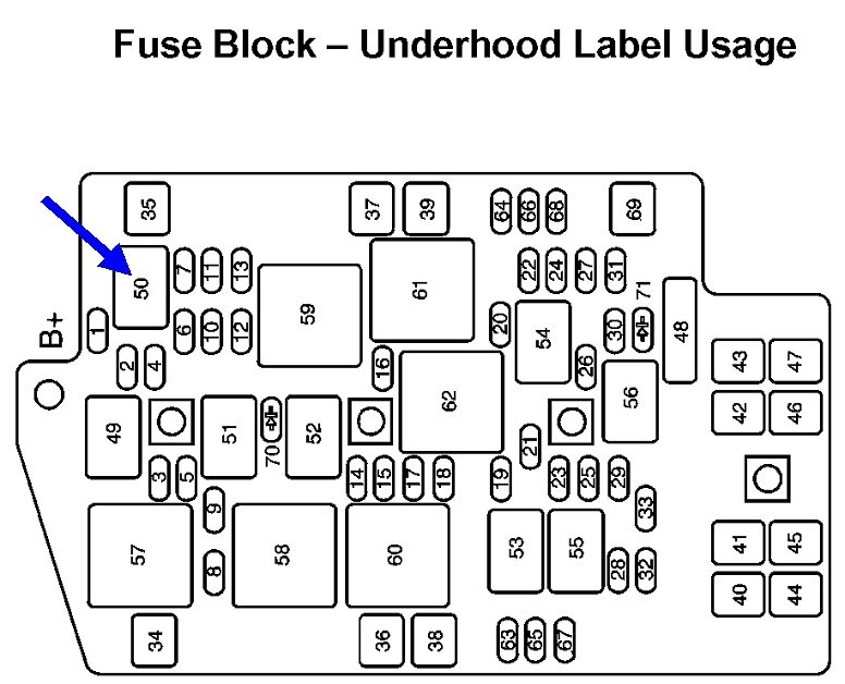

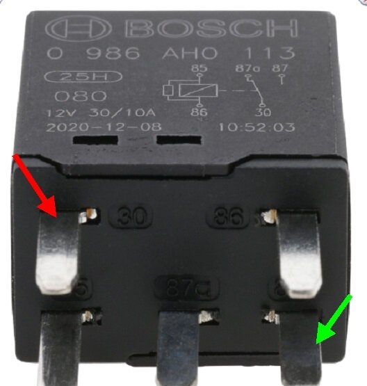

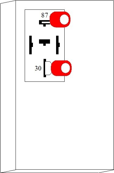

This first drawing shows the location of the fuel pump relay. There's no drawing for the terminal layout, so I added two arrows to a photo of the relay's terminals. The bulb must be connected to the two corresponding terminals in the relay's socket. The next drawings are a simplified description of the procedure. The orientation of the terminals is different, but the numbers are the same. We need # 30 and # 87. A 3057 brake light bulb works well for this.
Expect the bulb to turn on full brightness when you make the last connection. Now you can unplug connectors and wiggle wiring harnesses around to see what makes the bulb go out or dim.
Let me know if you find the cause or if I need to clarify the procedure.

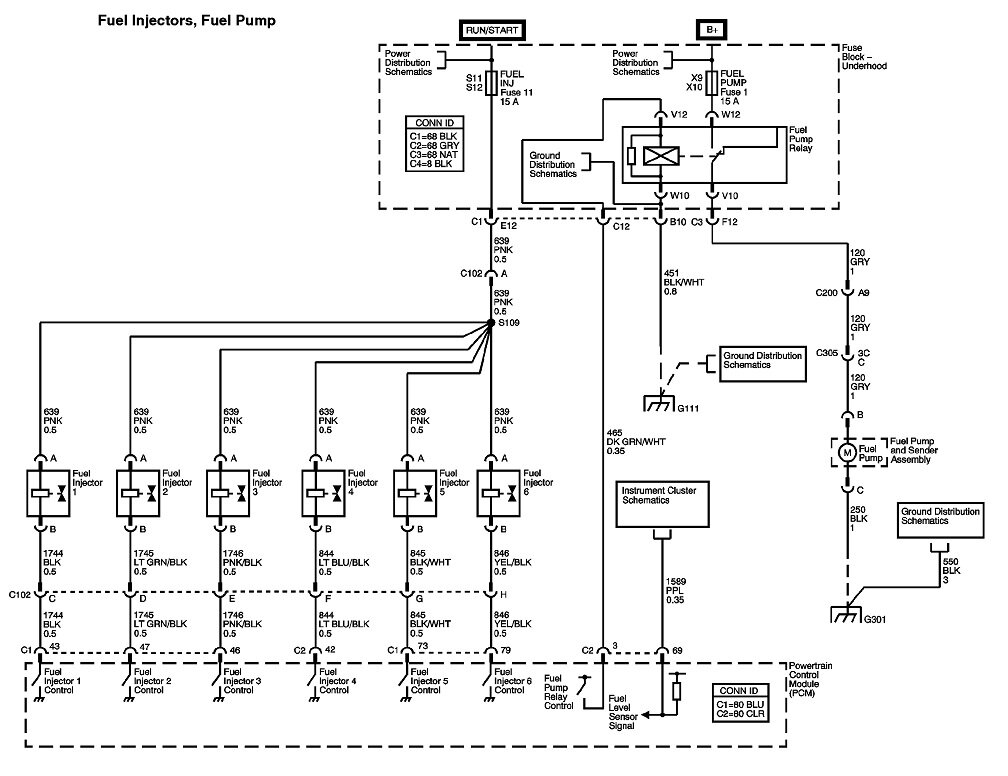

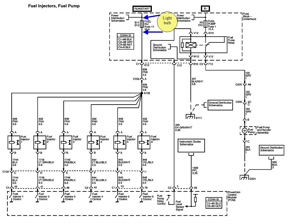

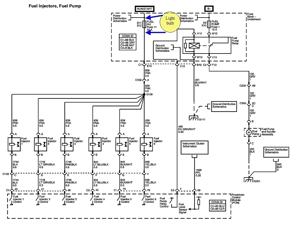

The #11 fuse is always hot, I guess when the ignition key is turned, but I'm not 100%. According to one diagram, it says "Hot in Run or Start". This circuit provides power to all 6 fuel injectors, and I gather it's the PCM which provides a Ground to each individual Injector to actuate/fire the Injector. My question is, how do you determine which of the 6 Injector Circuits is bad, or at fault? Could one Injector have failed or is the problem downstream from the Injector At one of the "Injector Control" circuits that terminate at the PCM.
This problem appeared on Sunday, when I start to drive across the street, I got as far as 50 yards, and lost all power. That's when I realized that the #11 Fuse had blown.
I'm trying to wrap and understand this, but my schematics are a very poor print quality.
This circuit does not appear to be associated, or affiliated, or connected to the fuel pump circuit. Is my assessment correct?

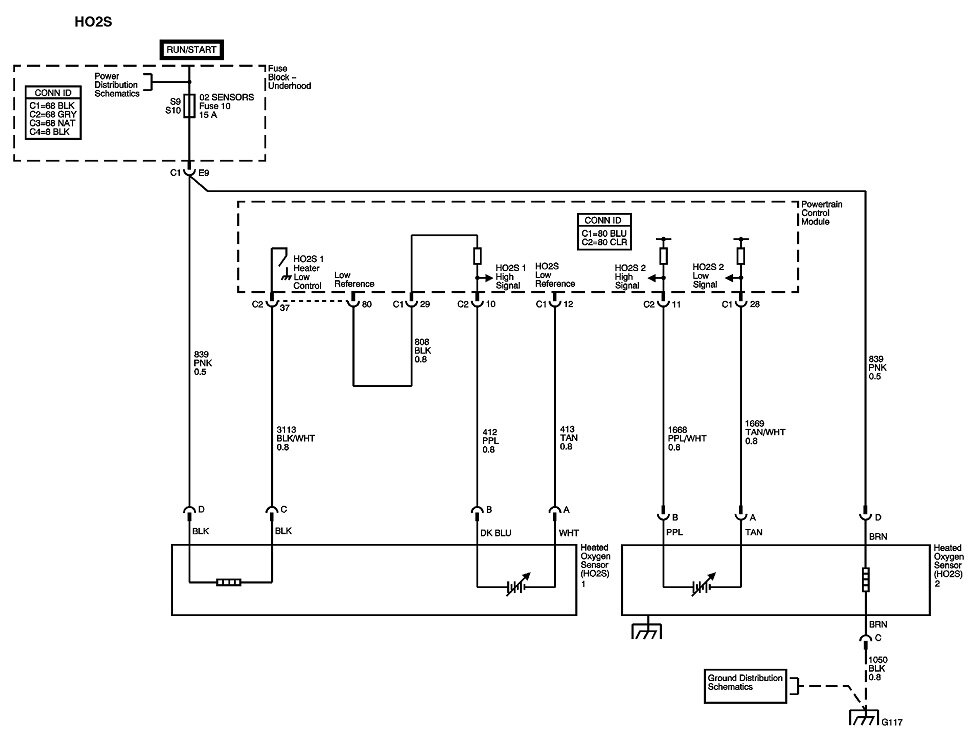

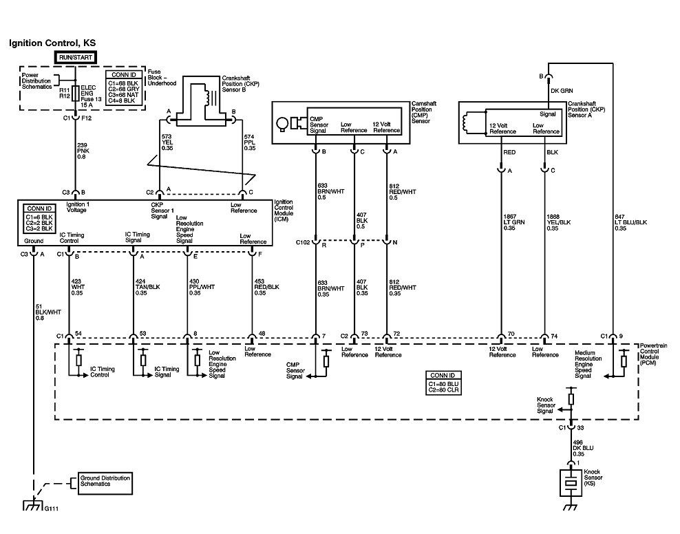

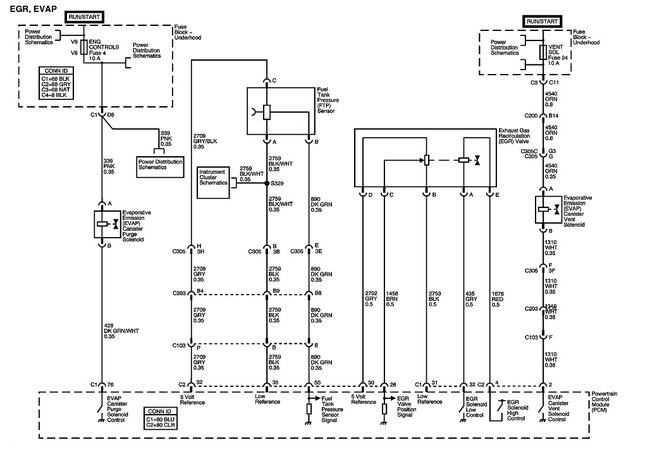

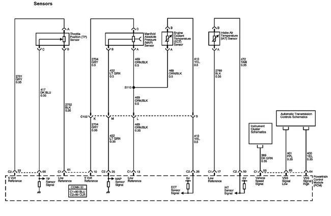

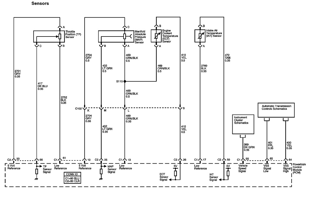

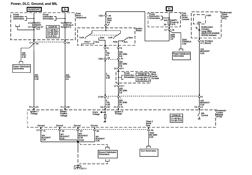

These first six diagrams are for your Power Train Management system. The seventh one is just a copy of the third one where I added my light bulb. You have system operation correct. 12 volts is supplied to the injectors, then the other side of each one is grounded by the Engine Computer when it wants to pulse one open.
GM has more problems caused by injectors than most other manufacturers combined, but being outright shorted isn't one of them. I've never run into a shorted injector on any brand or model, so put that on the bottom of the list of suspects.
If a driver transistor inside the Engine Computer is shorted, it would hold that injector open as long as the ignition switch is on. The symptoms would include anything resulting from too much fuel, as well as a real long crank time to start the engine. That would be due to fuel pressure bleeding down within a few seconds. That pressure should hold for days or weeks. That would not cause a fuse to blow.
As far as how to find this, assuming you have the light bulb in place of fuse # 11, like I described, it will be full brightness if there is something shorted on that circuit. Start by unplugging anything you can find in that circuit. In this case, you'd start by unplugging one of the injectors at a time. The better suspect would be that wire were it runs over to the engine. Look for bare spots, dry-rotted insulation, or if the harness fell down onto or is rubbing on the sharp edge of a metal bracket. When you unplug or do something that removes the short, the test bulb will get dim or go out.
If you're starting out with a dim test bulb, or it is off completely, the short is not there now. This is the time to look for things that shift as the engine rocks between acceleration and coasting or backing up. Wire harnesses as far away as running along the top of the inner fender can slide back and forth until the insulation on the wires wears through.
You're also correct that the fuel pump isn't related to fuse # 11. Only the injectors are listed for that fuse.

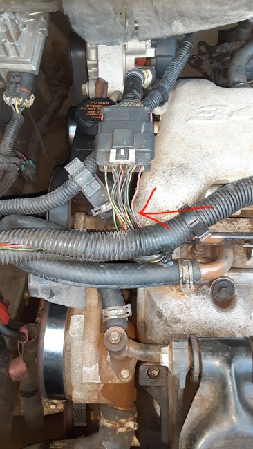

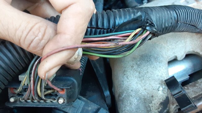

I solved the mysterious Electrical short on my vehicle. A Power wire in a bundle rubbed against the Intake Manifold and wore out the protective shielding on that one pink wire which provided power to all the Fuel Injectors from Fuse #11. A friend of mine assisted me, he inadvertently solved the problem by moving the bundle of wires, but I discovered the actual short and damaged wire. I wrapped the wire up individually, and then the entire bundle of wire to improve the protective shielding on the bundle of exposed wires. It's All Good now.
Thanks for your help, the information, advice and assistance you gave me. It gave me a lot of confidence.

I was able to resolve the problem with the help of CARADIODOC. The electronic/electrical issue turned out to be a shorted wire, near the Upper Intake Manifold, a wire loom which carried power to the Fuel Injectors, had rubbed itself bare, and was exposed, which caused a shot. The power steering issue is another matter, but it's just a leak at present.
