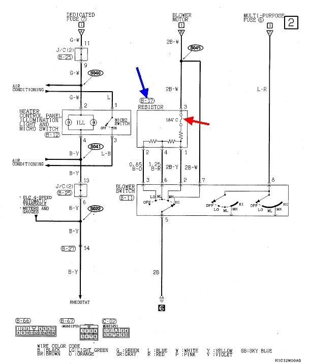

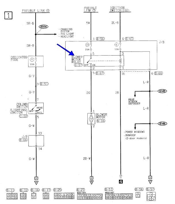

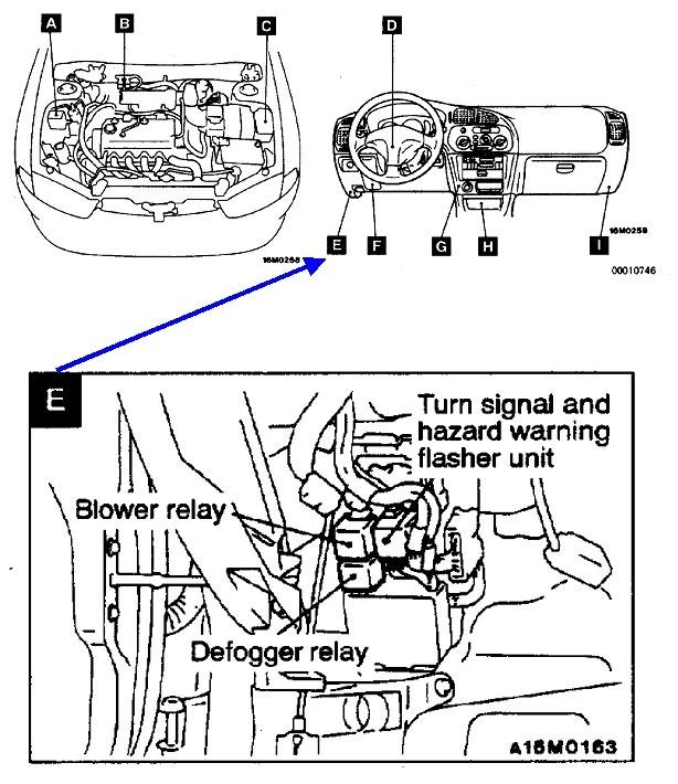

There is indeed a relay that supplies the 12 volts for the fan. Be aware there's four different Mirage models, and not all use the same engines, and some circuitry will be different. This circuit doesn't involve any computers, so diagnosis should be pretty straight-forward.
Pull the blower relay out of its socket, then check for 12 volts on two terminals. One should be there all the time; one only when the ignition switch is in the "run" position. If you don't find two 12-volt feeds to that socket, we'll have to figure out which one is dead, then check the appropriate fuse.

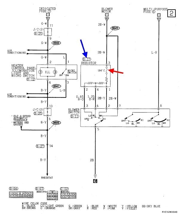

If you do have both 12-volt feeds, stick the relay back in, then feel if it clicks when you turn on the ignition switch. If it does, check for 12 volts on the green wire at the blower motor. If that is there, do a continuity test from the motor's white wire to a good body ground. You should typically find a few ohms of resistance, but not more than perhaps ten ohms, depending on the fan speed switch setting. If that circuit is open, the best suspect is the thermal fuse inside the resistor assembly is burned open, and that is almost always due to tight bearings in the blower motor.
The next suspect would be the speed switch has burned contacts, and that is usually accompanied by two melted terminals, and hardened wires, at the back of the switch.
Let me know what you find up to this point.

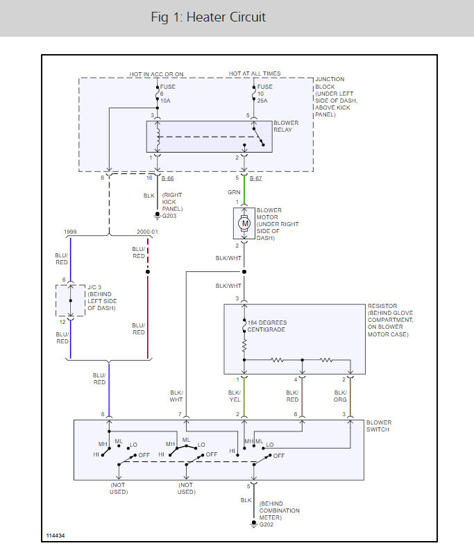

Here is a guide to help you check for power and a more complete blower system wiring diagram so you can see how the system works:

Please list the specific places you're finding 12 volts so we don't confuse each other. Did you find it on two terminals in the relay socket?
The radiator fan is on a separate circuit, so that won't make a good clue this time.
If you're missing 12 volts on the green wire to the fan motor, the relay has to have burned contacts, or it's not turning on. Did you feel if it clicks when you turn on the ignition switch? Regardless of the cause, if there's no 12 volts on that green wire, you won't have any voltage further down the line at the resistor assembly or the switch. That would suggest those parts are not good suspects. We need to figure out why there's no 12 volts on the green wire.

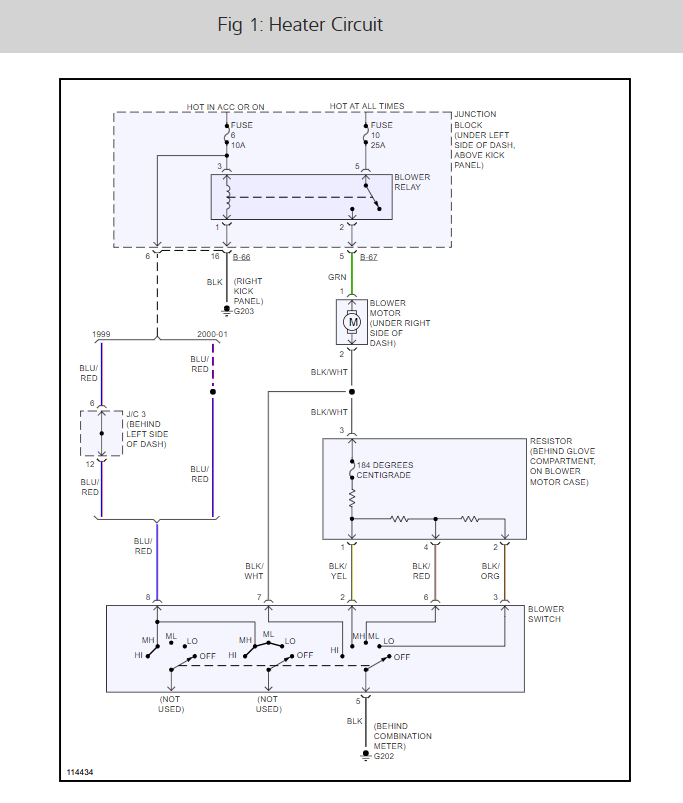

After looking at the diagrams y'all provided I could see where to go and found the burnt blower motor fuse.... man. thanks a lot for y'alls great effort in trying to help everyone. even though it is a ask a free question deal you guys work as no other professionals out there. keep up the excellent work and god bless. god bless caradiodoc and his team.
