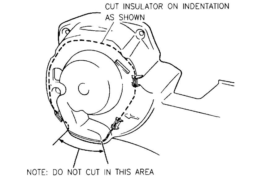

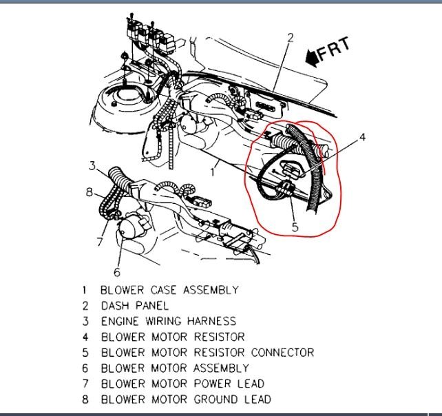

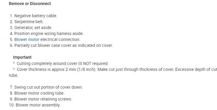

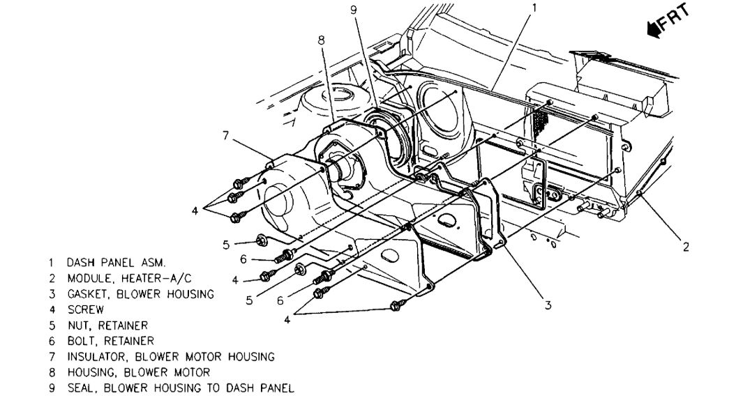

The blower motor was weak and now has totally stopped working. I had no wining noises prior to it stopping to blow. Also if it is the resistor can I hot wire blower motor until I get the part? What is the best way to access the blower motor if it needs to be changed?
Feb 4, 2020 at 10:21 PM
Good morning,

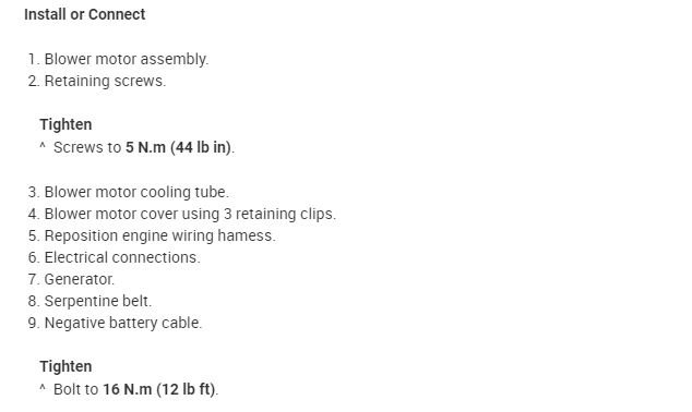

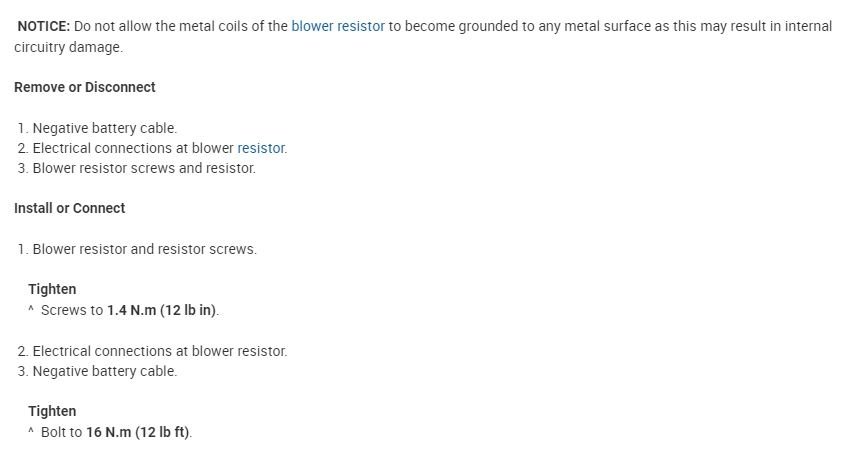

I attached the procedure for both the blower and resistor.

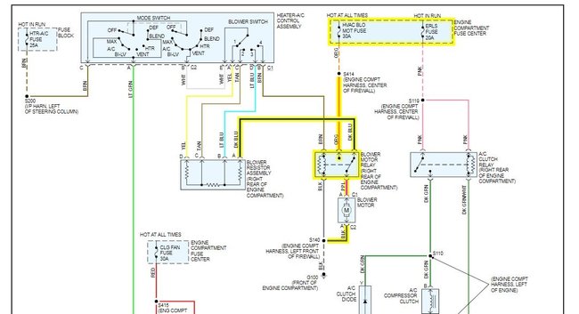

I also attached the wiring diagram. Make sure you have power to the resistor with the key on. Without power, neither the motor or the resistor will work.
https://www.2carpros.com/articles/blower-fan-motor-works-on-high-speed-only
Do your checks first before replacing anything.
