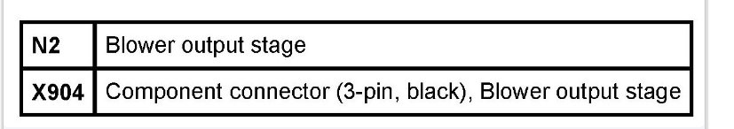

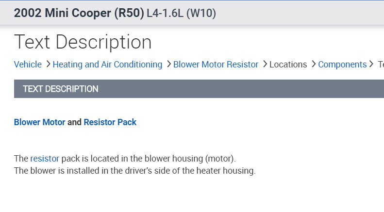

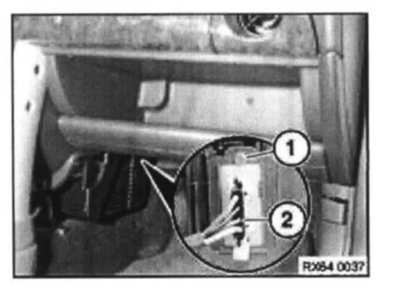

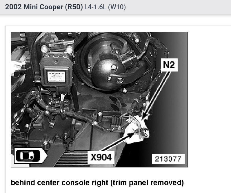

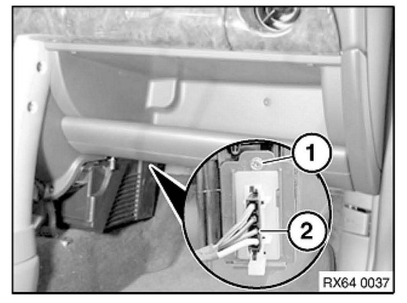

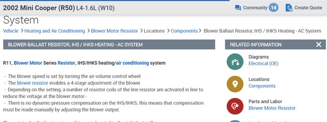

I have auto air. It is not where it's supposed to be according to every diagram I've looked at. I went to a local junk yard and was able to locate it on a 2003 model but my 2002 it is not in the same location. I even removed the panel on the drivers side and it is not there either. I'm confused.
Apr 13, 2019 at 2:55 AM
SCGRANTURISMO
  • 4,897 POSTS
I have included the information that you requested in the diagrams down below. Please go through it and get back to us with what you are able to find out, please. If you have any other automotive questions, then please , don't hesitate to ask. That's what we are here for.

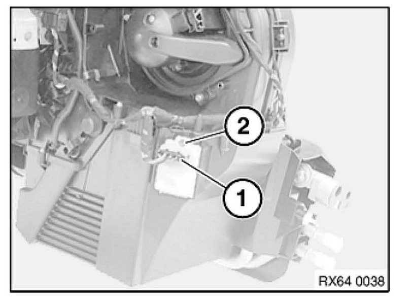

Thanks for the reply, but those are the same images I found online. Unfortunately my resistor is not located there. I even went to a local junk yard and found the resistor in that spot on the car there it was a 2003 though, but it is no where to be found on my car. There was a post from back in 2013 where someone couldn't locate their resistor on a 2002 model also. I even removed the plate on the drivers side and not there either. It has to be in a somewhat accessible location. I may just have to contact a shop that specializes on working on minis. Thanks

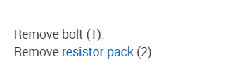

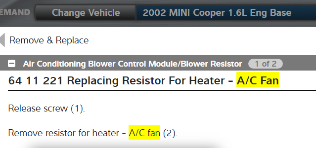

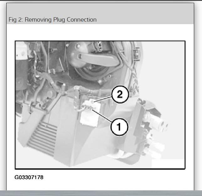

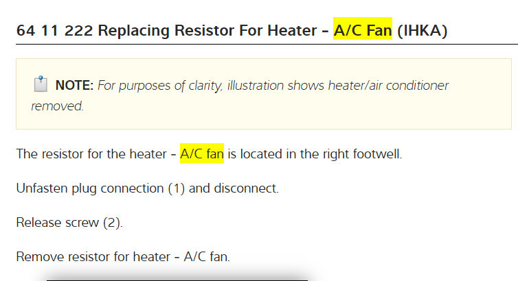

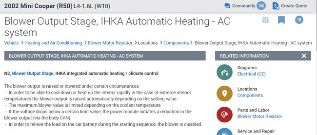

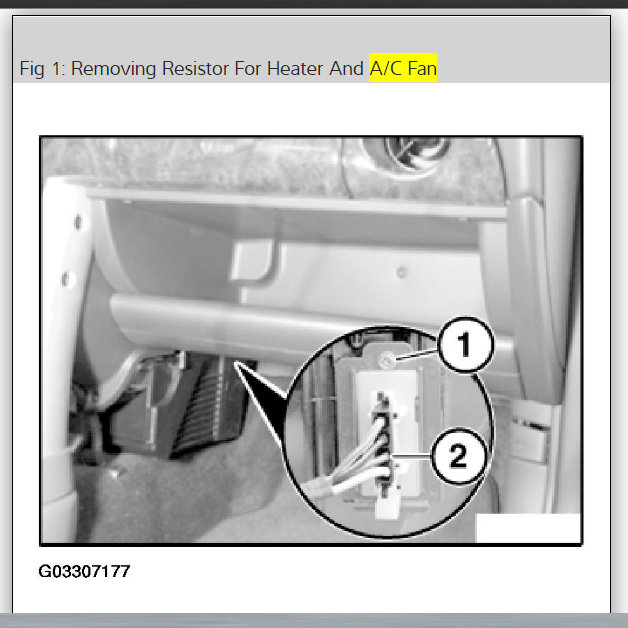

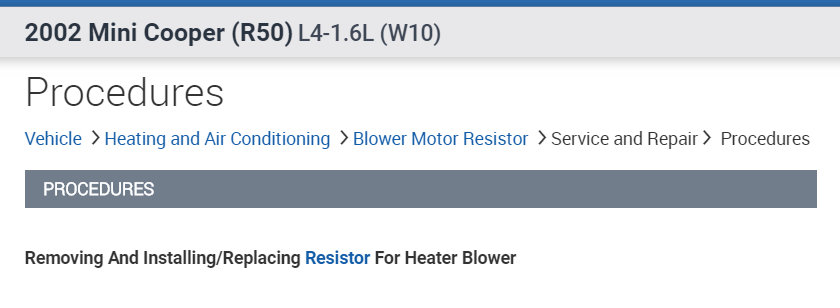

Hello again,

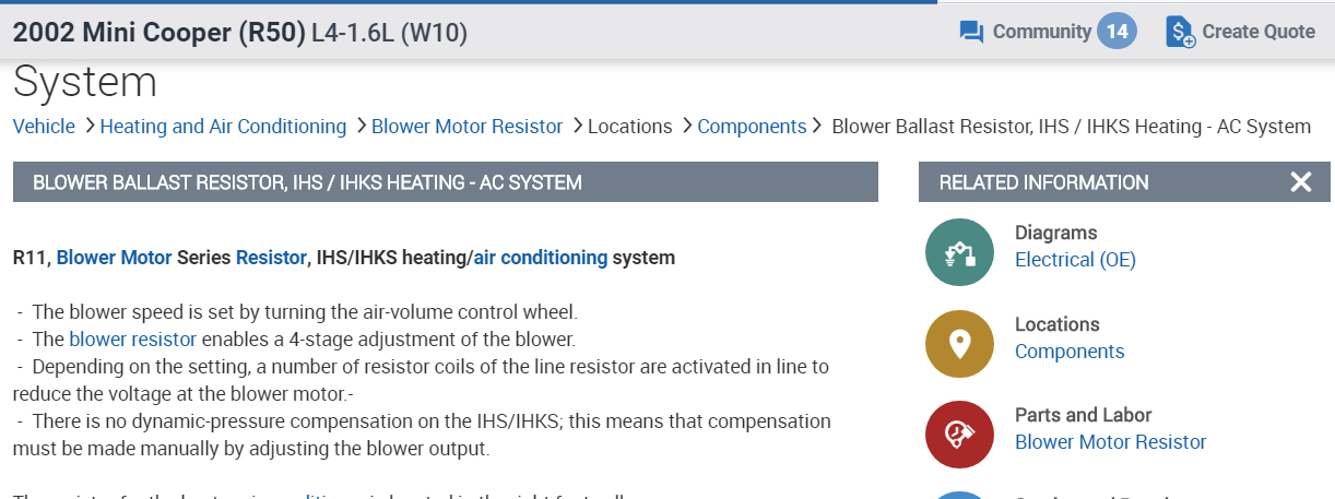

Here is what I have from my other resource. It is a little more involved, so hopefully there is something in here that works for you. Get back to us and let us know, please. The information is in the diagrams down below.
