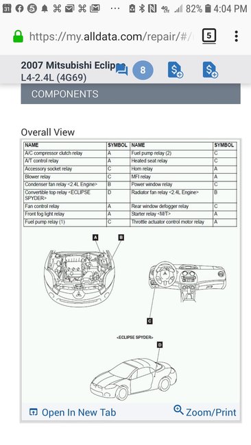

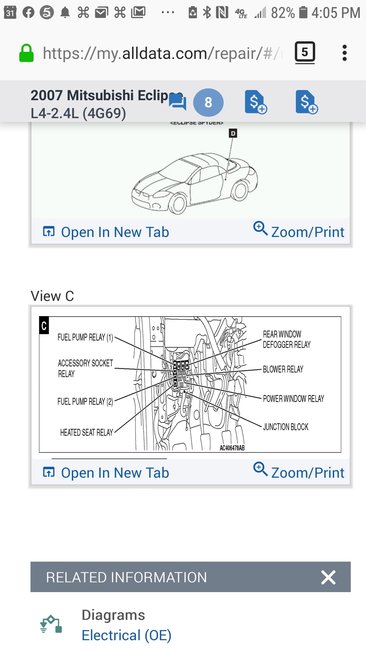

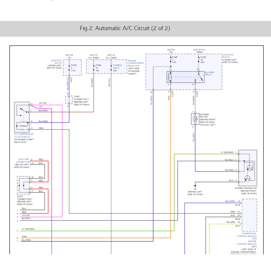

Need to locate the blower motor relay location in the car listed above. The manual just says relay but does not specify which one.

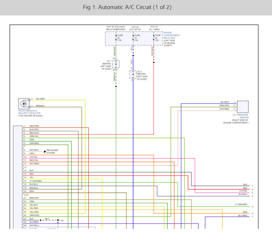

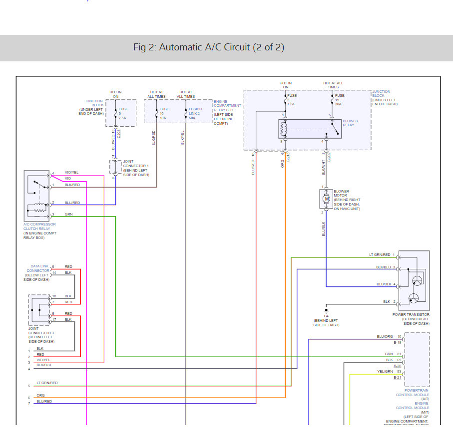

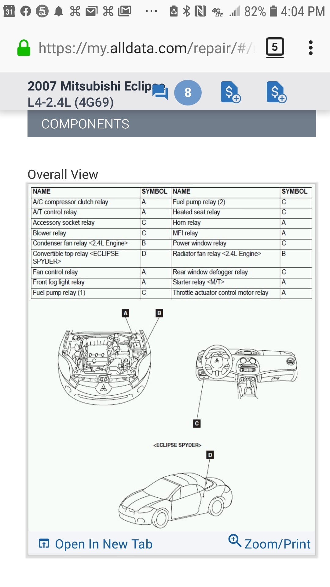

Hello! I'm attaching a couple of images that I just pulled from AllData. They should clarify things for you. Let me know if you need anything else.

Okay, perfect, thanks. The issue I am experiencing is that the blower motor stays on even when the key is off the ignition. This started couple of days ago when I added Freon to my car.
The A/C will work for approximately 10 minutes and then no more cold air. The only way to force the blower motor fan to stop is to either take the A/C fuse out and then put it back on (which makes the A/C work again) or turn the knob for the fan to the off position. However, the moment I put the knob back to the 1 or 2 etc., I can still feel the air come out. As such, this makes me think that it could be the blower relay maybe stuck? Any input on the matter is appreciated.
Jul 10, 2020 at 6:51 AM
HARRY P
  • 2,292 POSTS
Honestly, it seems like you've got a good handle on it. I would also start with the relay. If that doesn't do it I'll have to pull up a wiring diagram to see if something else on the circuit could cause that. But definitely start with the relay. If it's the same relay as another circuit, I'd switch them around and see if the behavior changes any.

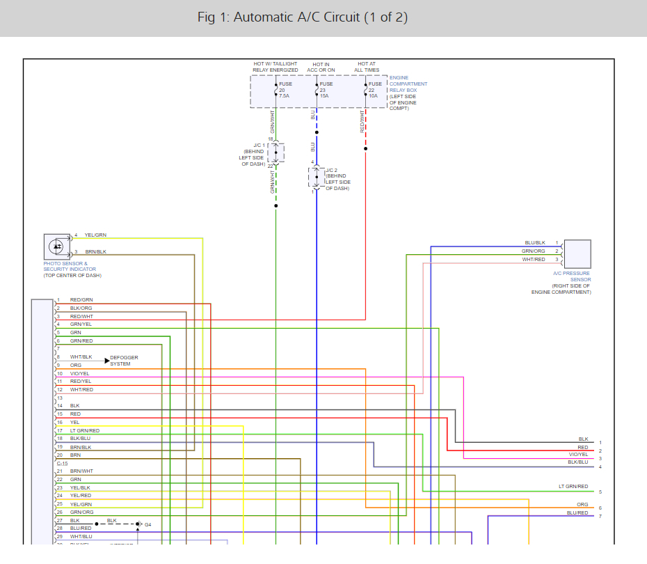

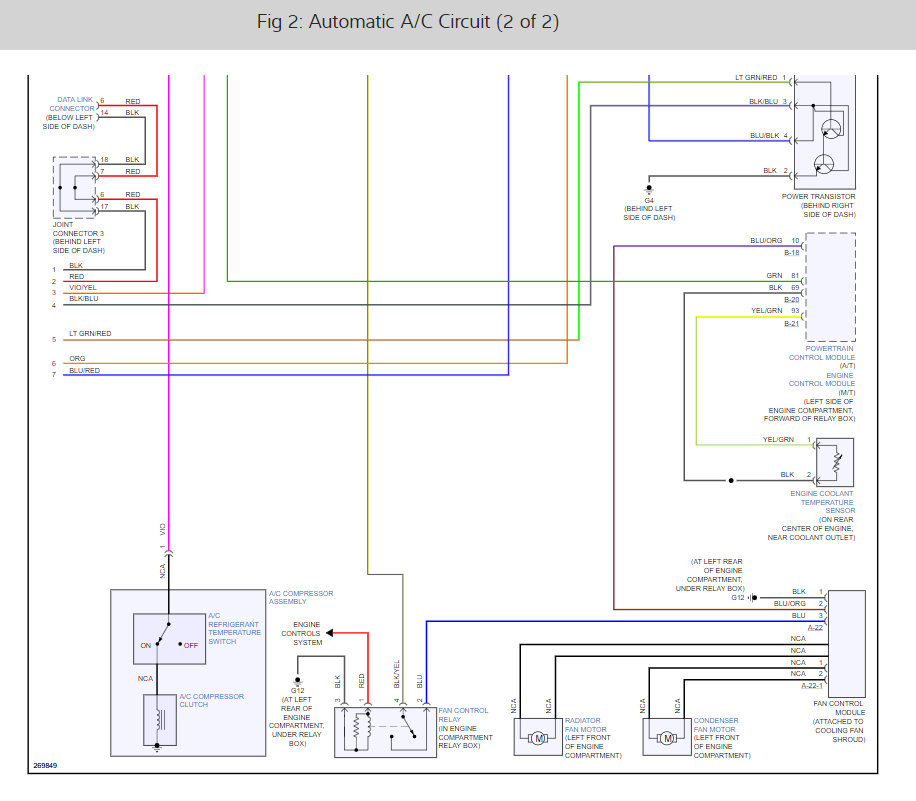

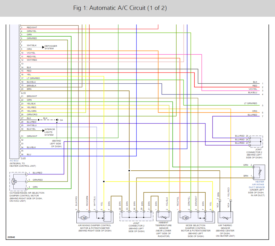

There is an A/C ECU that sounds like it is bad. To be sure we can do a CAN scan which is the future of automotive repair you can get a CAN scanner from Amazon for about $50.00. here is a video to show you how:
https://youtu.be/InIlnsjOVFA
Also I have included the A/C and blower wiring so you can see how the system works. Check out the diagrams (below). Please let us know what you find. We are interested to see what it is.

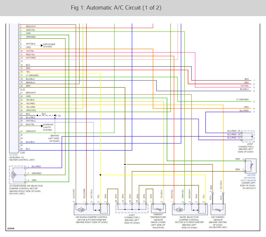

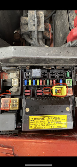

Hey guys, sorry about the delayed response. There are other developments that took place, the heater is not working, the lights on the climate control don’t turn on. This was working before the above issues with the AC. The air comes out from one direction only(face) it doesn’t matter if i switch to feet or face and feet or just windshield. The fan speed does work as it should. I checked the fuses that are under the steering wheel (30a) not blown. I even replaced the blower motor resistor, same outcome, no heat.
Oct 17, 2020 at 4:09 AM

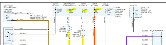

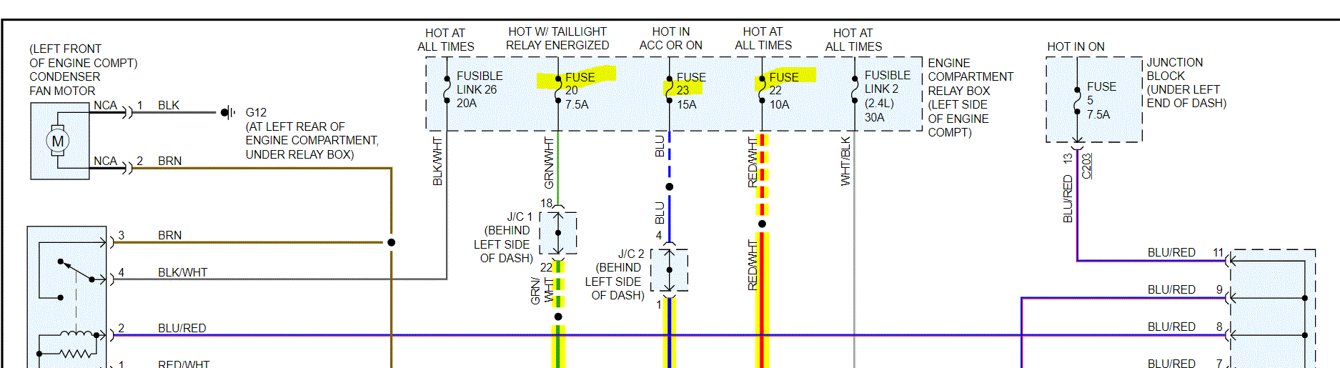

I need you to check the fuses under the hood. See that attached pics. Note that the 30 amp is a fusible link and not a traditional fuse. In addition to checking the fuse condition, make sure there is power to it as well as power out. Here is a link you may find helpful:

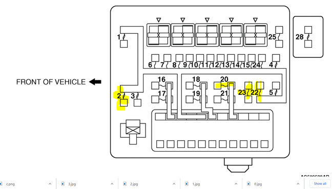

Included below is the fuse box. I seem to be misunderstanding which fuses to check I believe. The ones I circled are the ones I checked to see if blown, they are not. The yellow one i am not sure how to pull it off (if I have to) I will be testing power here soon but wanted to share this first. Please let me know if I’m off track.
Oct 18, 2020 at 4:36 AM
  • 110,236 POSTS
You are correct. There are two fuses in the yellow unit. You can pull one at a time.
Oct 18, 2020 at 1:30 PM

Issue fixed!
Turns out that the cables behind the climate control dash were unplugged. I do not know how this could have happened but the last time any work was done on the car was to change the e-brake cable. I can’t see how this could lead to it but I told the person who worked on it last.
