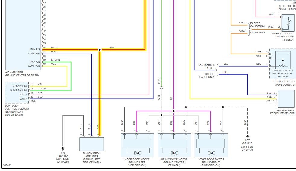

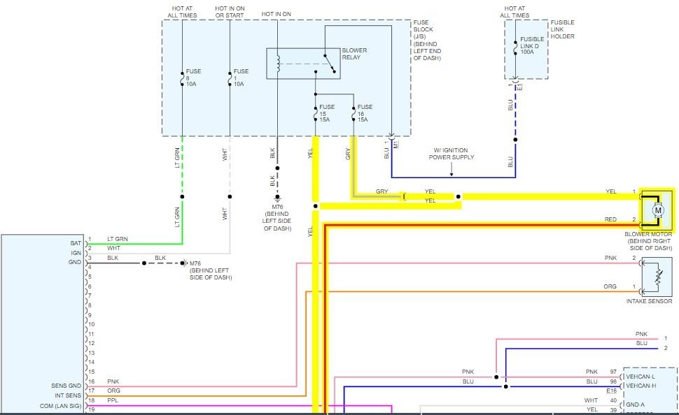

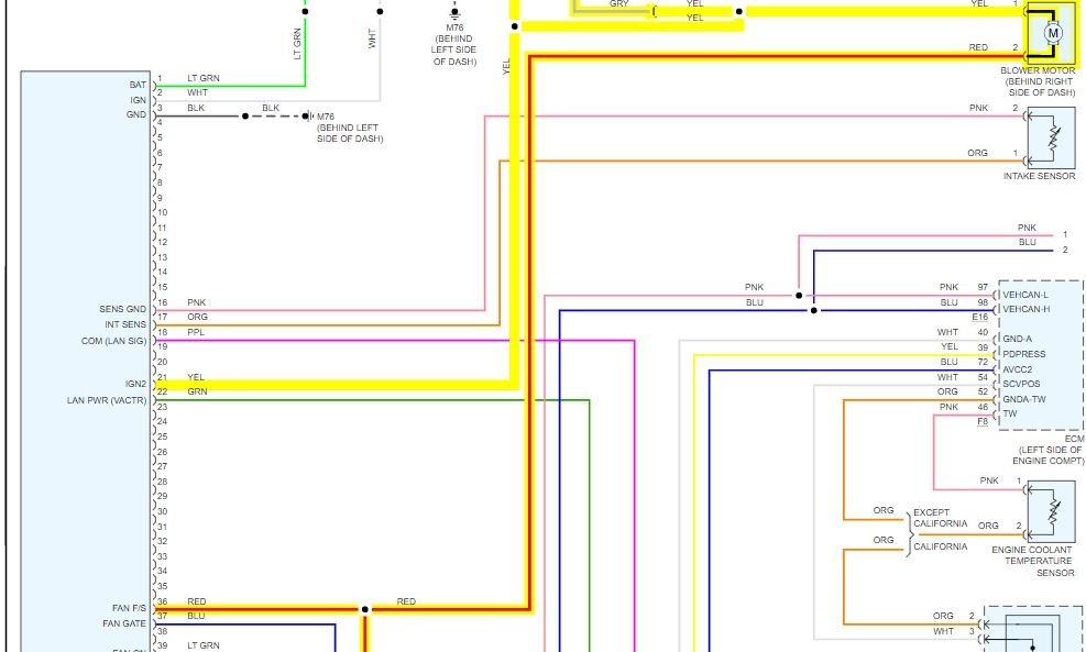

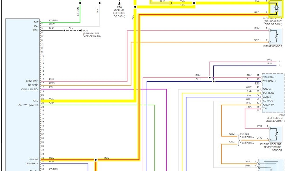

Good morning,
I attached a wiring diagram of the system for you to view. I would start by checking the fuses for power on both sides of the system.
Beyond that, we need to do some voltage checks at the motor to see if it is the motor itself.
https://www.2carpros.com/articles/blower-fan-motor-works-on-high-speed-only
The system does not have a resistor, it has an amplifier.

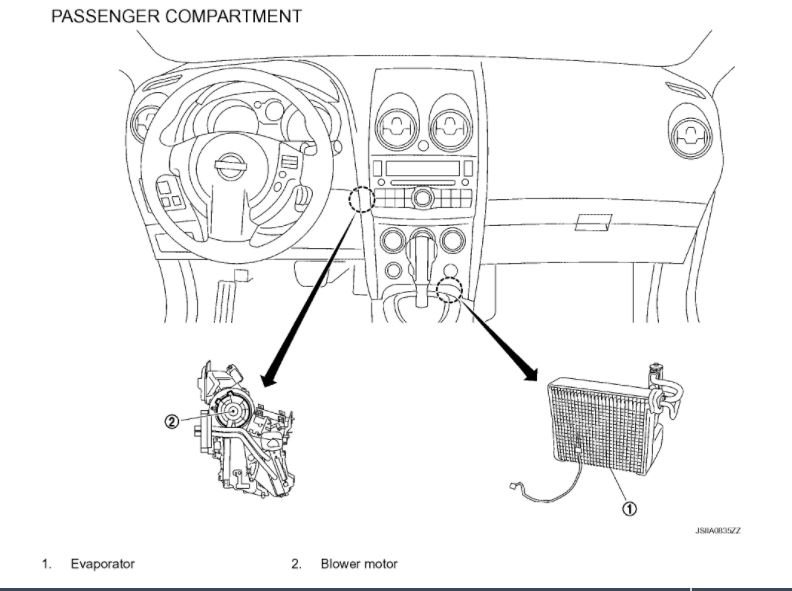

BLOWER MOTOR
Removal and Installation

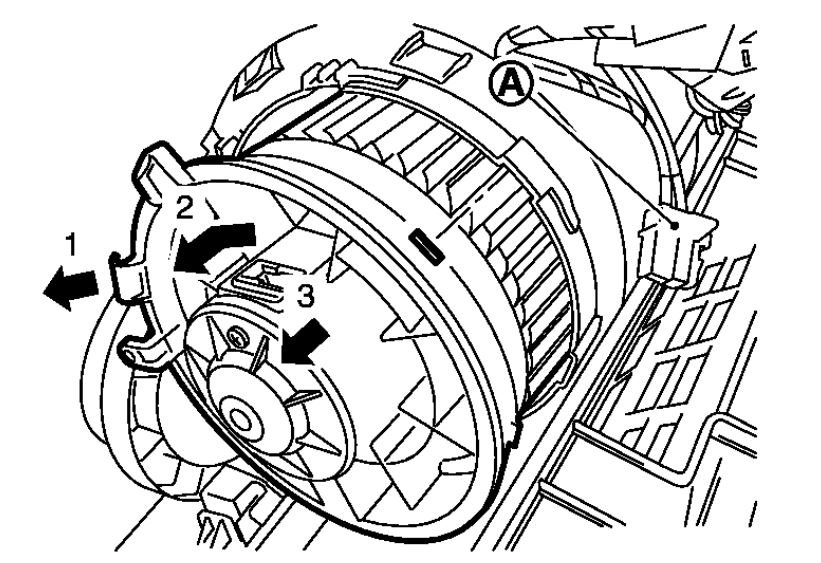

7. Disconnect blower motor connector (A).
8. Press flange holding hook (1). Then turn blower motor counterclockwise (2).
9. Pull outside (3) and remove blower motor.
CAUTION:
The balance is adjusted when blower fan and blower motor are assembled, so do not replace the individual parts.
