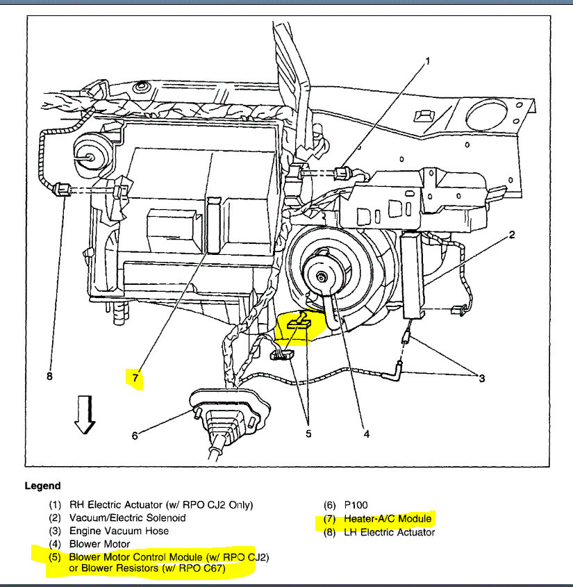

Would like to know where the blower motor control module/resistor
is located ?

They are both under the dash. I attached a pic below that shows their locations.
What is happening? Is the blower motor not working at all?

I replaced a bad blower motor and a close by door blend actuator. I heard the door actuator close and the fan motor was running just fine until day 2, when the blower motor just stopped. I checked all the fuses and replaced 1 relay, (weird reading on test).
I have power to the climate control area but no fan. Any thoughts on my issue?

Have you checked for power at the fan motor or the resister? One may have failed again.
