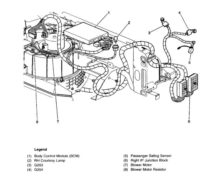

Blower motor blows for a minute and then stops and continues to do the same over and over.

The first thing I would do is to check the connector on the blower motor itself to see if it is loose or if the connector has burned or damaged pins. Loose connections can cause this issue.
The other thing is the blower resistor. It is a common problem for shorting to power not allowing the blower to work or it may work very infrequently.
If you have a voltmeter or test light we can walk you through some testing.

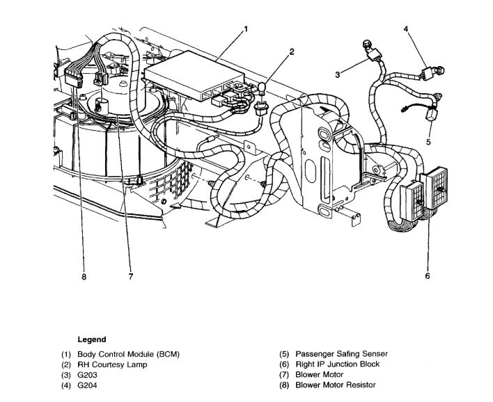

The blower motor resistor is located in the lower right hand corner of the HVAC module. This resistor is located between the blower motor and the front of the dash.

Blower motor
BLOWER MOTOR AND FAN REPLACEMENT
REMOVAL PROCEDURE
The blower motor and fan are located in the lower right hand corner of the HVAC module. Service this component as an assembly only.
