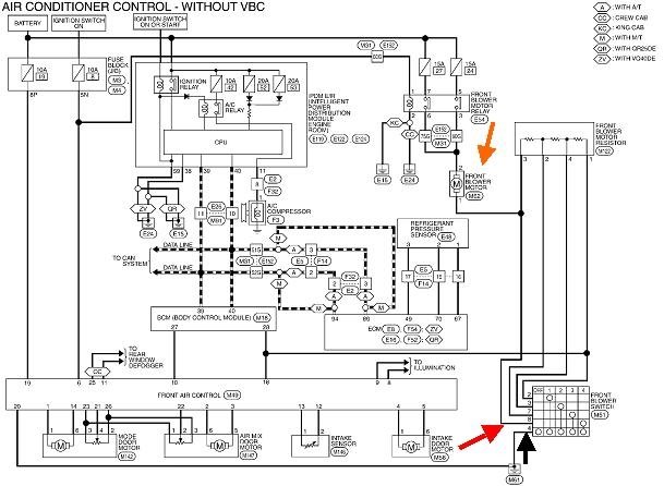

The blower motor started varying in speed then quit. It smelled like a burned motor for a minute. I changed the blower motor, resistor, climate control panel and the blower motor relay. Still doesn't work.

When you can smell it, the cause is usually an overheated pair of mating connector terminals. Start by looking at the back of the control panel you removed and see if there's one or two terminals that are black or discolored. If you see that, replacing the panel is only half of the repair. We'll discuss that if necessary. The most suspect terminals are shown with my red and black arrows in the diagram, but check them all.
Overheated terminals can occur at the resistor assembly too, but much less often because they're usually pretty tough. When that happens, the fan will still run on the highest speed. The motor terminals also cause much less trouble. Typically if they overheat and melt the connector, you'll see it right away because you likely won't get the connector apart without a lot of crying and kicking.
If the terminals look okay, check for 12 volts at the motor's terminals. The ignition switch must be in the "run" position, but in this circuit, it doesn't matter where the speed control switch is set. To be most accurate, the connector should remain plugged in, then take the readings by back-probing through the back of the connector. The test light should be bright or off completely. That will tell us which way to work toward next. If you find a dim light, that's still a valid clue, but we'll have to think a little deeper. Normally for this type of problem, we are only interested in whether we have something or nothing. Exact voltage readings are of less value.
