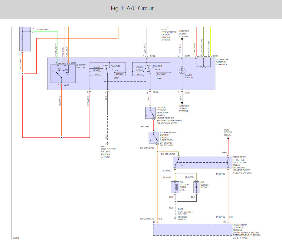

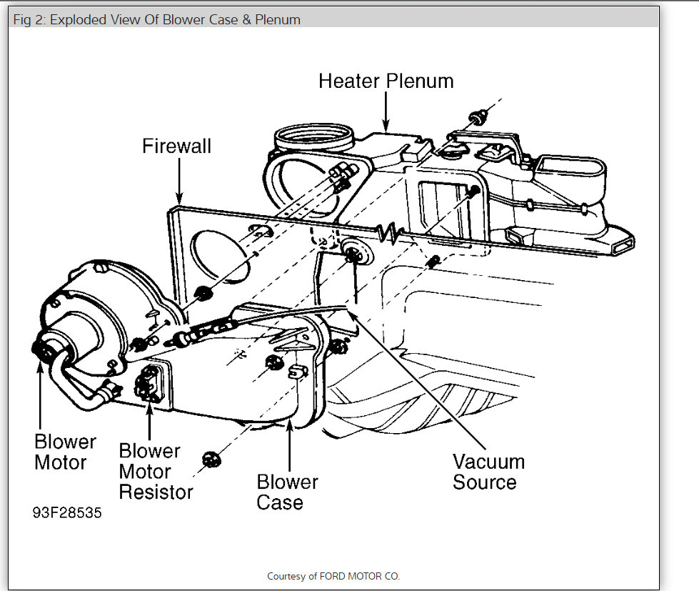

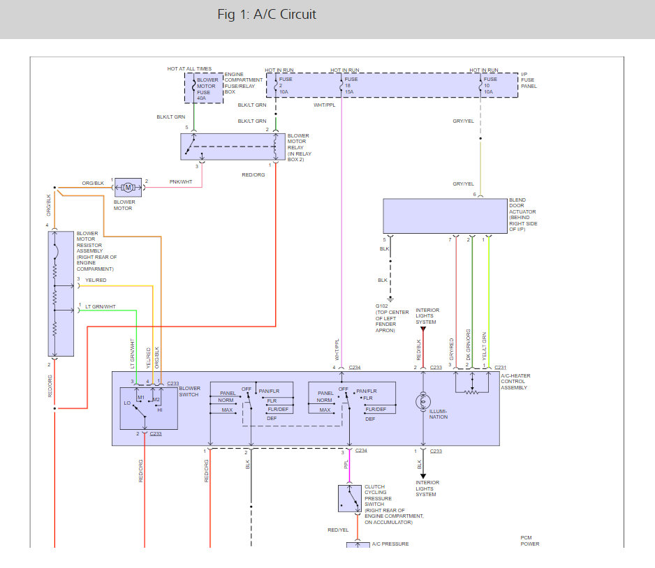

The blower motor was running while my shop was charging the A/C and when completed, shut it off, cleaned up everything and started it and the blower motor will not run. The A/C compressor is okay.
Jan 22, 2019 at 8:56 AM
  • 55,694 POSTS
It sounds like the blower motor might have gone out here is a guide to help you confirm the failure and the wiring diagrams so you can see how the system works below.
https://www.2carpros.com/articles/blower-fan-motor-works-on-high-speed-only
Check out the diagrams (Below). Please let us know what you find. We are interested to see what it is.
