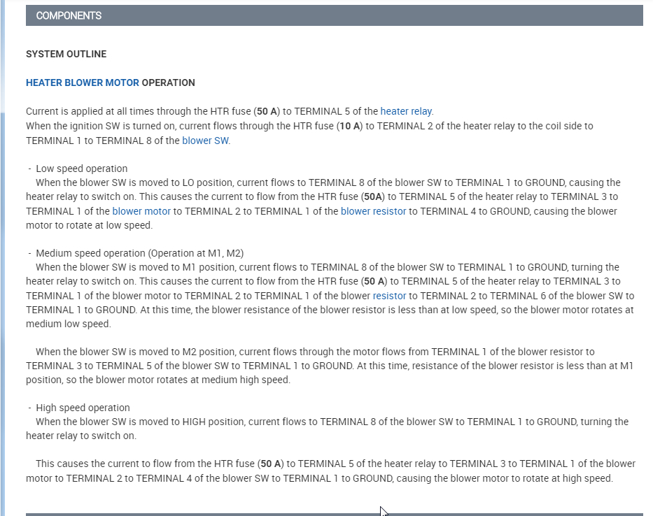

I've checked the fan, the fan resistor and the relay, and still no power, but A/C light is not working either.
Nov 6, 2019 at 6:54 AM

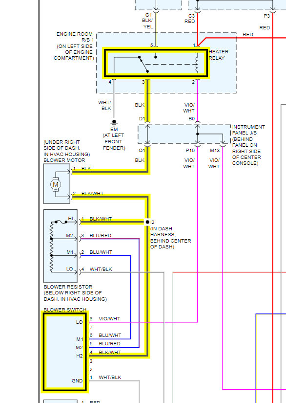

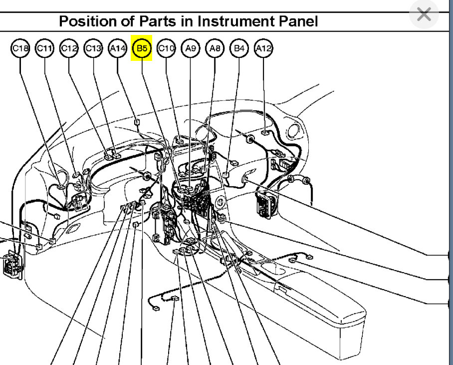

Okay. I suspect you have an issue with the switch. I attached the operation that includes the terminal info to test to see if you have power. If not, you can jump power past the switch and see if the fan kicks on. If it does then you know the rest of the system is in tact.
Let me know if you have questions and we can go from there.
Keep in mind this switch is what is called a ground side controlled. That means it is after the load of the motor and resistor so if the switch or its ground has failed then the circuit cannot be completed so it will not operate.
Nov 6, 2019 at 8:59 AM

Okay, thanks for the help. I have followed your instructions but I have grounds on all the wires, even on both sides to the blower(?)
Nov 7, 2019 at 1:49 AM
SHAWN C. LOCKLEAR
Thanks for the help again, it was the actual control unit.
