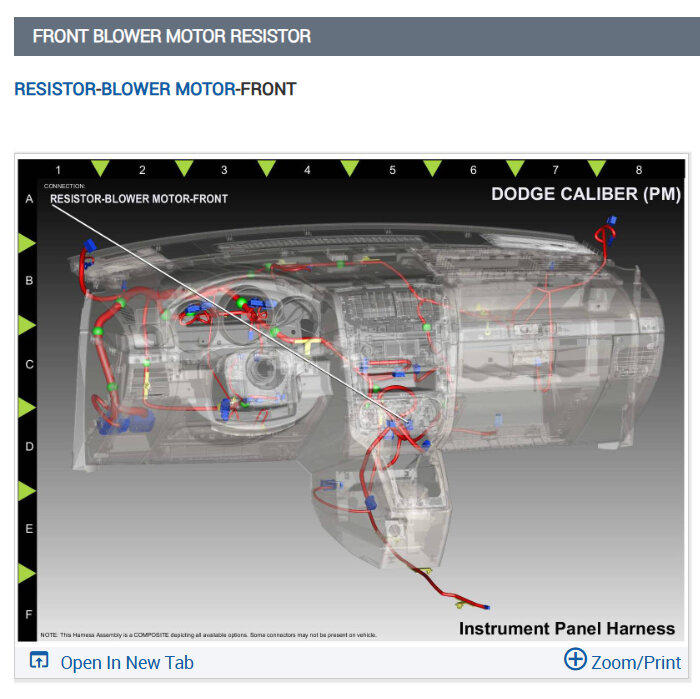

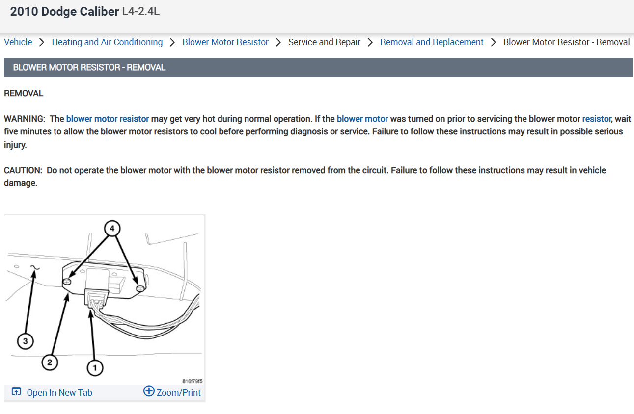

As far as the blower motor problem is concerned it sounds like the blower motor speed control is not working. The high-speed fan setting bypasses this part which works on high. Here is the location of the speed control so you can see what needs to be done if you want to fix it yourself. The part should be about $40.00 and the labor about $80.00. Check out the images (below). Please let us know what happens.
