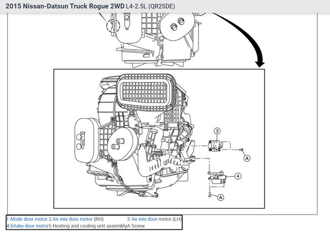

The blend door motor gear and the attaching blend door gear have chewed each other to the point where the blend door has failed in the cold position. It appears that the blend door or the door gear and/or the linkage needs to be replaced (and a new blend door motor as well) I did have my mechanic turn the blend door gear with a screwdriver to the heat position but over time and vibration it needs to be turned again. What does it take to have this problem resolved to normalize my blend door function?

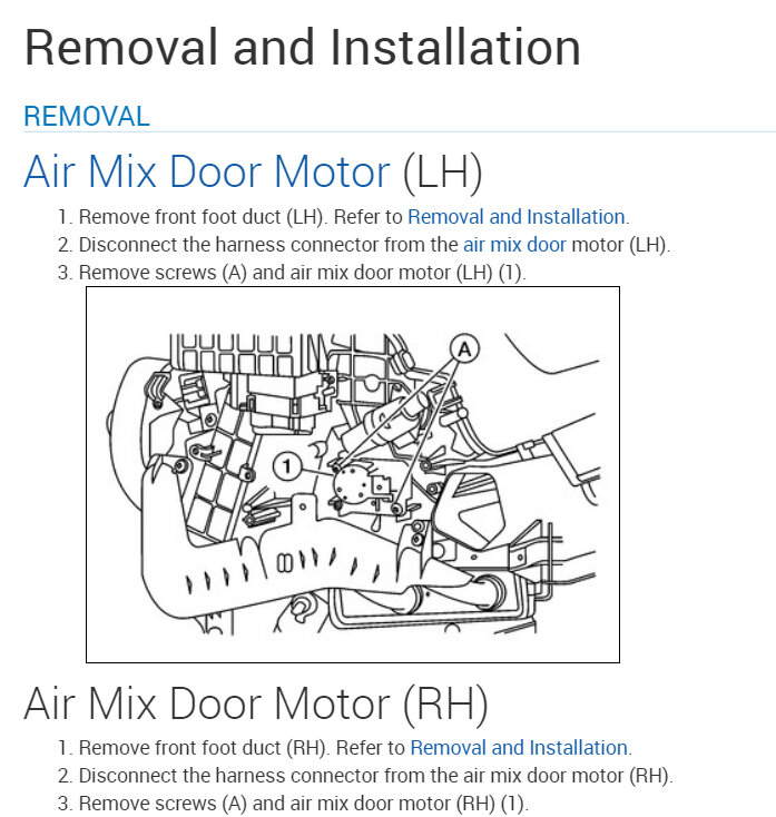

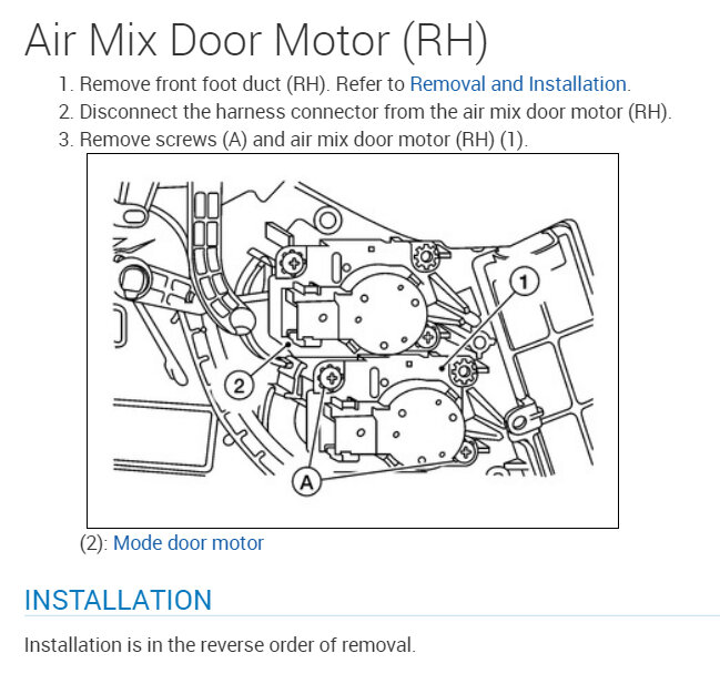

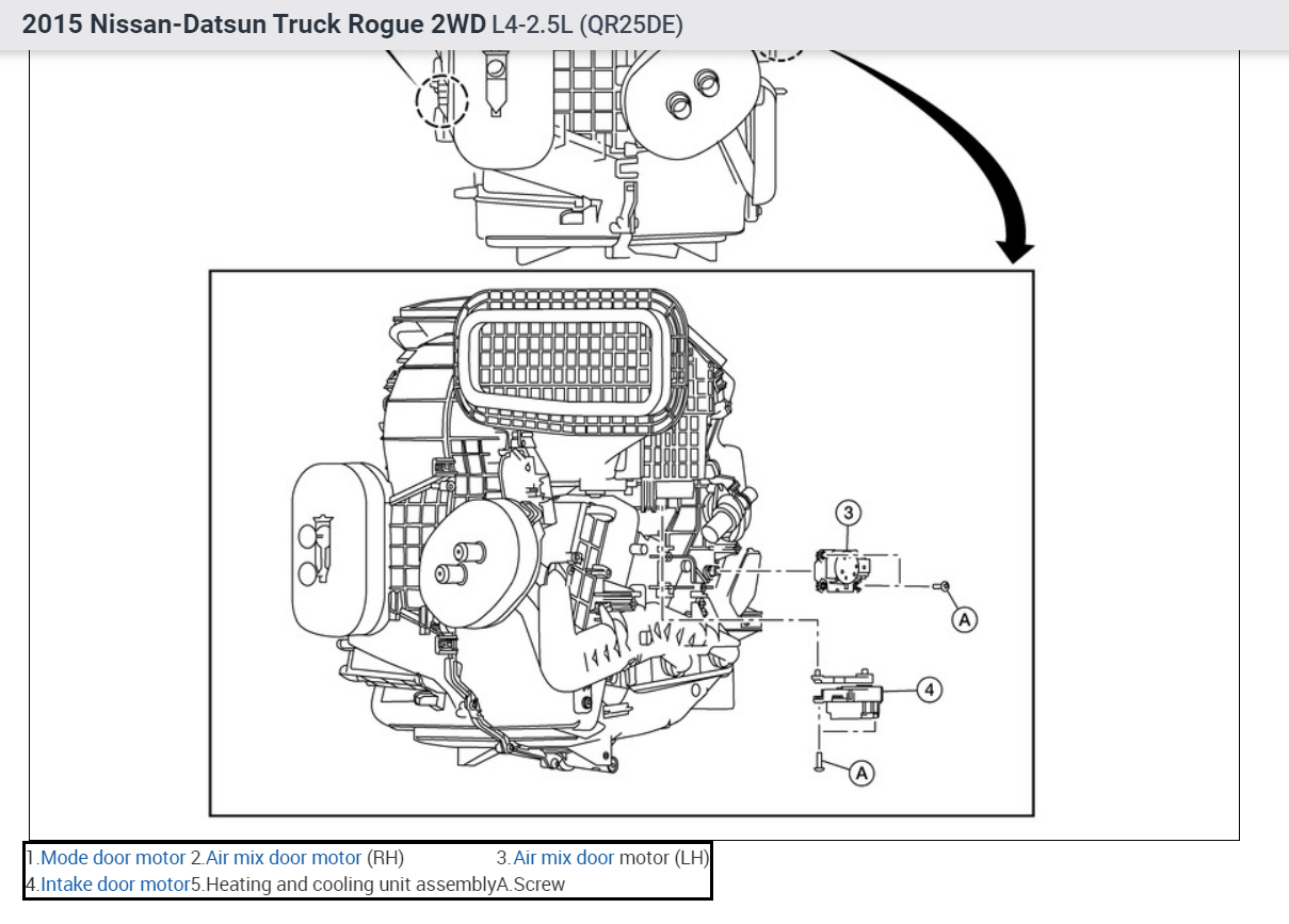

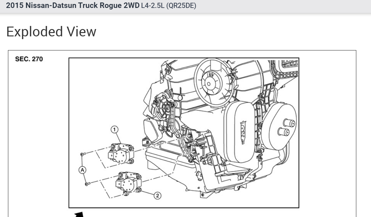

Sure, it sounds like the air door mix actuator needs to be replaced. I am looking at the unit and I don't see the gears you are talking about on the plenum, check out the images below to see what I am talking about and how to replace the actuator as well. Check out the images (below). Let us know what happens and please upload pictures or videos of the problem.
