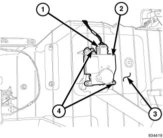

my truck's heater is not working all the more if A/C. what can be?

The blend air door actuator is responsible for allowing heat or AC into the vehicle. If the fan is running but it won't produce heat, first take a look through this link. I am basing this on the title of your post. If I am not correct, let me know.
If you feel the blend door actuator is the problem and none of the other things mentioned, here is a link that shows in general how one is replaced.
Here are the directions specific to your vehicle for removal and replacement of the actuator. The attached pictures correlate with these directions. Both single and dual zone systems are listed.
__________________________
BLEND DOOR ACTUATOR - REMOVAL
REMOVAL

SINGLE ZONE/DUAL ZONE DRIVER SIDE
pic 1
1. Disconnect and isolate the negative battery cable.
2. Remove the glove box See: Glove Compartment > Removal and Replacement > Instrument Panel Glove Box - Removal.
3. Disconnect the HVAC wire harness connector (1) from the blend door actuator (2) located at the rear of the HVAC housing (3).
4. Remove the two screws (4) that secure the blend door actuator to the HVAC housing and remove the actuator.

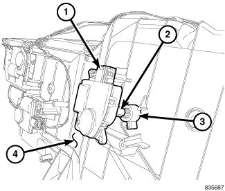

DUAL ZONE PASSENGER SIDE
pic 2
2. Remove the HVAC housing (1) from the vehicle and place it on a workbench See: Housing Assembly HVAC > Removal and Replacement > HVAC Housing - Removal.
3. Disconnect the HVAC wire harness connector (2) from the blend door actuator (3) located at the front of the HVAC housing.

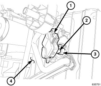

Pic 3
1. Position the blend door actuator (1) to the back of the HVAC housing (4). If necessary, rotate the actuator slightly to align the splines on the actuator output shaft (2) with those on the actuator coupler (3).

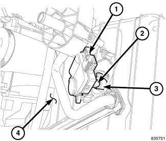

Pic 4
2. Install the two screws (4) that secure the blend door actuator (2) to the HVAC housing (3). Tighten the screws to 1.1 Nm (10 in. lbs.).
3. Connect the HVAC wire harness connector (1) to the blend door actuator.
4. Install the glove box See: Glove Compartment > Removal and Replacement > Instrument Panel Glove Box - Installation.
5. Reconnect the negative battery cable.
6. Initiate the Actuator Calibration function using a scan tool See: Heating and Air Conditioning > Component Tests and General Diagnostics > A/C Performance.
