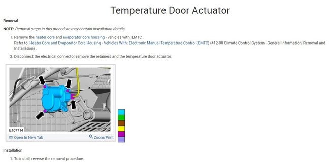

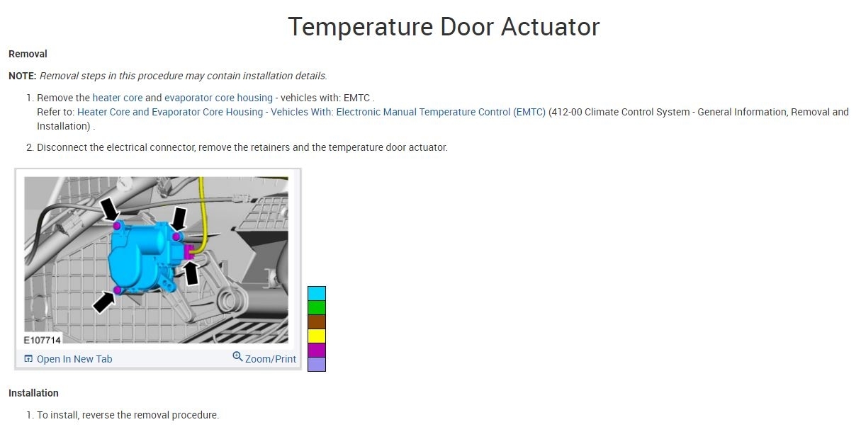

I took my car to the dealership and after the diagnosis, they said I needed to replace AV1Z-19E616K which required I remove the dashboard leading to a pricey repair. I was wondering if there were any guides or directions on how to get to this piece to replace it.
Aug 7, 2021 at 6:42 AM
STEVE W.
  • 15,352 POSTS

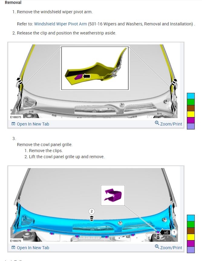

Unfortunately they are correct, to replace that blend actuator the HVAC case has to be removed to get to the actuator located on the back side of the housing. To do that you need to be able to recover the A/C refrigerant, drain the coolant and then you can start on the actual repair. I attached the book information on the part itself as an image, notice the blue lines saying to remove the housing and heater cores first.
To start with you will end up removing the wipers and the cowl panel from under the windshield, then the drivers side front door, then the seat and console. That is all to get room to access the various bolts and fittings to remove the case then you remove the steering column and then the instrument panel so you can remove the HVAC case.
Once the case is out you will have access to the blend control motor.
Before I attach the images I would like to be sure you can read them first. These are how Ford now has the service manuals, pictures instead of a lot of text. Or if you wish to read up on the entire repair with all the steps and pictures you can buy access to the service information for around 20 dollars for a year for one vehicle, that also covers testing and other items I may miss in the process.

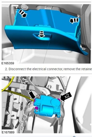

The recirculate actuator is an easy one to get to and test, it's directly behind the glove box door. To get to it you empty the glove box, press in the release tabs and drop the door down the actuator and connector is right there. To test it is simple, disconnect the connector and see if the clicking stops. If not it's not that actuator. First image.

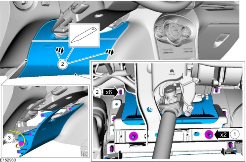

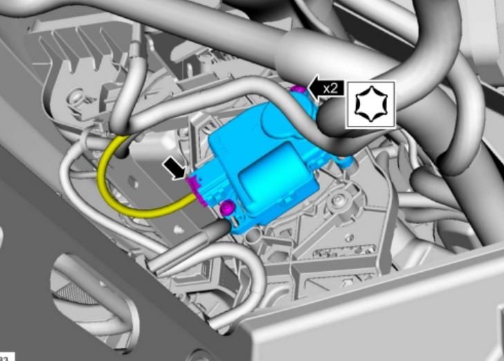

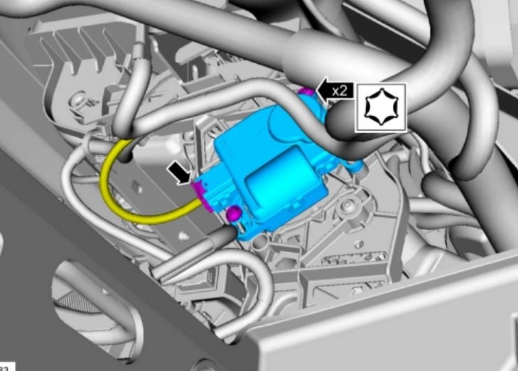

The mode door is a bit more difficult as it requires the knee air bag on the drivers side be removed first. With it out of the way the actuator and cams are on the side of the HVAC case above and right of the steering column. Testing is the same, select defrost first, then switch to floor and you can watch the cams and actuator move. If they move okay and no clicking, that unit is okay as well. Changing that actuator is also simple, place the control in defrost first, then unplug and remove the actuator. Install the replacement as it is marked on it's case. Reconnect and turn the system on and off to reset the actuators. last two images.
The temperature one however is the one you originally mentioned and it's a real bear to get to as it's located on the back of the housing. For that I suggest you have access to the service information as it will tell you how to replace the actuator as well as how to refill the coolant and A/C charge amounts. The images I used are from Alldata but are directly from Fords service information.

Thanks Steve! Using your method indicated that the recirculation actuator and the temperature control actuator are working effectively. It was the mode door this whole time, a replacement that's been well documented in videos and forums. I'll just have to order that part and take 1-2 hours to replace it myself. Too bad I didn't find this site earlier, but better than spending the $2,000.00 Ford was quoting for the repair.
