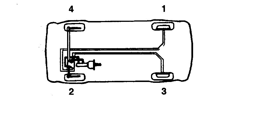

Here are the directions specific to your vehicle. The last picture indicates the sequence.

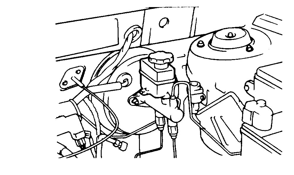

1. Remove the reservoir cap and fill the brake reservoir with brake fluid.
CAUTION: Do not allow brake fluid to remain on a painted surface. Wash it off immediately.
2. Connect a vinyl tube to the wheel cylinder bleeder plug and insert the other end of the tube in a container of brake fluid which is half full.
3. Start the engine.
4. Slowly depress the brake pedal several times.
pic 2

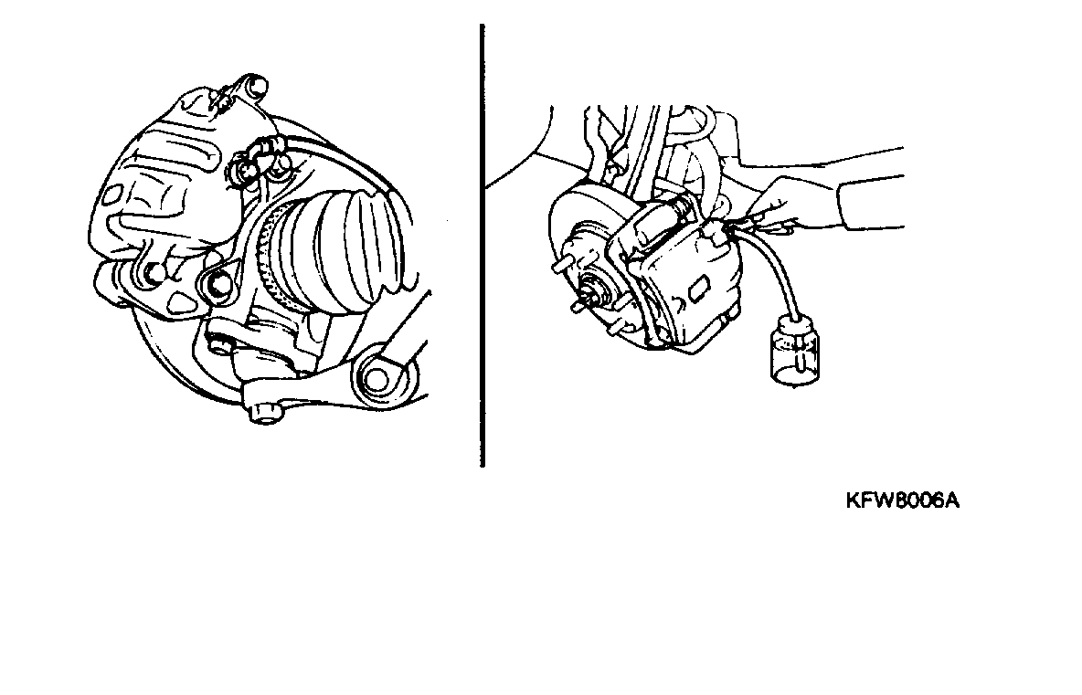

5. While depressing the brake pedal fully, loosen the bleeder plug until fluid runs out. Then close the bleeder screw and release the brake pedal.
6. Repeat steps 4 and 5 until there are no more bubbles in the fluid.
7. Tighten the bleeder plug screw.
Bleeder screw tightening torque: 7 - 9 Nm (70 - 90 kg cm, 5.2 - 6.6 ft. lbs.)
pic 3
8. Repeat the above procedure for each wheel in the sequence shown in the illustration.
