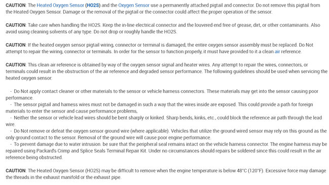

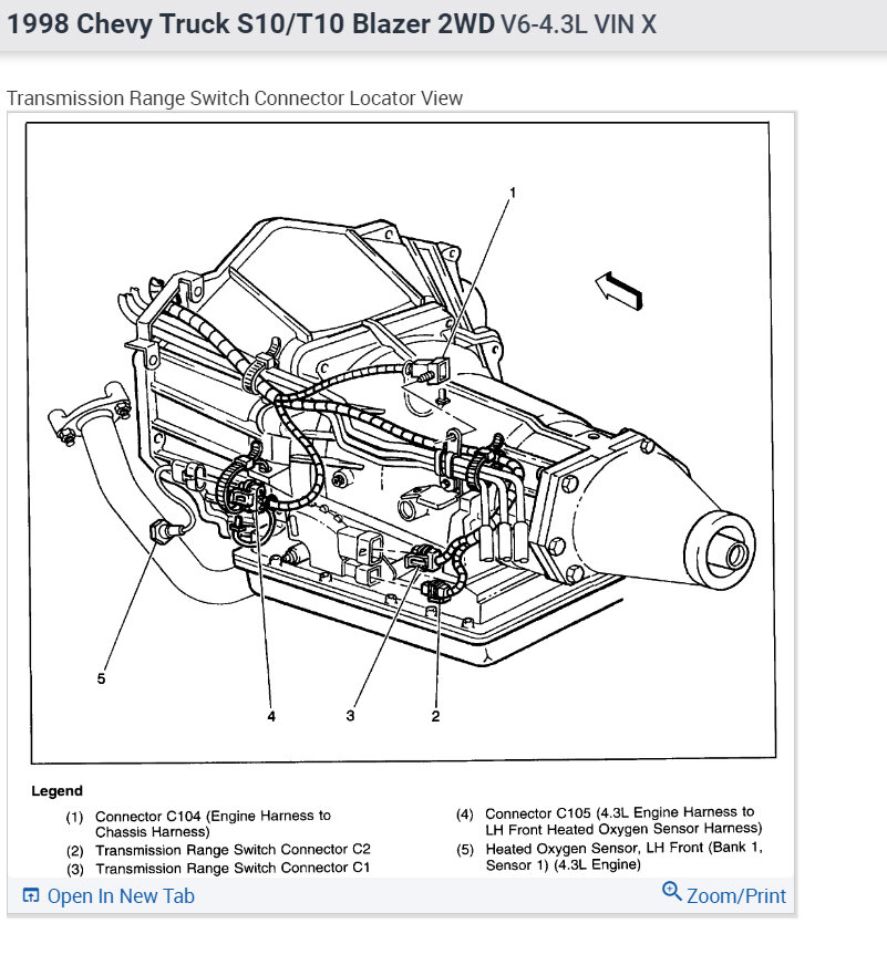

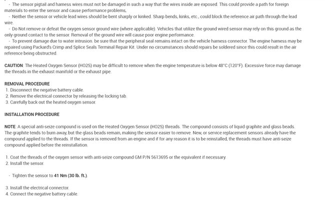

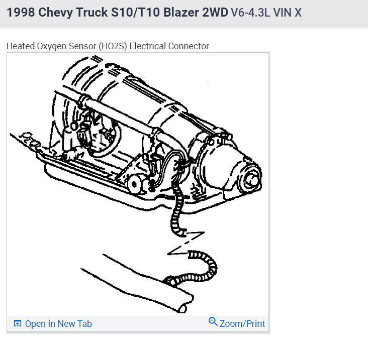

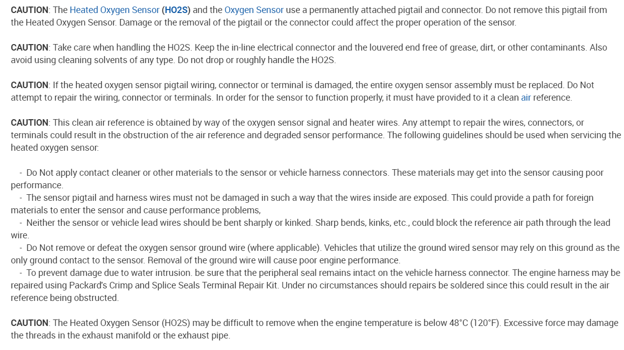

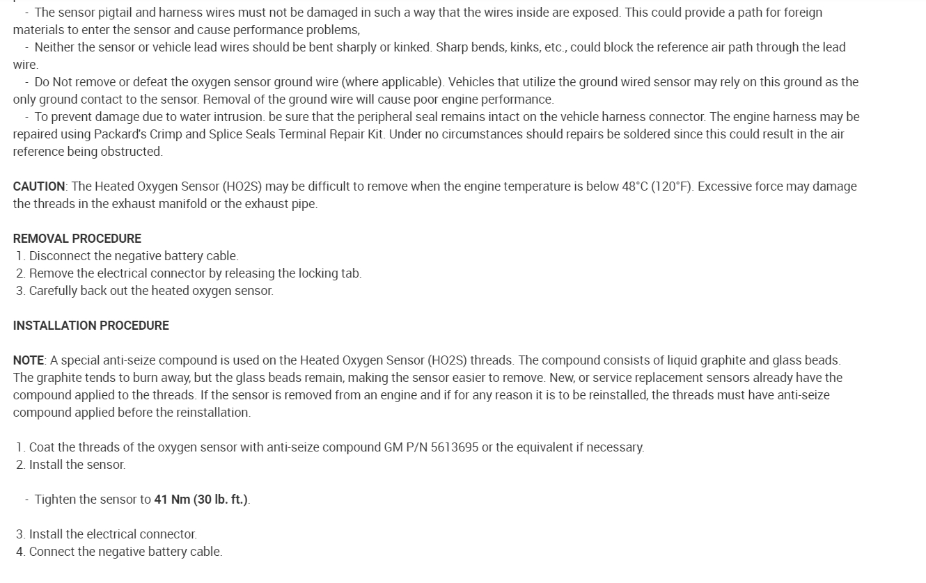

Sounds good, let me know if you have any other issues, here is a guide to help you change the oxygen sensor out and instructions for your car in the images below.
https://www.2carpros.com/articles/how-to-replace-an-oxygen-sensor
Check out the images (below). Please let us know how it goes.
