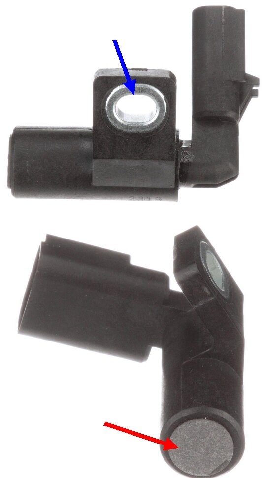

There is something you might consider as far as mechanical problems. Back in the '90s when I was working at the dealership, I was their suspension and alignment specialist, but to help out the other guys, in ten years, I replaced 13 transmissions. These were all on front-wheel-drive models, and all required removal of the crankshaft position sensor. When reinstalling them, the air gap is critical. OEM-style sensors have a thick paper spacer on the end to set that gap. It slides off the first time you crank the engine, but by that time, its job is done. Many aftermarket sensors have a thin plastic rib molded to the end to set that air gap. It can wear down over time. When reinstalling a used one of that style, you're supposed to cut the remaining part of the rib off, then use a new paper spacer.
Being the cheap fellow I tend to be, I started cutting those paper spacers into four pieces to use on four transmission jobs. That saved three customers ten cents each. By the time I got to the 13th job, I was too arrogant and didn't bother to use a spacer. I just shoved the sensor all the way in, pulled it back the approximate mount, then tightened the mounting bolt. Everything went fine at first, but that vehicle came back two weeks later with intermittent stalling. The mechanic working on it replaced the crank sensor and the problem was solved. Everyone just assumed the sensor was failing, especially since that is how they often act. I have to wonder if the stalling was due to my not setting the air gap correctly.
On your engine, the crankshaft position sensor uses a different style of mounting ear that sets the air gap automatically. The camshaft position sensor is a different story. In the photo below, my blue arrow is pointing to the oval mounting hole that allows for the adjustment. The red arrow is pointing to the paper spacer that sets the air gap. When you installed the replacement sensor, if the paper spacer wasn't there, or the sensor didn't get pushed in all the way, the air gap can be too big. That will decrease the size of the signal being developed, possibly to the point the Engine Computer can't read it. In response, it turns off the automatic shutdown, (ASD) relay. That relay sends 12 volts to the injectors, ignition coils, alternator field, and fuel pump or fuel pump relay.
Also look at the terminals in the connectors for both sensors. Sometimes one gets pushed out and makes a poor contact with its mating terminal. The female terminal can become "spread" too, especially when a voltmeter probe is stuffed into it. That makes it too wide to make solid contact with the mating terminal. Often you can identify those by wiggling the connectors while the engine is idling.
