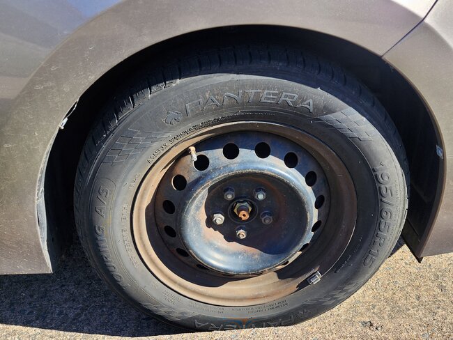

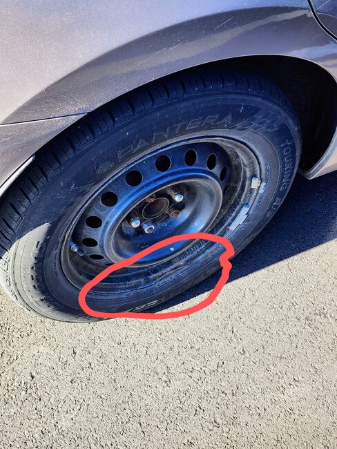

My passenger side back rim is bent. Could it be impacting the handling? The car feels like it veers to the right. The rim has been bent for about 6 months due to driving on a flat tire.
Does it need to be replaced?

I looked at the picture and certainly saw the bend. Because of the location of the bend, I don't feel it would cause a handling issue.
What I suggest is this. It should be replaced because the next time you get tires, they may have issues removing/installing a tire without damage to the bead. So, you may want to have a shop put it on the tire balancer and spin it to see if there are any other bends that may cause problems for you. If there aren't and you aren't losing air, drive it until you can get a new one.
Explain to me what is happening when driving. Let me know as much as you can.
