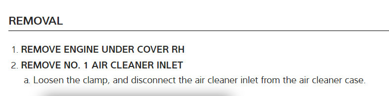

serpentine belt replacement
2009 TOYOTA PRIUS
235,000 MILES • 2WD • AUTOMATIC
TAMMYABSHER
I saw your awesome video on changing the serpentine belt. I'm planning to do that. I'm a single mom (with some tools I inherited from my dad) and your video made it capable. My dad did all of our maintenance work growing up, and I was the tool fetcher and brake pumper. Question: Is that the only belt that I need to change?

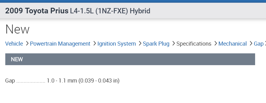

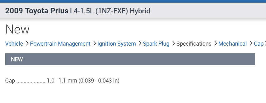

I'm also going to change the spark plugs. Thank you for that video as well! Any recommendations?

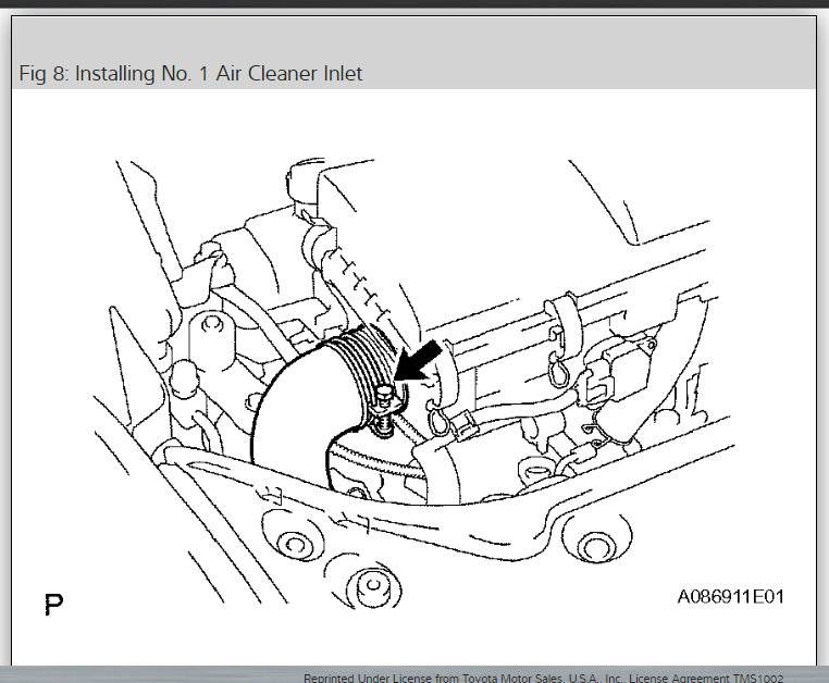

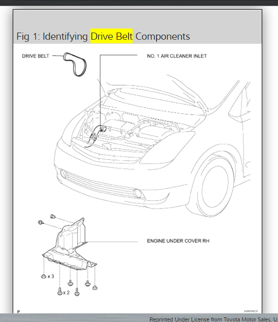

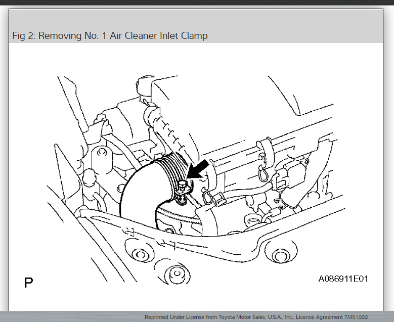

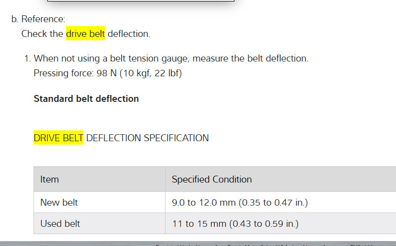

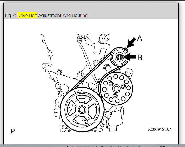

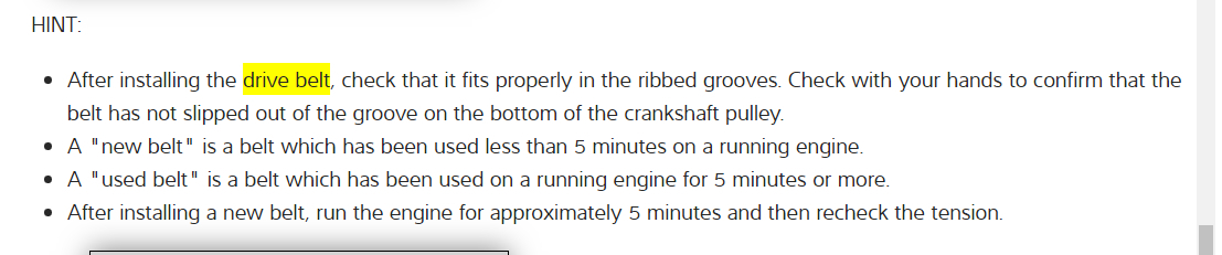

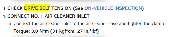

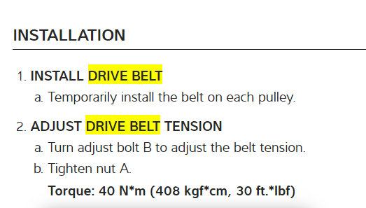

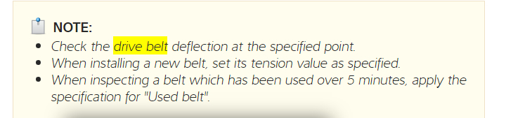

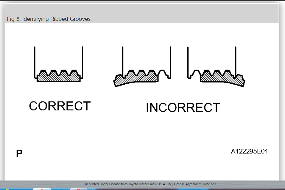

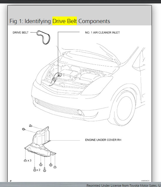

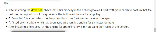

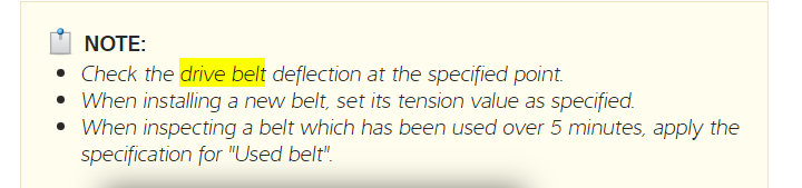

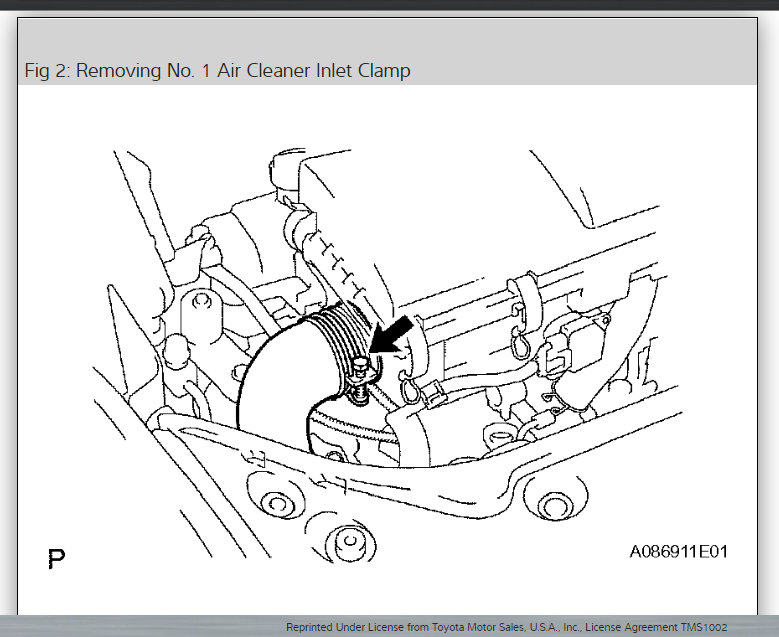

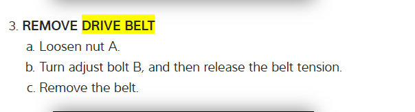

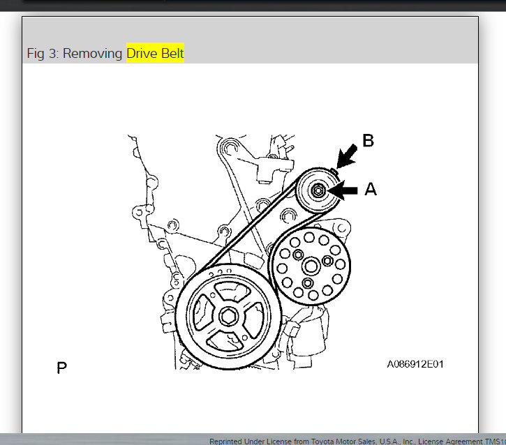

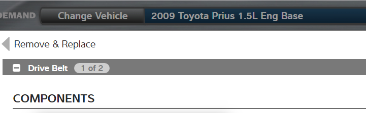

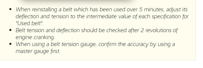

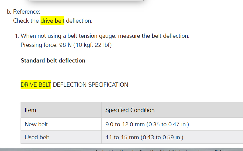

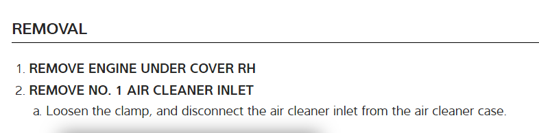

I have included step by step factory instructions for replacing your vehicle's serpentine belt in the diagrams down below. I have also included the proper spark plug gap for you as well. As far as parts I would recommend getting Original Equipment (Toyota) parts for your vehicle. These can be pricey thought, so if you don't want to get Toyota parts, then for the belt I would recommend Gates or Goodyear/Continental, for the spark plugs I would recommend NGK or Autolite. I have also included a link below for you to go to.
