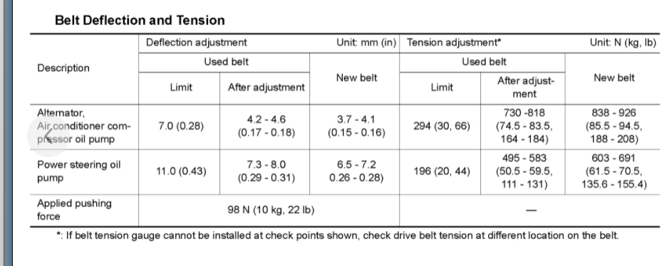

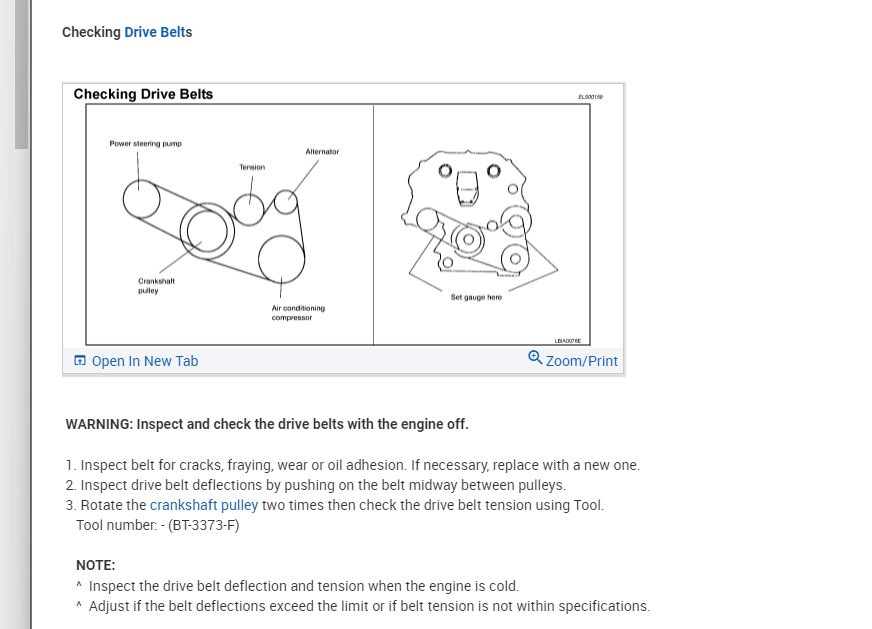

I am attaching some info on this process of checking the belt as others may need that. Clearly that will not help with removing the bolt on this vehicle, but that process is going to be trial and error. So, let's start by getting a picture of it and we can come up with some ideas.
