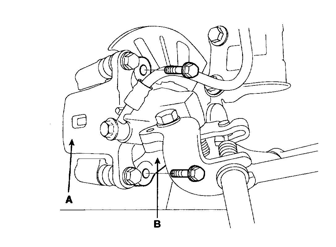

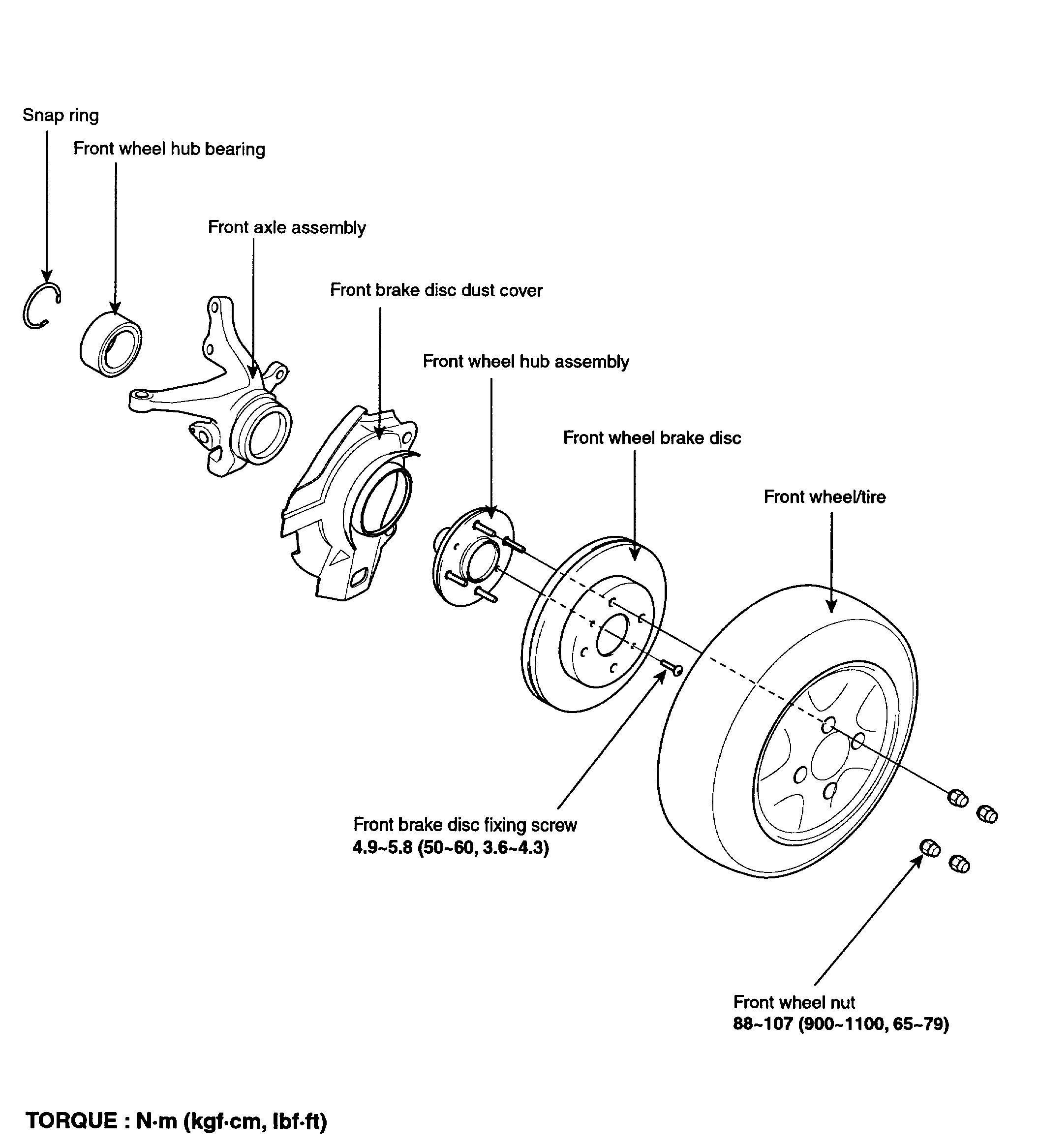

I know I need bearings how many do I have to buy.
Jan 6, 2020 at 1:44 AM
  • 110,248 POSTS

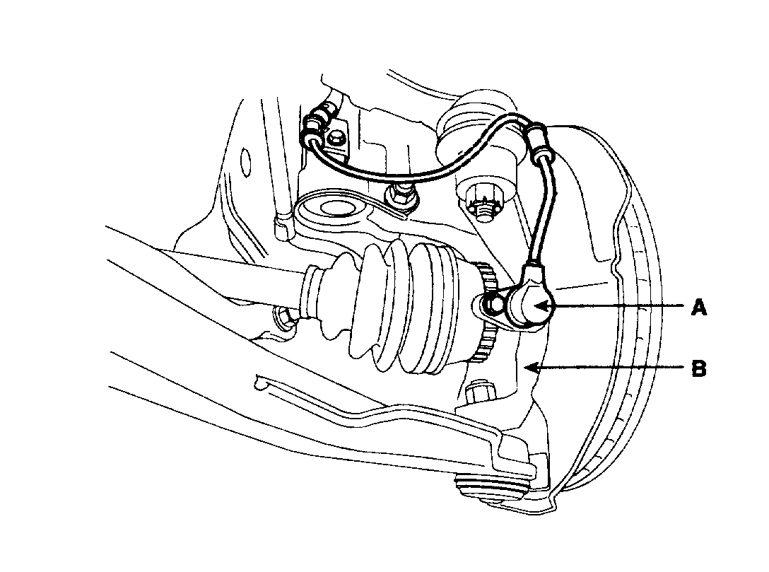

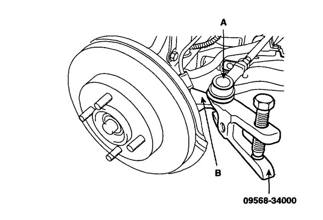

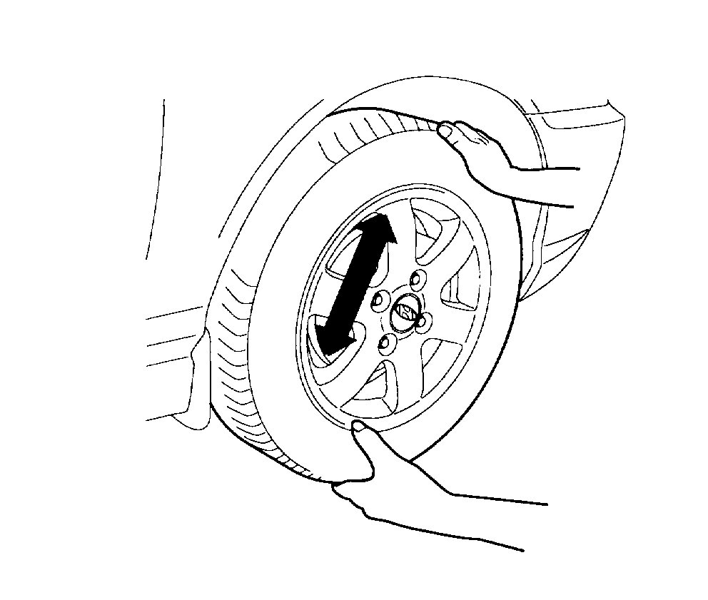

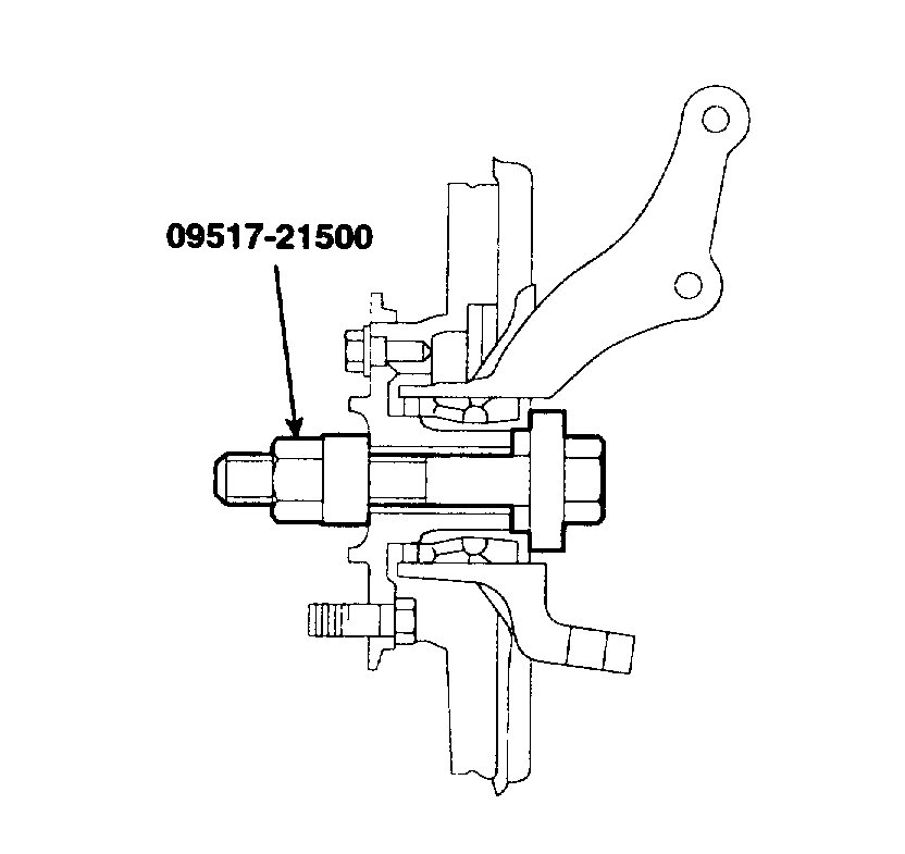

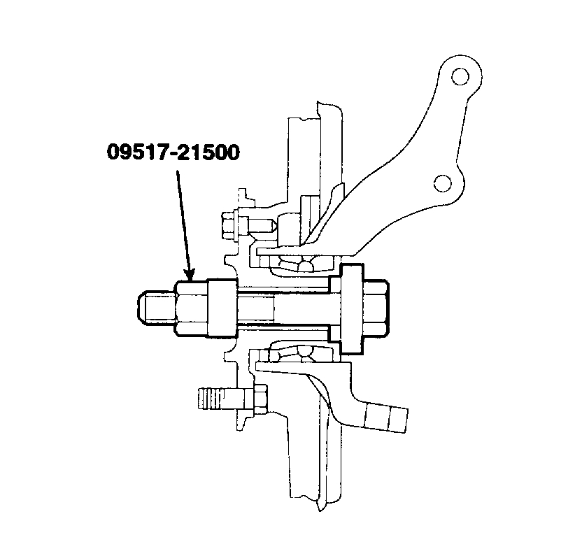

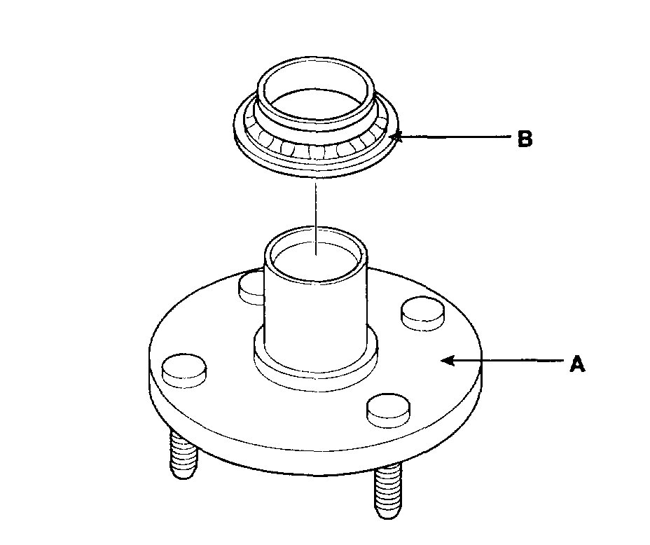

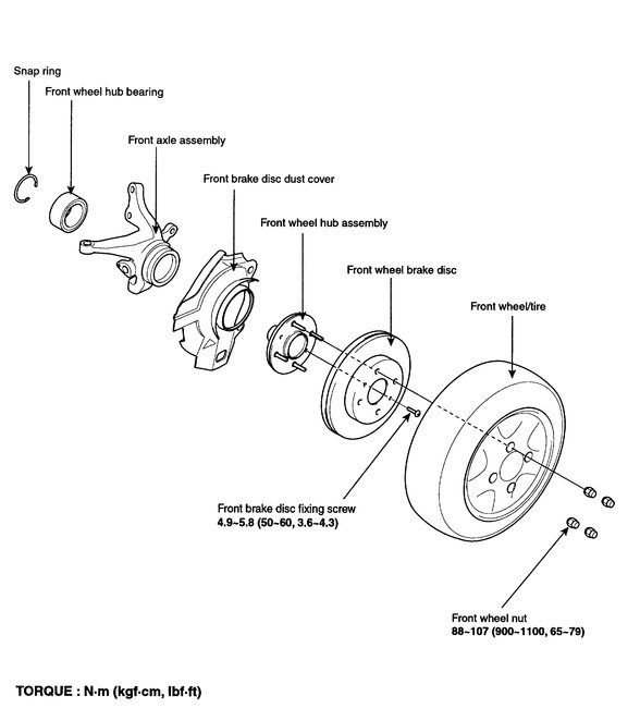

If it only the one side, there is 1. The replacement process is somewhat involved. Here are the directions. The attached pics correlate with the directions.

3. Remove the caliper(A) from the knuckle(B) and hang the caliper(A) on the front damper(C) with wire(D).

4. Remove the wheel speed sensor(A) from the knuckle(B).

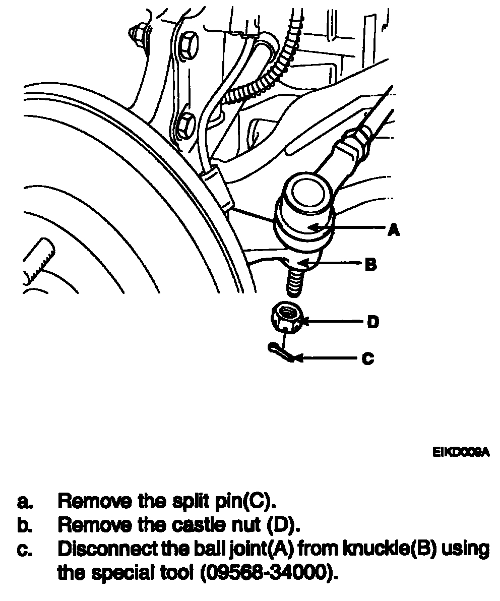

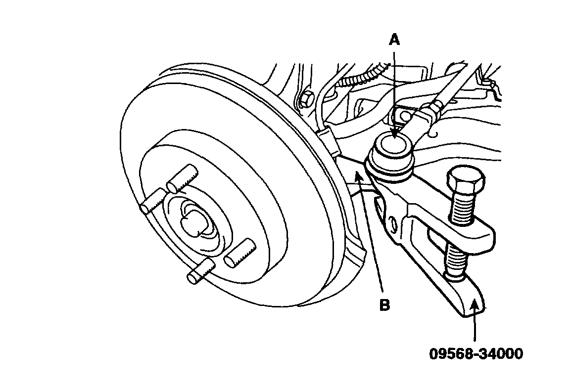

5. Disconnect the tie rod end ball joint(A) from the knuckle(B) using the special tool(09568-34000).
CAUTION: Be sure to tie the special tool (09568-34000) to the near part with cord not to fall.

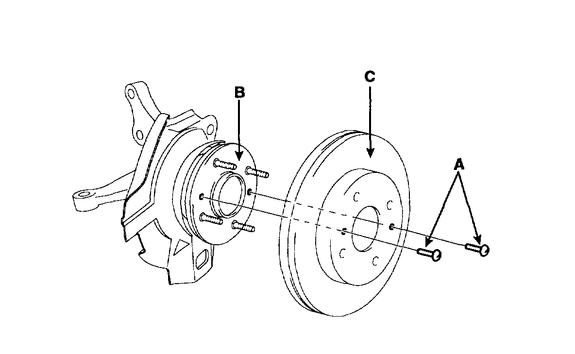

1. After removing the fixed screws(A) mounting the brake disc(C), remove the brake disc(C) from the hub(B).
pic 8

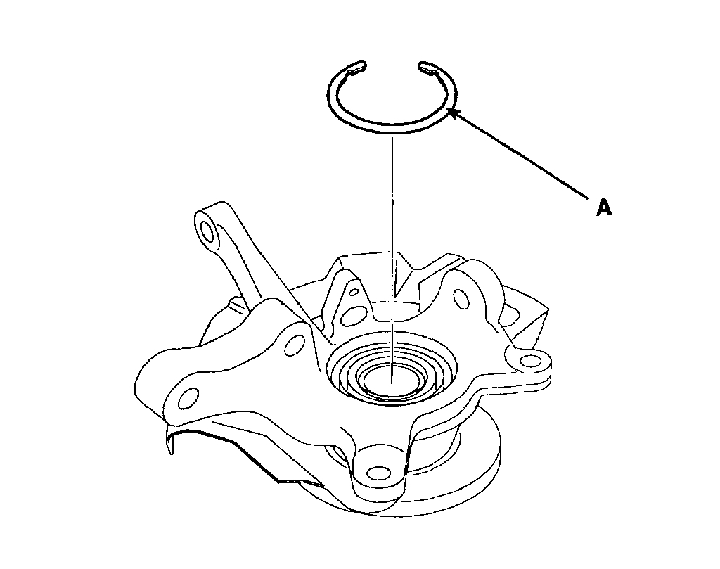

2. Remove the snap ring(A).
pic 9

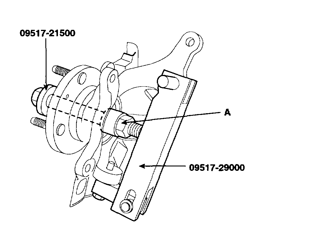

3. Install the special tools (09517-29000, 09517-21500) as shown in illustration.
4. Separate the hub from the knuckle by turning nut(A) of the special tool (09517-21500).
5. Remove the special tools (09517-21500, 09517-29000) and dust cover.

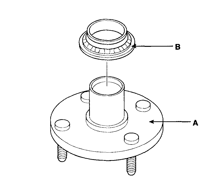

6. Remove the bearing inner race(B) from the hub(A) using the special tool (09495-33000).

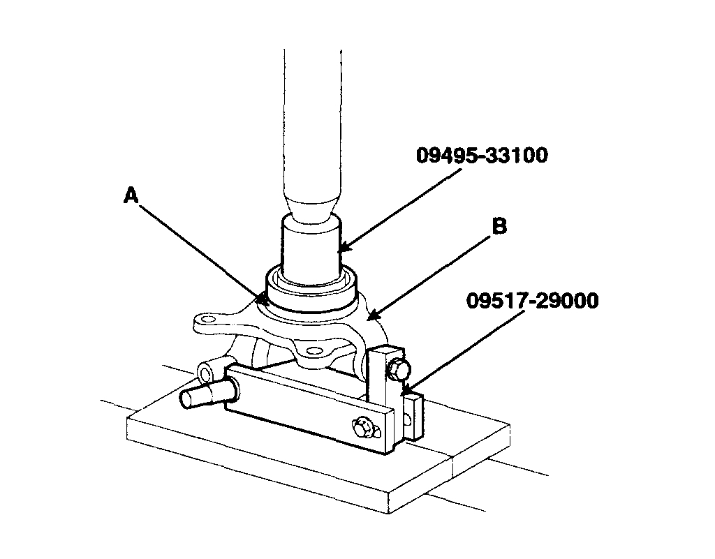

7. Using the special tools (09495-33100, 09517-29000), remove the wheel bearing outer race(A) from the knuckle(B).
8. Using a plastic hammer, remove the dust cover from the knuckle.

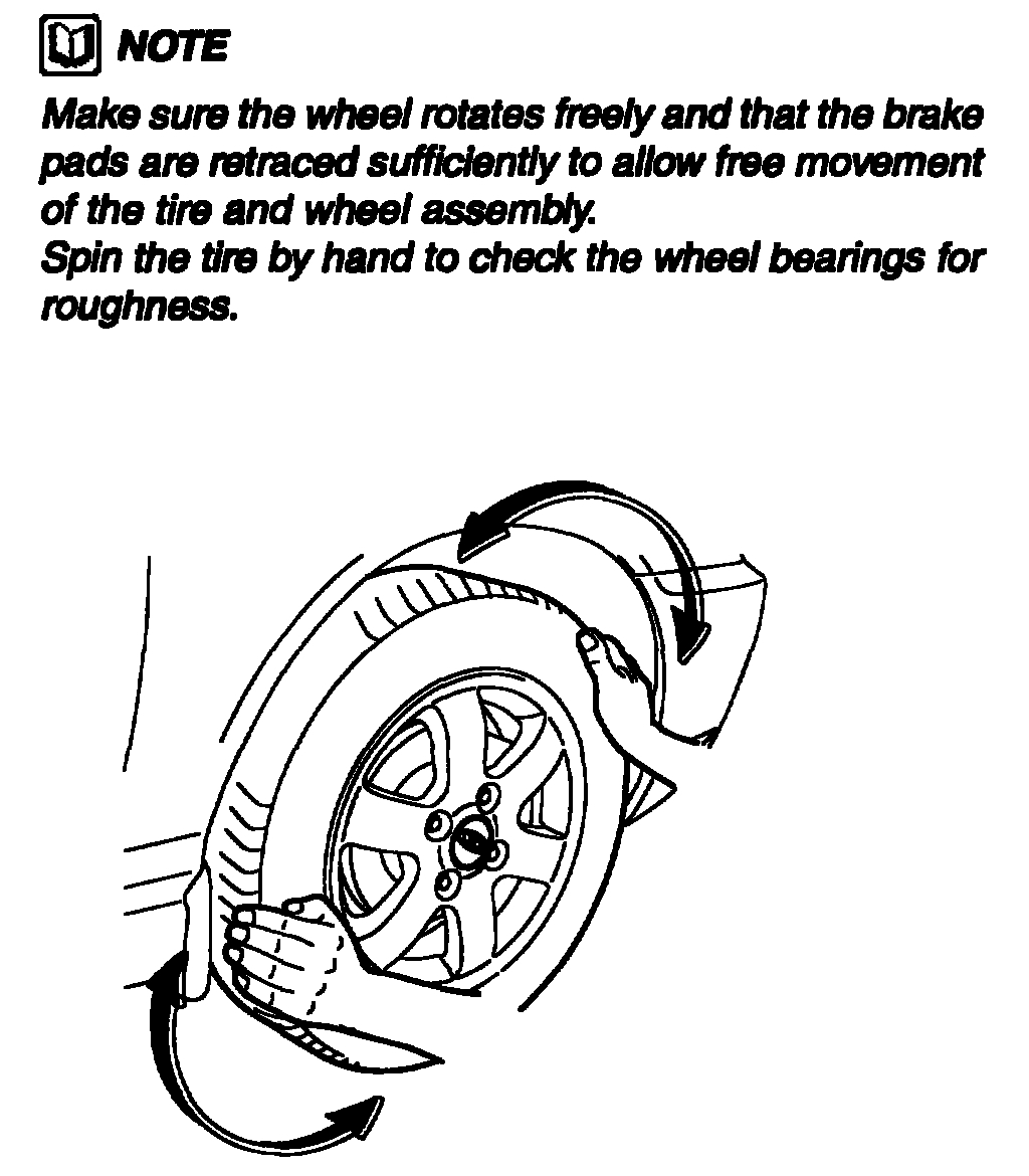

1. Raise the vehicle until the front tires are off the floor.
Make sure the wheels are in a straight forward position.
pic 13
2. Grip each front tire at the top and bottom, and move the wheel inward and outward while lifting the weight of the tire off the front wheel bearings.
3. If the tire and wheel (hub) is loose on the spindle, does not rotate freely, or has a rough feeling when spun, carry out one of the following.

REASSEMBLY
1. Apply multi-purpose grease to the contacting surface of the knuckle hub and bearing thinly.
pic 14

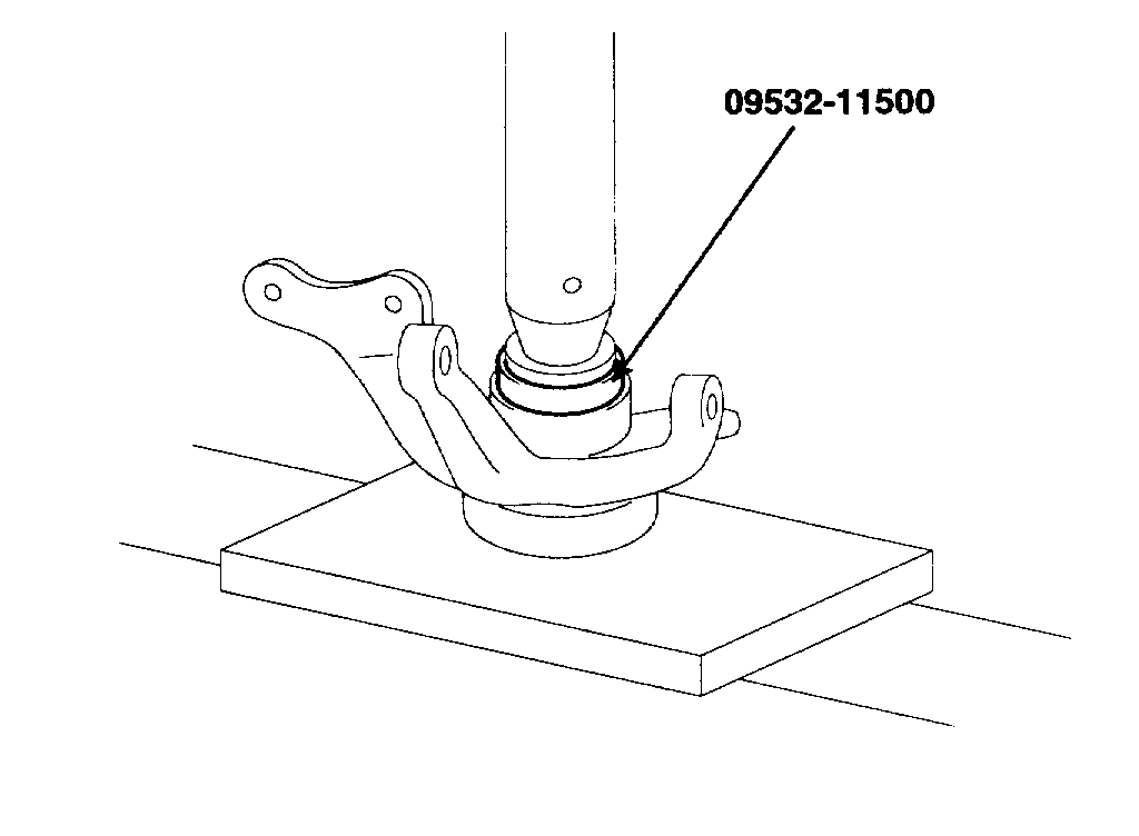

2. Using the Special Tool (09532-11500), press-in the bearing to the knuckle.
NOTE:
^ Press-in the outer race of the wheel bearing to prevent damage to the bearing assembly.
^ When installing a bearing assembly, always use a new one.
^ The right and the left bearing must be made in the same company.
3. Using a plastic hammer, install the snap ring and dust cover.
4. Using the Special Tool (09517-21500), press-in the hub to the knuckle.
NOTE: Press-in the inner race of the wheel bearing to prevent damage to the bearing assembly.
5. Install the brake disc.
pic 15

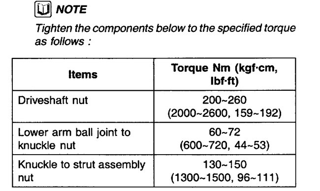

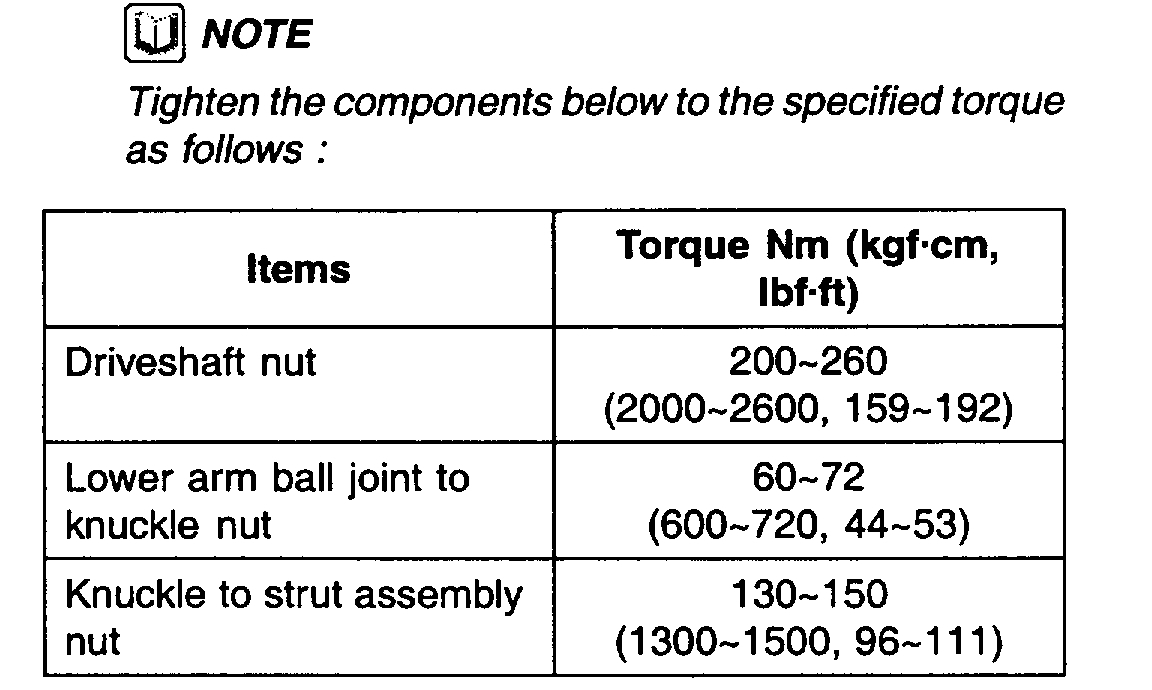

6. Tighten the hub and the knuckle to the specified torque using the Special Tool (09517-21500).
Specified torque Nm (kgf-cm, ft. lbs.) 200 - 260 (2000 - 2600, 159 - 192)

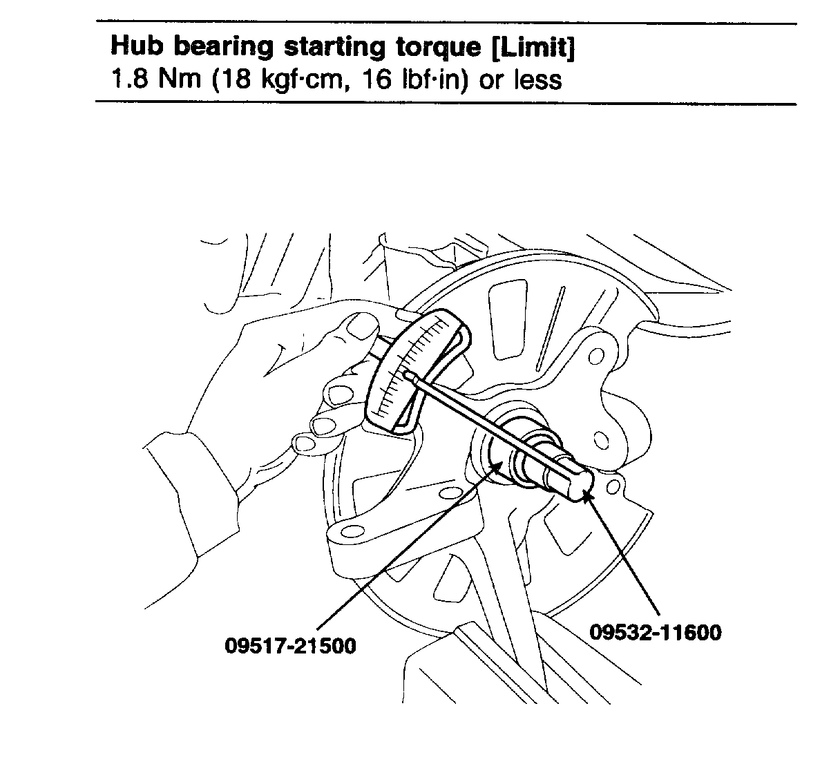

7. Measure the hub bearing starting torque.
Hub bearing starting torque [Limit 1.8 Nm (18 kgf-cm, 16 inch lbs.) or less

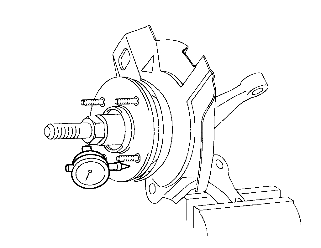

8. If the starting torque is 0 Ncm (0 inch lbs.), measure the hub bearing axial play.
9. If the hub axial play exceeds the limit while the nut is tightened to 200 - 260 Nm (2000 - 2600 kgf-cm, 159 - 192 ft. lbs.), the bearing, hub and knuckle are not installed correctly. Repeat the disassembly and assembly procedure.
Hub bearing axial play [Limit] 0.008 mm (0.0003 inch) or less

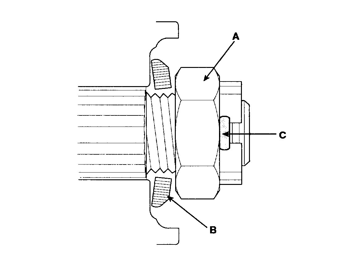

6. Tighten the tie rod end ball joint nut and insert the split pin(C).
7. Insert the washer(B) and tighten the castle nut(A).
pic 19
8. Insert the split pin(C).
