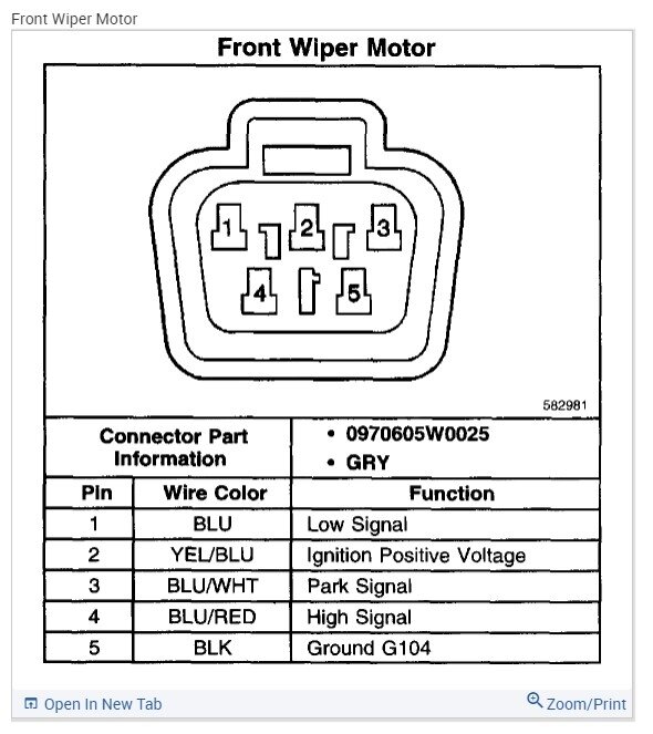

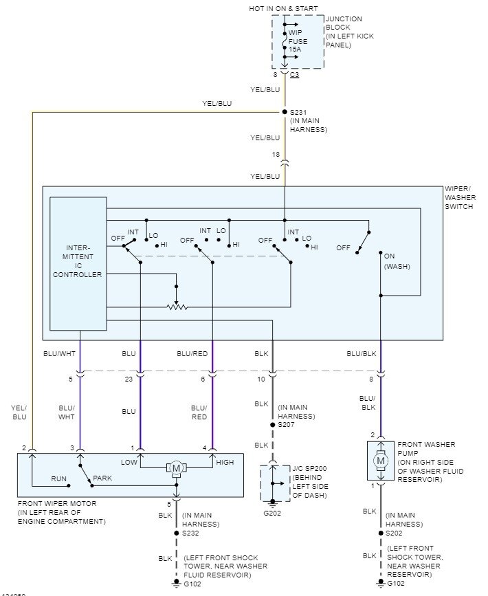

Okay, thanks for your reply! I have a follow up question concerning the same 2001 Chevy Tracker. Changing out the existing steering column for one from a a ZR2 Tracker that has tilt and sequential wipers. Will the sequential wipers automatically work since I don’t have a BCM? The existing column only had 2 speed wipers.

Well, looking at the service info it shows that they have the intermittent wipers stock. So, in theory they might. They show the connector as 5 pins, if you have that connector and those colors the switch should give you the intermittent wipers.
