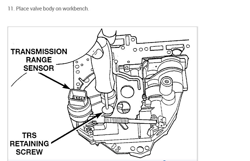

Vehicle runs fine, but suddenly won't start yesterday. Battery is 100% but there no crank. Whenever you turn the ignition to start, you will hear click sound in the relay module underneath the dashboard. A tower was able to start it though when he put the gear on neutral, pushed it forward a bit, then backward, and started to start it, and it started in one try. When I drove the van home, I turned the engine off and tried to re-start the engine, the same thing happened, seems like there's no contact in the ignition switch to start the engine, but the relays make a click sound each time the ignition switch is turned to start the engine.
Please advise.
Rey
Sunday, September 8th, 2019 AT 2:14 PM
16 Replies
SCGRANTURISMO
  • 4,897 POSTS

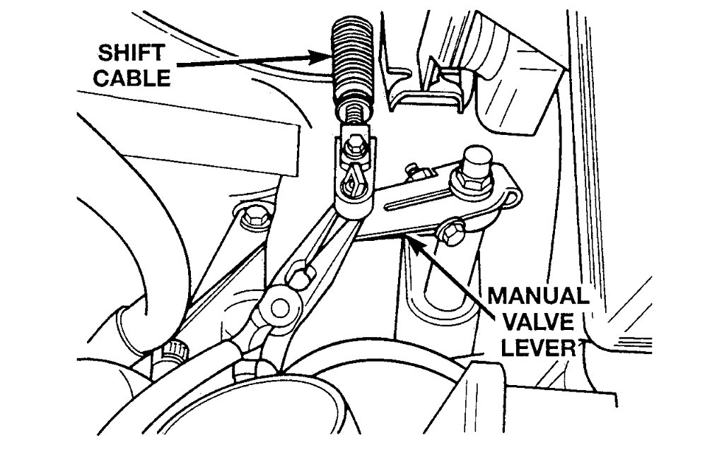

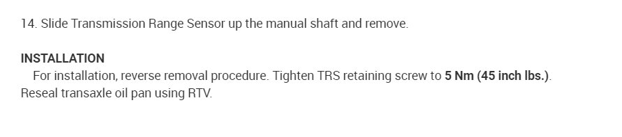

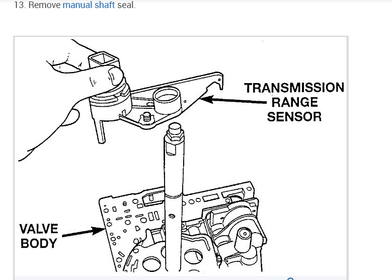

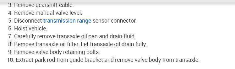

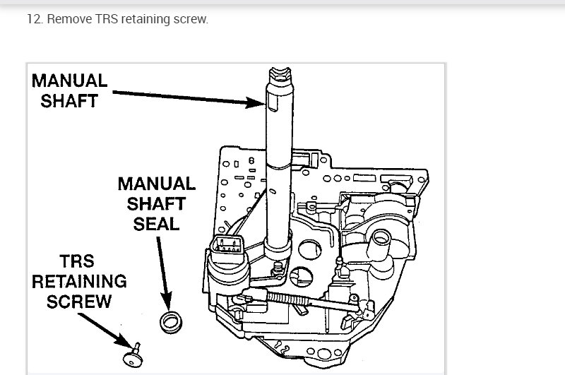

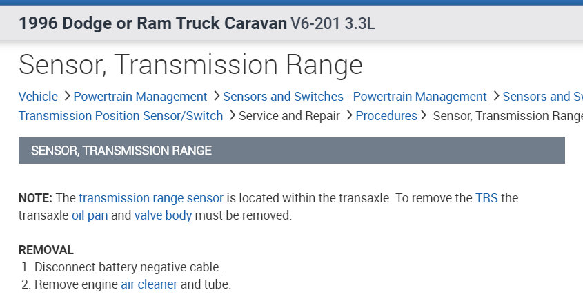

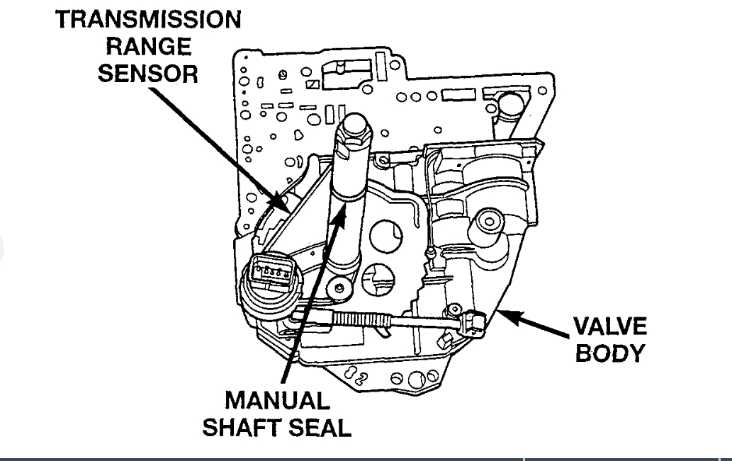

This sounds like a problem with your vehicle's neutral safety switch. This is the switch that inhibits the starting circuit if your vehicle transmission range selector is in any position other than park or neutral. In the diagrams down below I have included the factory guide for the removal and installation of the Transmission Range Selector, which is what the neutral safety switch is called on your vehicle. Please go through this guide and get back to us with how everything turns out.
This guide can help as well.

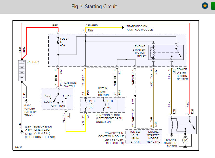

For your information, I was able to start the engine this morning by hot-wiring the pins (on starter relay mounting in the engine compartment power center box) corresponding to the #30 and #87 pins on the starter relay, and the starter works great with just one click.
Does this mean that the ignition switch is faulty?

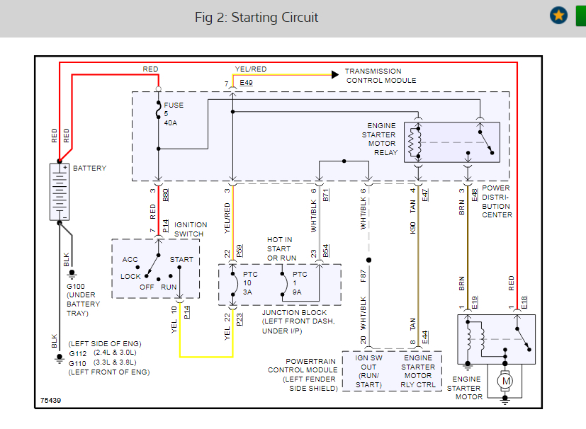

Yes it does. It could also be circuit breaker PTC 10 which is located under the left front of the dash. Check this first and if it still doesn't start then the problem is going to be the ignition switch or the wiring from the battery to the relay. I have included a wiring diagram of your vehicle's starting circuit for reference in the diagrams down below. Please get back to us with what you are able to find out.

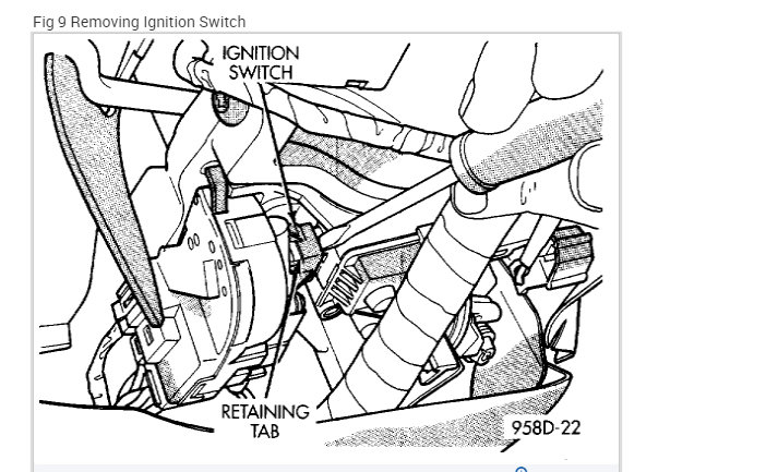

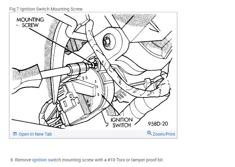

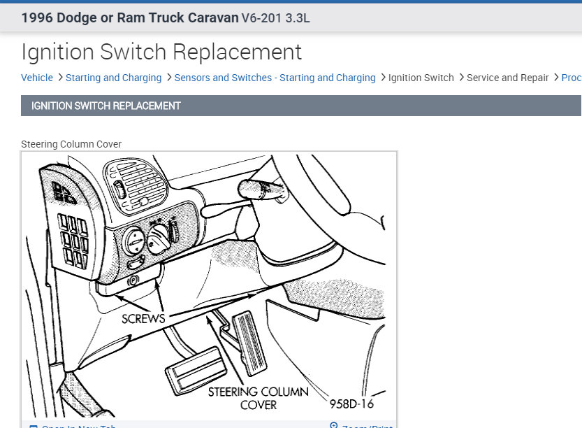

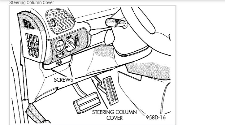

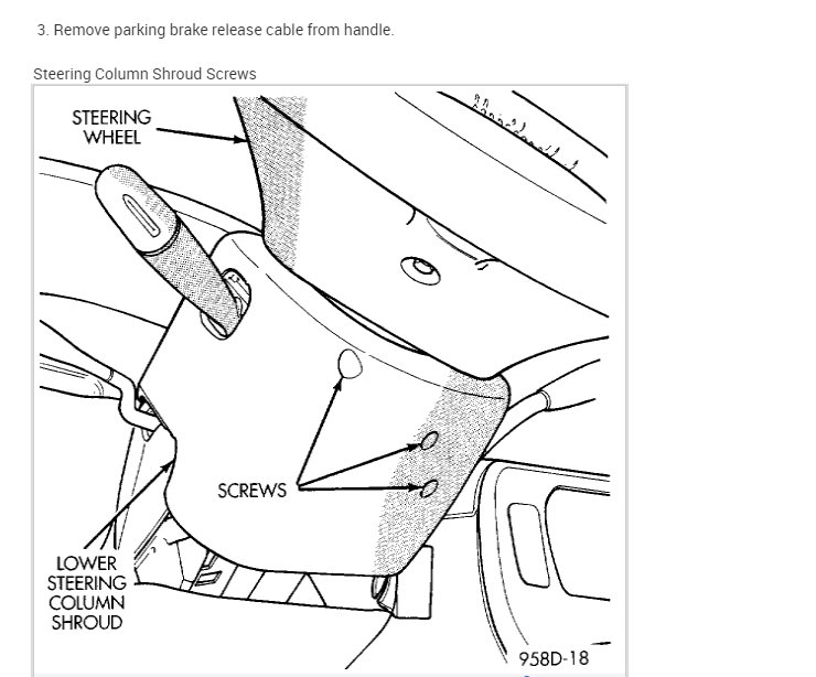

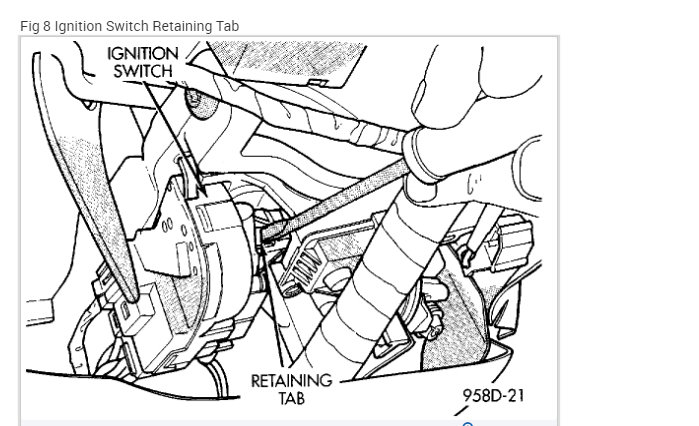

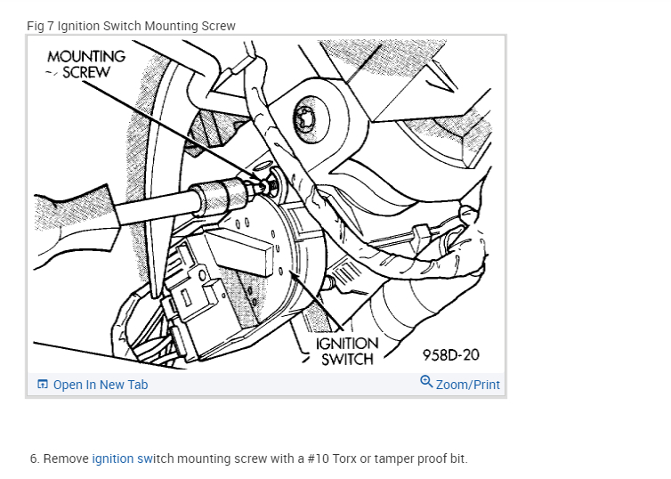

Okay, so the problem is going to be the switched power supply to the relay(Ignition Switch) or the ground from Pin 85 of the relay is bad. But since we have already established that the ignition switch is bad, this is going to be the problem. Would you like step by step instructions on how to remove and install a new ignition switch in your vehicle?
Thanks,
Alex
2CarPros
+1
Monday, October 7th, 2019 AT 9:26 PM
REDCRU777
  • 81 POSTS
Thanks for this reply Alex.
Yes please, I would highly appreciate if you can provide me the instruction on how to replace the ignition switch specific to 1996 Grand Caravan.
Thanks a lot.
Rey
+1
Tuesday, October 8th, 2019 AT 7:56 AM
SCGRANTURISMO
  • 4,897 POSTS

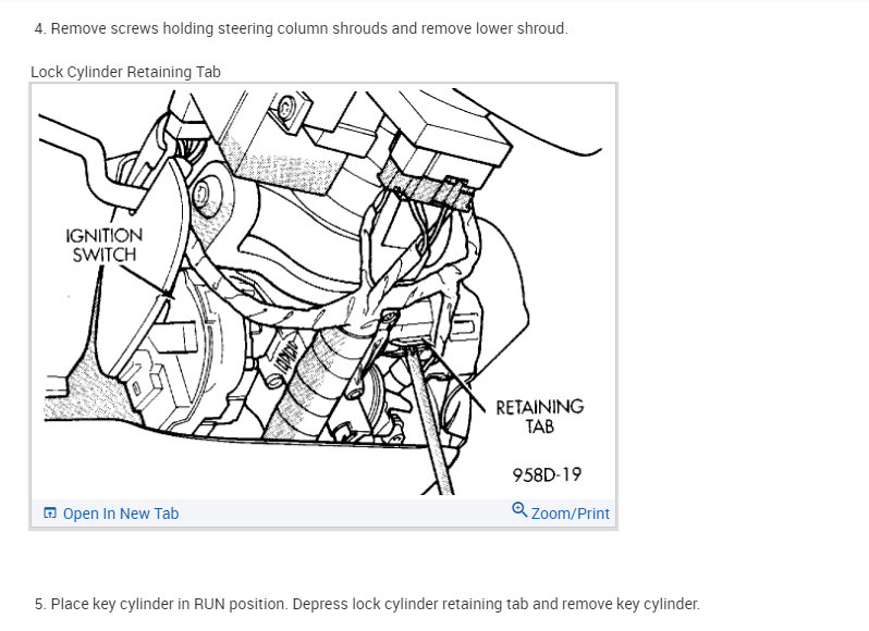

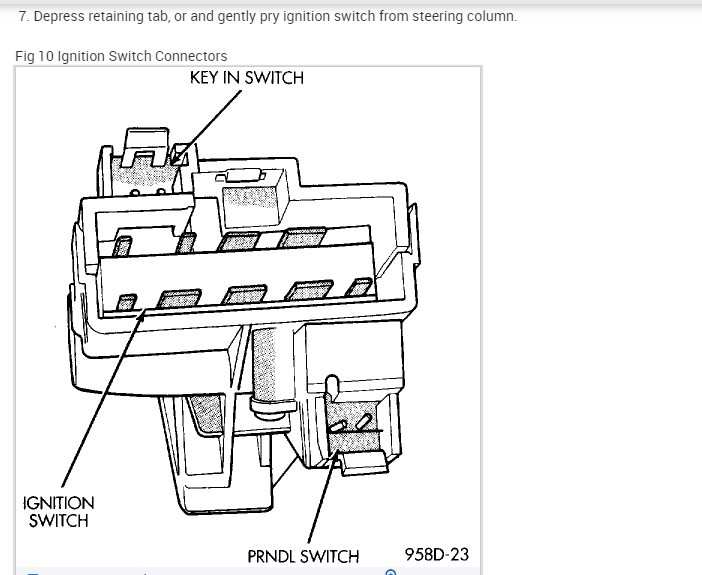

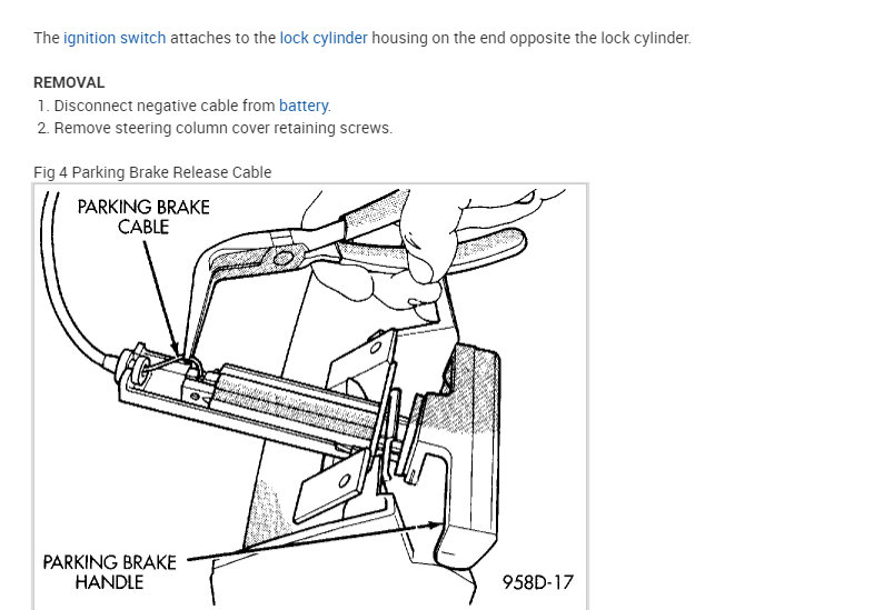

Okay, I have included the directions in the diagrams down below. Please go through them and get back to us with how everything turns out.

REDCRU777
  • 81 POSTS
Hi Alex,
Just an update, I got the starter, it fixed it.
Many thanks for all the support!
