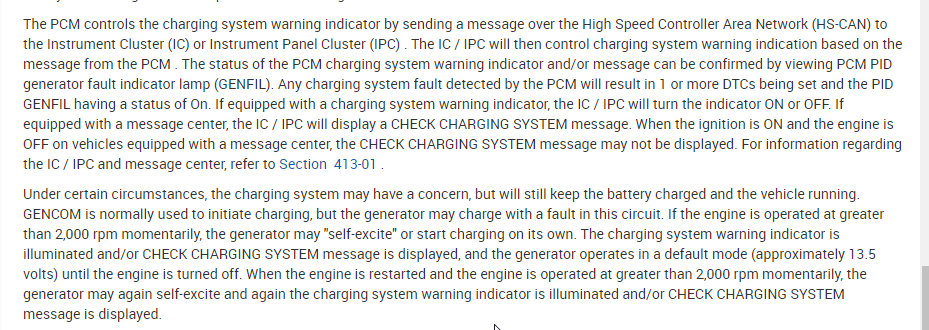

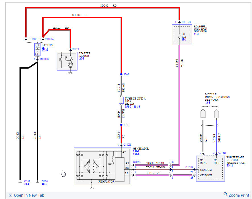

Battery light came on and the battery tested bad so I had it replaced. I was good for a few days and then the battery light came on again so I had the alternator tested and it was bad, had that replaced (remanufactured). While the alternator was being replaced they noticed the ground wire was corroded and the power wire from the alternator to the battery was too hot to even touch. Both wires were replaced. The alternator fuse was checked and it's good. Battery light is still on. When returning the core, I had the new alternator and battery tested and both were good. Voltage output over 14. What do I check from here? I've seen where it could be related to the PCM. Is there any way to test that? Are there any codes that should have been cleared after the repair?

Yes. This could be a PCM issue but normally that is due to the voltage regulator is internal to the PCM. However your voltage regulator is on the generator. So that means it is being told what to do by the PCM but the regulator in the generator.
Here are some guides that help with the proper testing that we need to do for the battery and generator:
If this is what was done and they both passed but we had hot wiring then I suspect we have more wiring issues to the PCM from the voltage regulator or the PCM itself if the issue.
Take a look at the info below that will help with this. Specifically we need to find out if there are codes. If we have some codes then we can figure out why the light is on.
Let me know what questions you have. Thanks

Yes. There can still be codes even though the check engine light is not on. Most codes will trigger the check engine light but there are others such as voltage issue codes like this that would not turn it on.
As for the RPMs being high could be normal but I think that supports this as the PCM will raise the RPM when it sees the voltage is too low.
So I suspect we have a PCM issue but let's start with codes and go from there. Thanks
