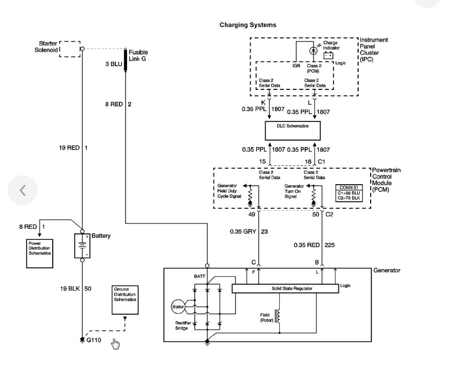

Hi, I don't know if it would make a difference but it's from Canada. So the battery light came on a couple weeks ago and the car shut off on me. I bought a brand new alternator (the one I took off I put on a week before from a salvage yard) still nothing later in the day I noticed the wire from the alternator to the starter was off. I put a new end on it and fixed it and still nothing. I even tried putting an additional wire on the stud on the starter and going straight to my battery and still wouldn't charge it. The plug on the alternator has a red wire and a grey one the red wire lights up the test light and the grey one won't. The schematic shows that the grey wire goes to my computer. My buddy thinks the computer is bad but I have no clue at this point. Any help with this would be amazing. Thank you

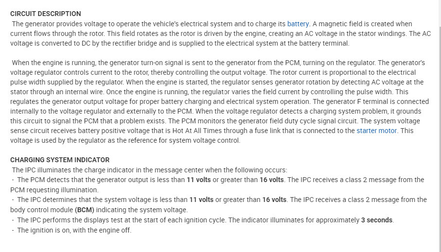

Take a look at the attached documents.
The PCM is responsible for turning the generator on and off. This is done through the smaller red wire on the generator. The grey wire is the duty cycle that the PCM monitors. It is only grounded when there is an issue. So I would not think this is your issue.

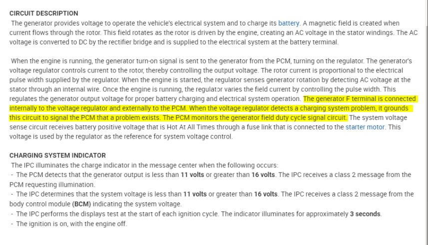

Okay. Per the service information (highlighted in attached) the grey wire is only grounded when the voltage regulator detects a problem. Otherwise the circuit is not grounded so there should be no voltage coming from it to the PCM.
