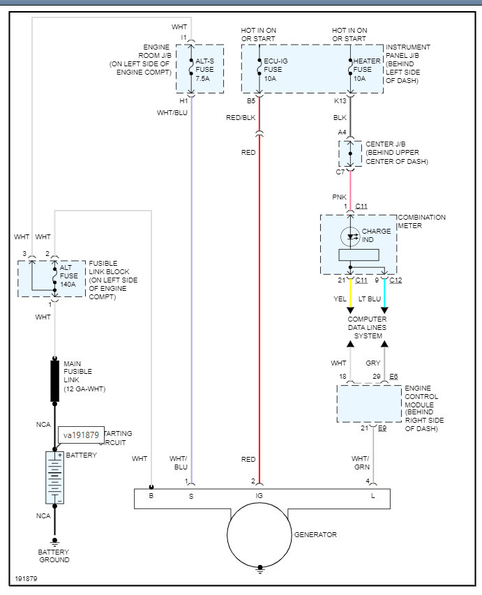

My battery light is intermittently coming on even after replacing my alternator and battery. They both were tested as bad and that's when I decided to replace them. I noticed that my new alternator is charging at 13.75v even with my headlights and radio on. Is that normal? The car starts up and runs fine but the battery light just keeps coming on. I tested the alternator at advance auto before I installed, and it passed on their machine.
Nov 21, 2021 at 5:22 PM

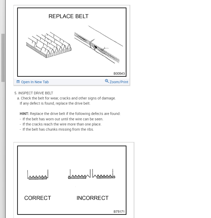

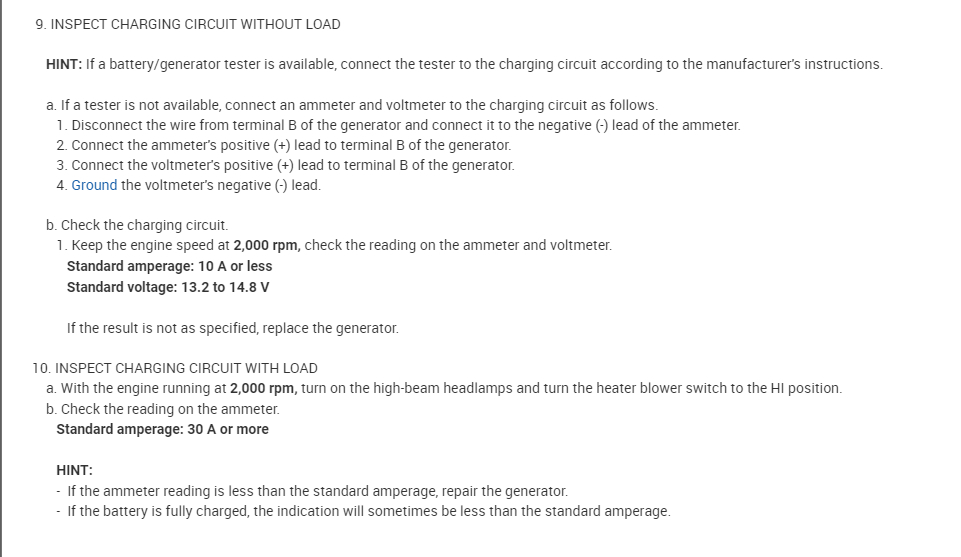

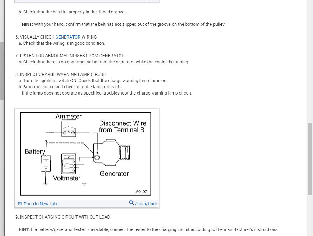

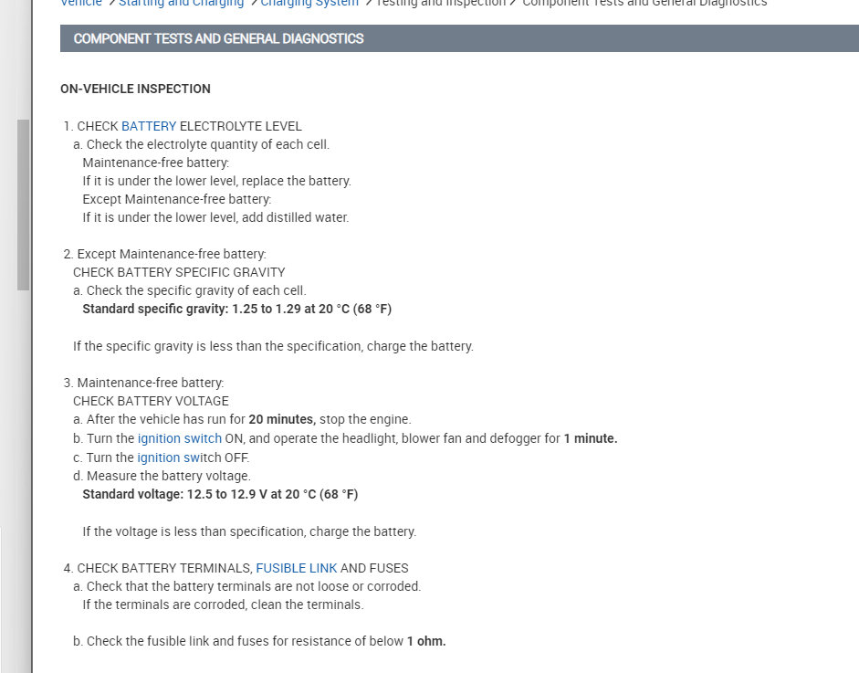

This could be a couple things, but we need to start from the basics even if you have already done them. I would stop by a parts store and have them check the battery and alternator again. If either of those are faulty then that needs to be addressed first.
If the battery and alternator are okay now, then we need to run through the testing I am attaching to make sure we are not missing something else like the belt being too loose or slipping.
Also, the voltage that it is charging is ok, but if the indicator is coming on then that means it is not reaching the level that it is being commanded.
So, let's start with this and go from there.

The 13.75 volts is your normal range. Double check your alternator fuse to verify it has not gone open circuit. Make sure your belt is not losoe or slipping. And as KASEKENNY1 pointed out, have the charging system checked once more.
I have seen some aftermarket alternators cause the battery light to remain on. You may need to replace it once more. Keep us posted after your checks.

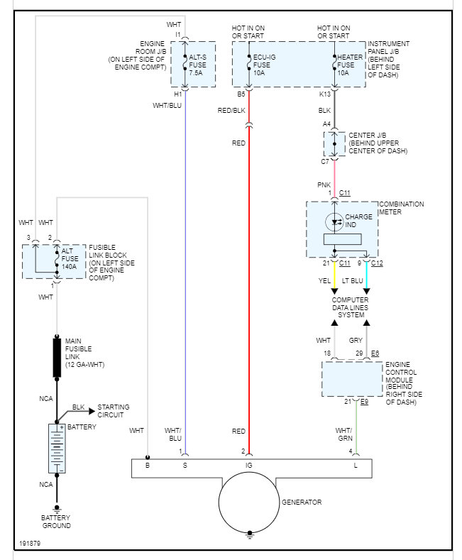

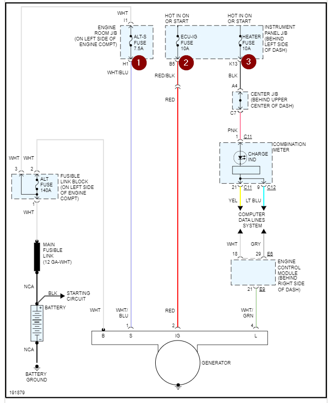

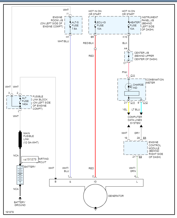

KASEKENNY1 has provided the wiring diagrams with the fuses already. In the engine bay fuse check the alt fuse 7.5A and on driver lower part of dash is the ECU-IGN fuse 10A and heater fuse 10A. Let us know how those fuses look.
Jan 2, 2022 at 12:20 PM
JITHIN MATHEW
  • 71 POSTS
Hello, thanks for the reply. I will take a look at it and will let you know. I was wondering, if a alternator fuse is blown then there wouldn’t be any power going to the alternator wires right? In my case, the alternator has power and it’s producing good voltage.
Jan 2, 2022 at 2:37 PM

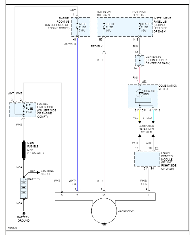

Take a look at this wiring diagram. There is a fuse for each wire going to the alternator.
So, we need to go to the alternator and check the power at each of the wires specifically, B, S, IG.
Your alternator fuse could be fine but if you don't have power on the other wires then the alternator will not work.
Jan 2, 2022 at 6:31 PM

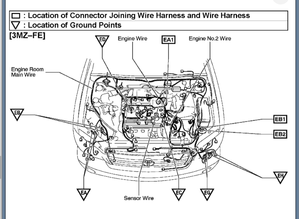

I checked all the fuses, and they are all good. I tested both the battery and alternator again and they passed the test and are producing good voltage. I heard that the EB2 connector is known to get corroded on these cars. I haven’t had a chance to look at it yet but was thinking of buying the plug ahead of time before I take it apart. I am having a difficult time finding the connector anywhere including the dealership. Any suggestions?
Mar 4, 2022 at 8:32 AM
Got it. That is correct as I have heard of that well.
I am attaching the location of it, but I have not been able to find a kit for it.
What I would consider doing is just getting an entirely new connector which means both sides of it. All you need is a 10-pin connector and then change one wire at a time to ensure you keep them straight. However, you don't have to keep the exact replacement connector if you are going to change both sides which is what you would have to do if there is corrosion.
Here is a video that will show how to cut and solder the new connector in:
https://www.youtube.com/watch?v=PxA5wczsCVo
Please let us know what you find. Thanks

I checked the EB2 connector, and it is fine. There is no corrosion inside or none of the pins are broken inside, but my battery light remains on. Other than very little buildup of the green stuff, the pins and wires looked fine. I checked the voltage and it’s usually steady at 14.06 and but sometimes will go up to 15 when all the loads are running. My guess is that the battery light is sensing wrong voltage which causes the battery light to come on. Is there a sensor for this that could be causing the problem and if so, where would that be?
Mar 12, 2022 at 4:55 PM
JIS001
  • 3,412 POSTS
If everything is checking okay, then it sounds like you will need to replace the alternator with a dealer part. But before you go that route, can you post a picture of the green stuff you see? If it is corrosion, it can affect voltage. Sometimes it is just grease from the manufacturer to prevent fretting.
