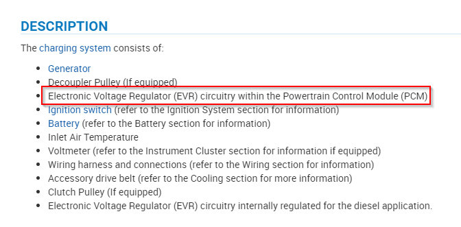

I keep getting my battery light when I drive. Went to test the battery (brand new) and mechanic said it's all good so as the alternator. I replaced the terminals as well and it has been driving well since until today. I have been having the battery light come up for the past few months now too.

If the battery and alternator are not the issue then we need to monitor the PCM data with a scan tool to see how much the PCM is turning the alternator on and off. Basically the PCM does what is called duty cycling with the alternator. This means when you need more voltage, the PCM ramps up the output from the alternator and then when it doesn't need as much it brings it down.
More then likely the PCM is the issue at this point. The other possible cause is wiring which is why we need to use a scan tool to find out what the PCM is commanding the alternator to do and go from there.

Update: My car broke down in the middle of a road and had some assistance by a good person. Popped my hood up and the terminals were kinda lose so we tightened them very tight and it ended up doing the trick.
thank you for all the help!
Aug 10, 2020 at 6:57 AM
You are welcome. This is a lesson for me to not jump over the basics. After checking the battery state of charge, checking connections is the next thing to check. Sorry I did not mention this earlier.
