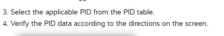

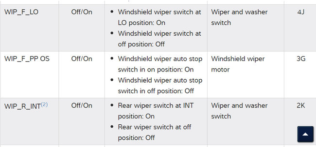

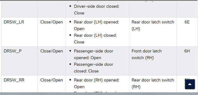

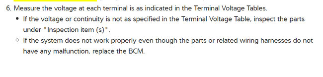

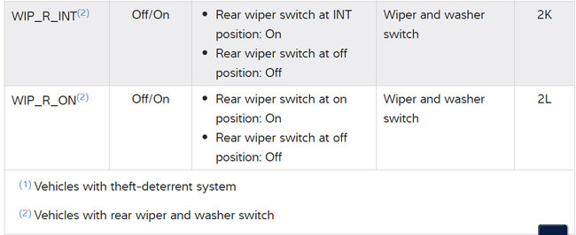

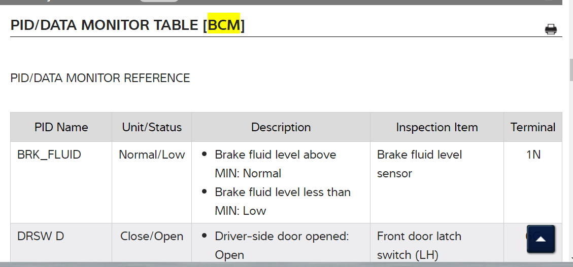

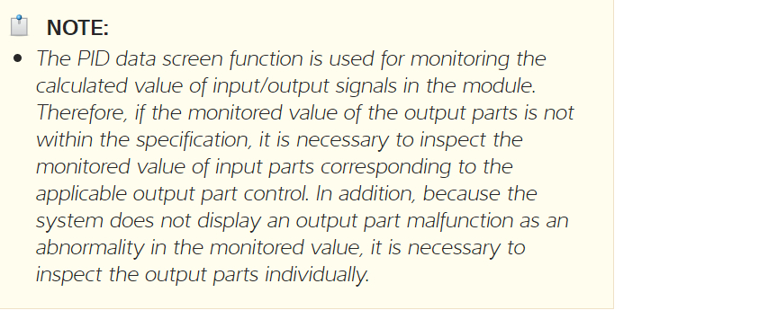

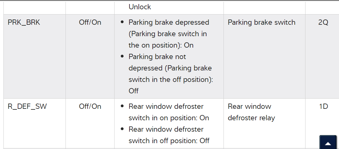

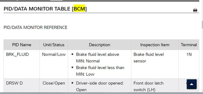

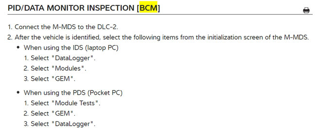

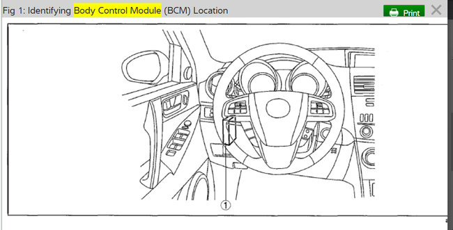

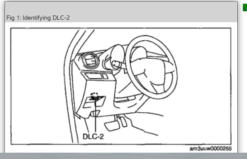

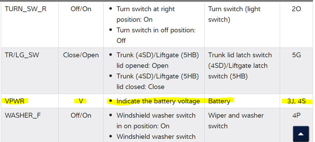

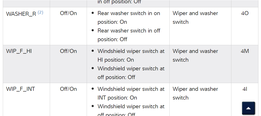

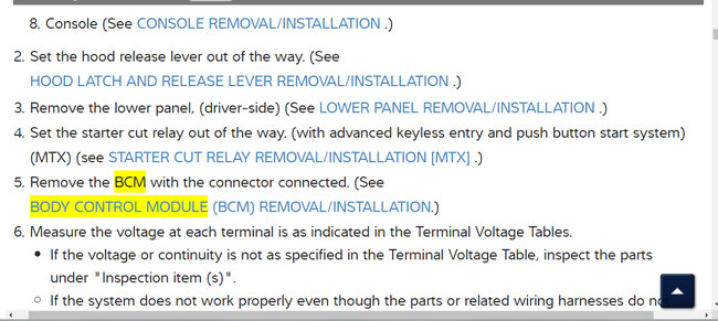

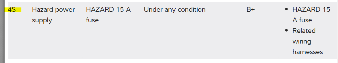

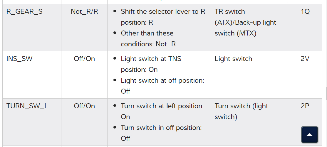

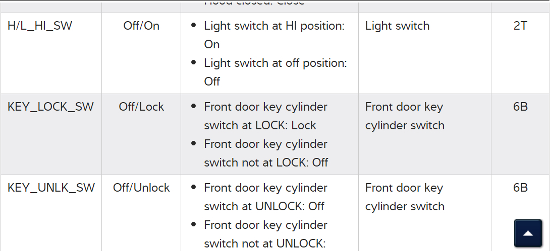

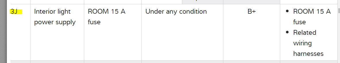

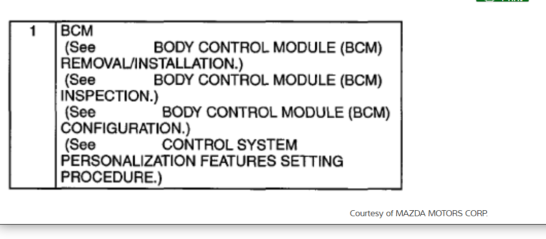

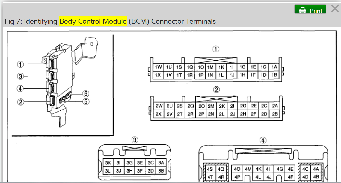

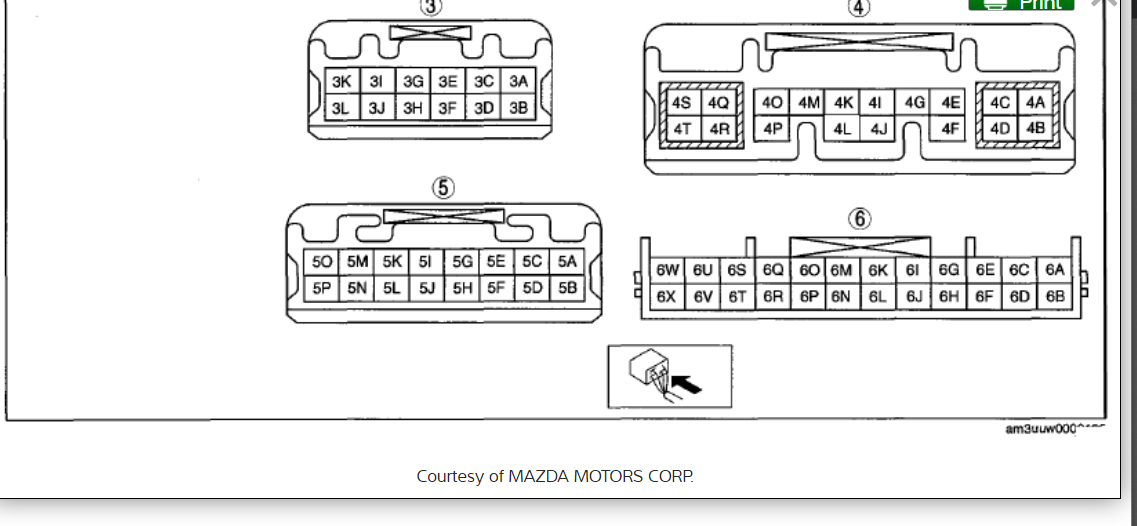

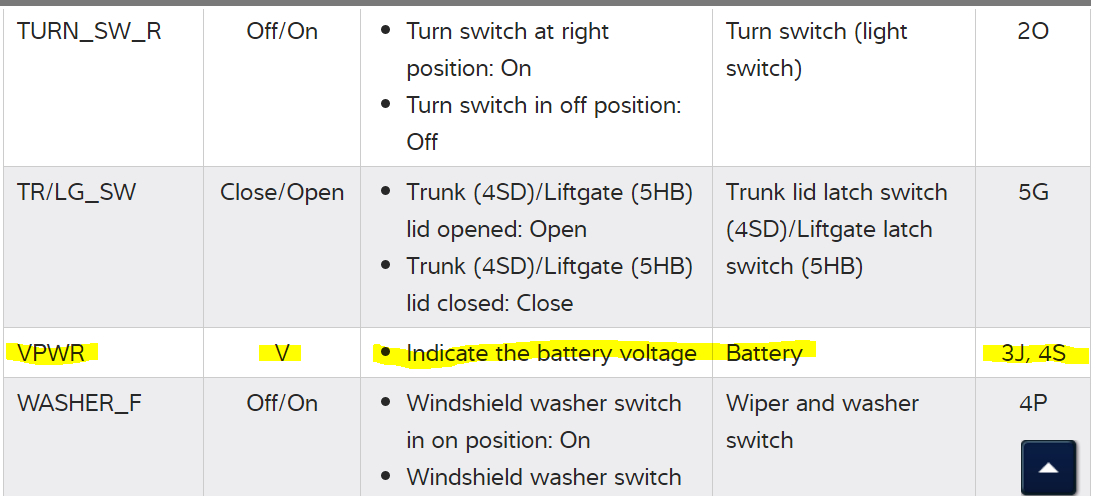

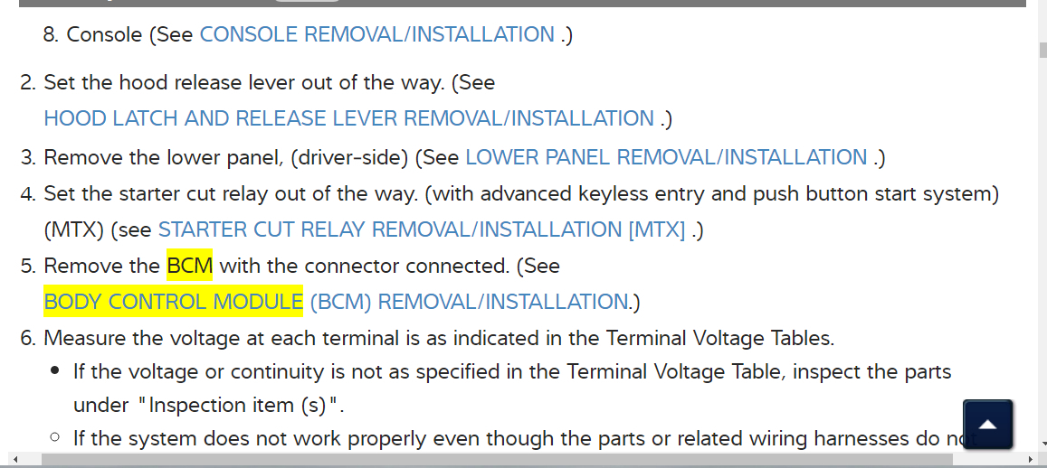

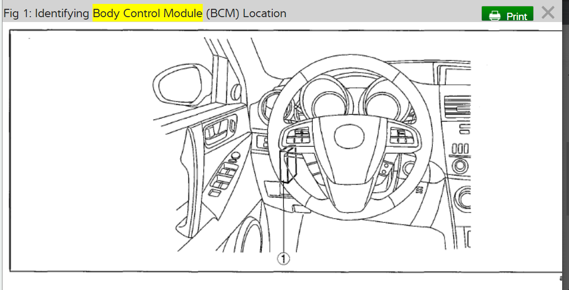

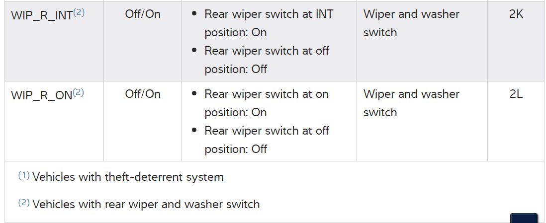

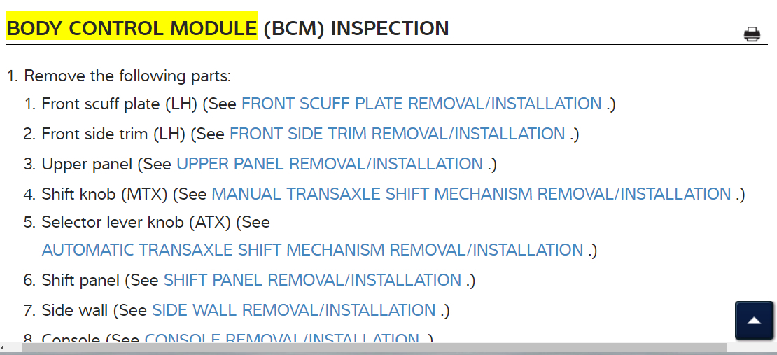

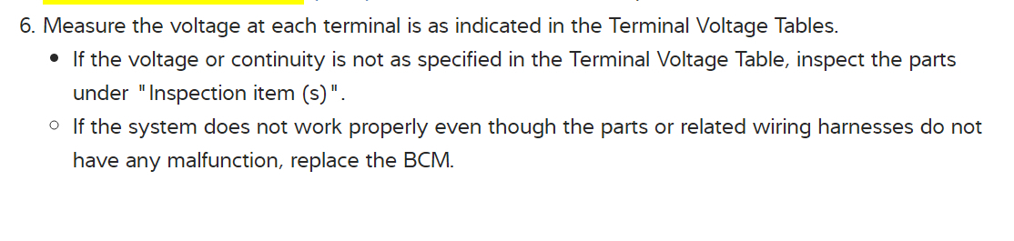

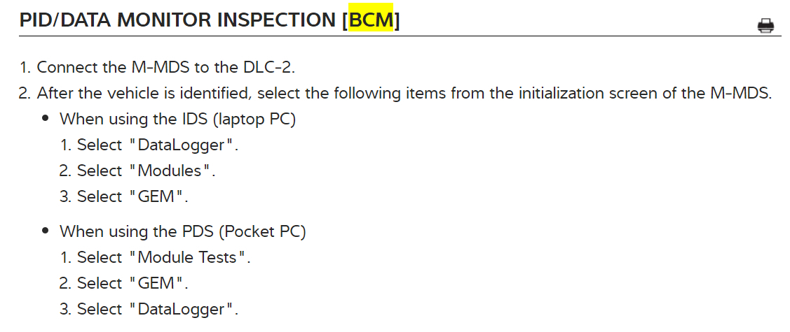

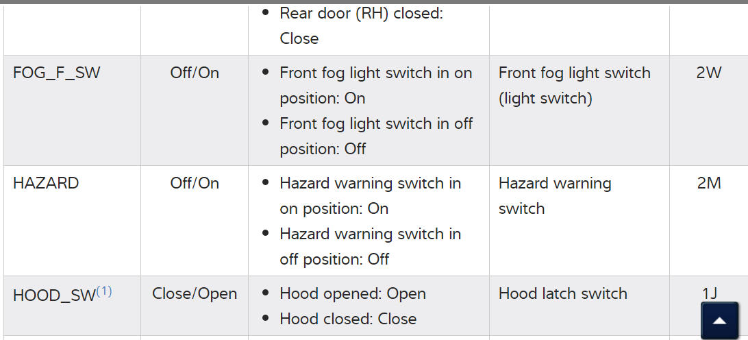

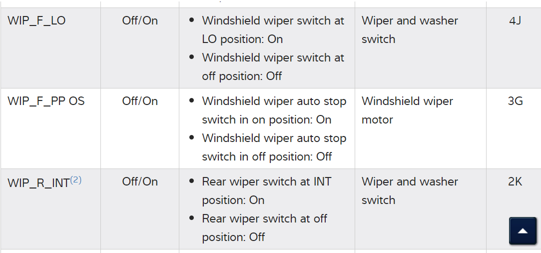

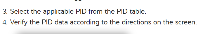

This could be a problem with your vehicle's Body Control Module (BCM). The BCM on your vehicle is what get the information from the sending unit and then either turns on your vehicle's battery warning lamp or doesn't. If this control module is failing or has an internal short, it could cause this problem. In the diagrams down below I have included a description of the BCM and how and what pins to test for the BCM. i have also included a link below for you if you are unfamiliar with how to use a multi-meter, as you will need one to do the diagnostic testing.
Please get back to us with what you are able to find out.
