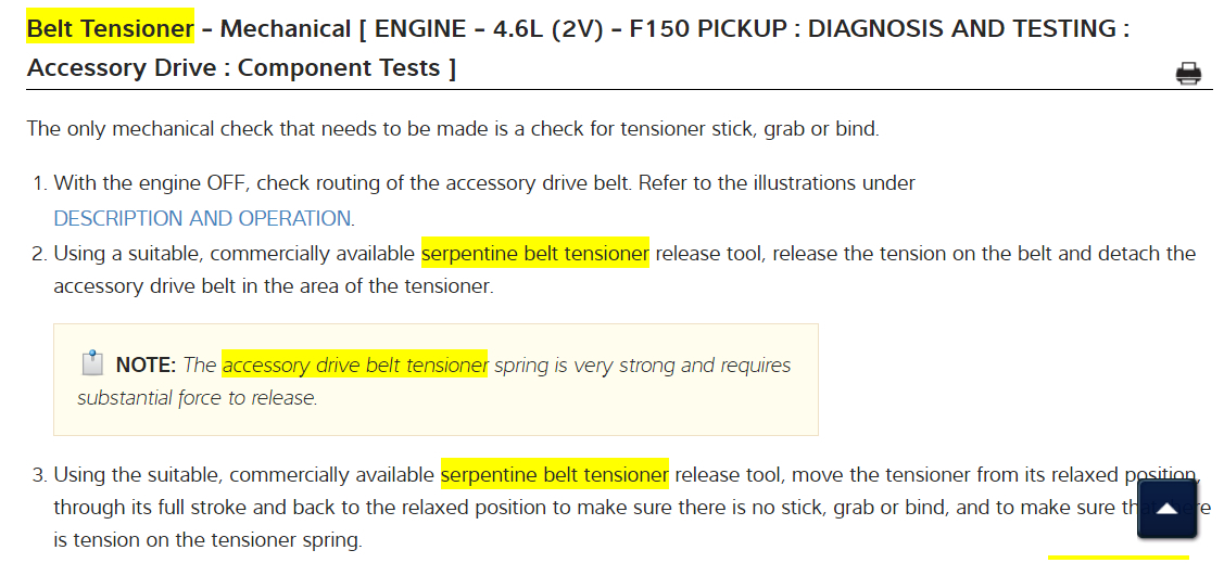

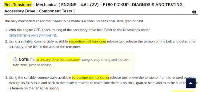

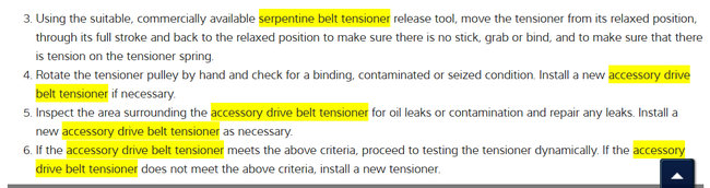

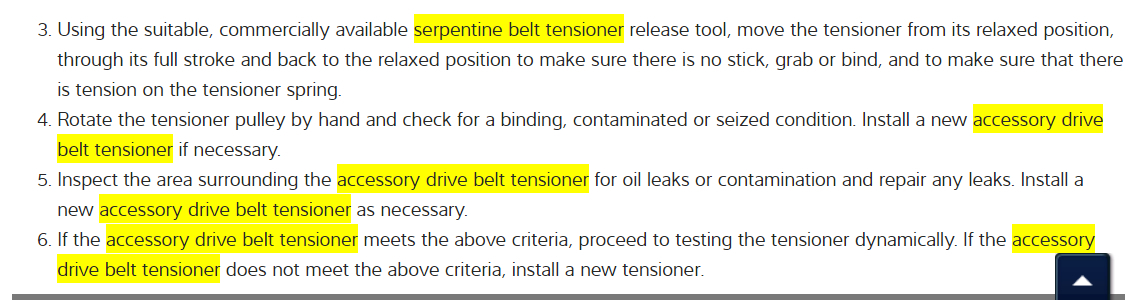

This could be a problem with the serpentine belt tensioner. If the serpentine belt is glazed, cracked, or loose because of the tensioner not holding the proper tension on it then the alternator will not spin as it should and it will have lowered current output, especially when the vehicle is at an idle. In the diagrams down below I have included a factory guide for the inspection of the serpentine belt tensioner for your vehicle. Please go through this guide and get back to us with what you find out.
Thanks,
Alex
