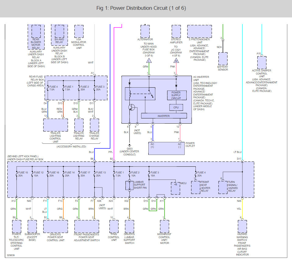

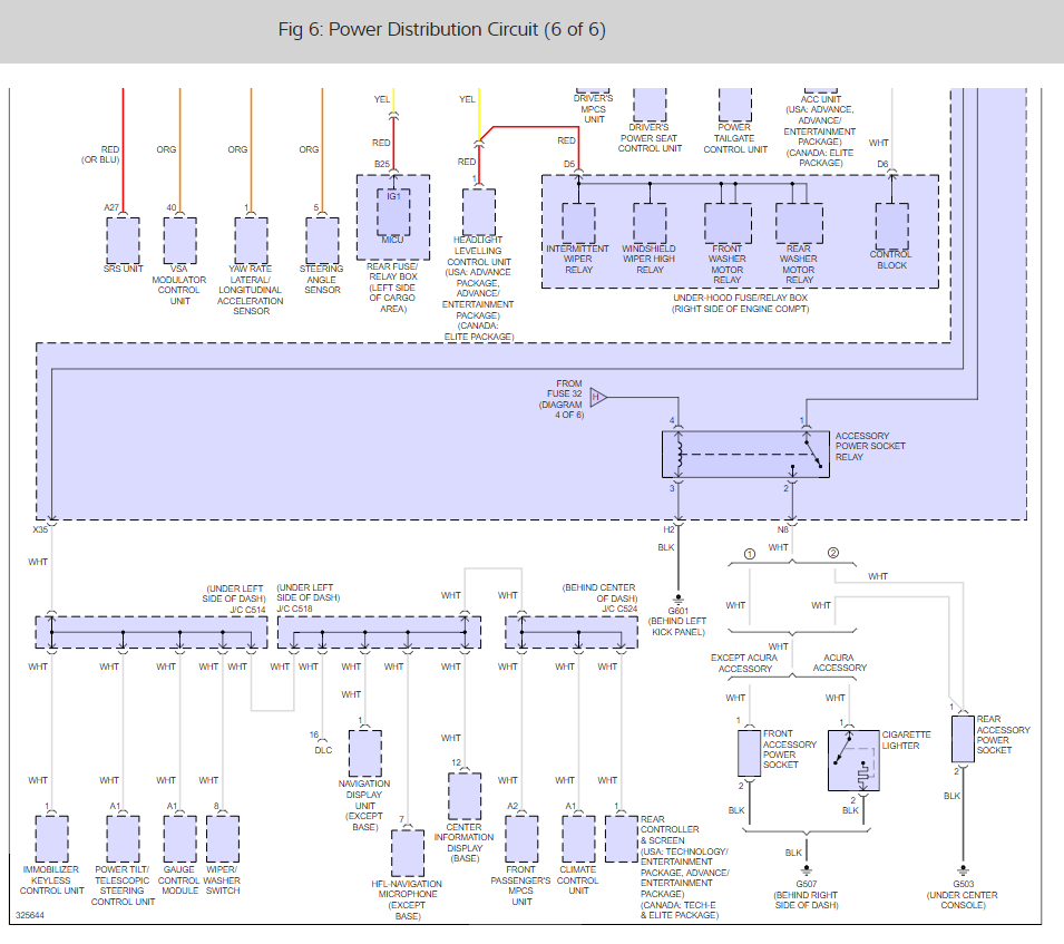

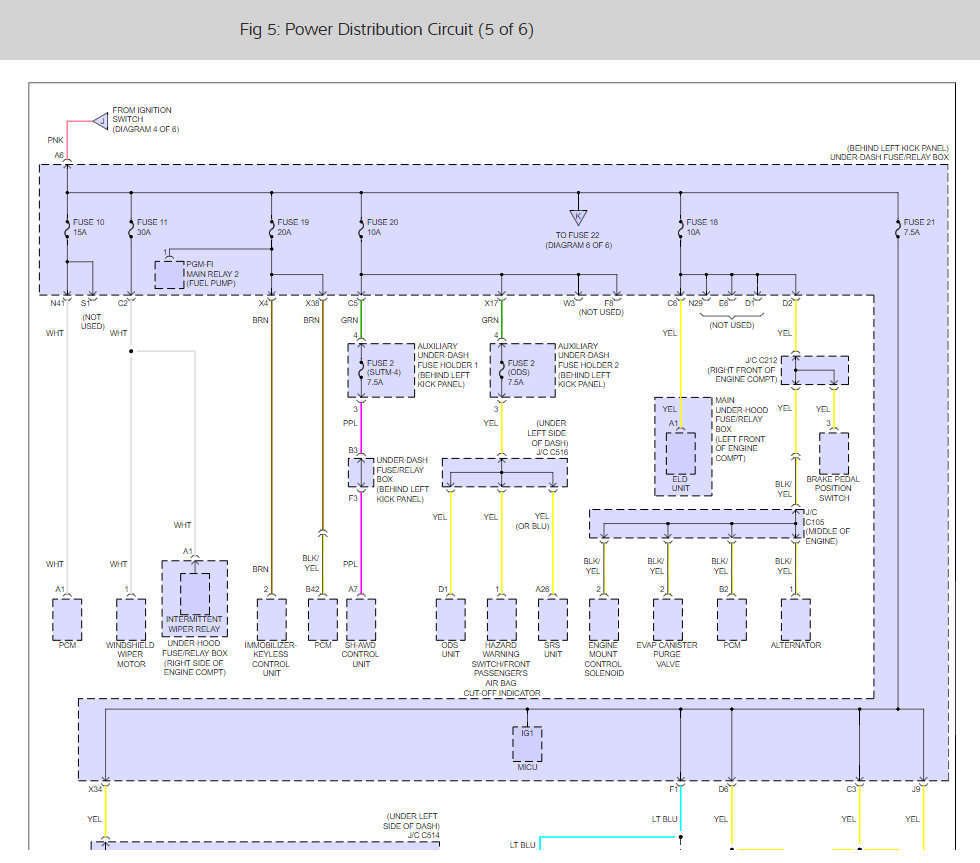

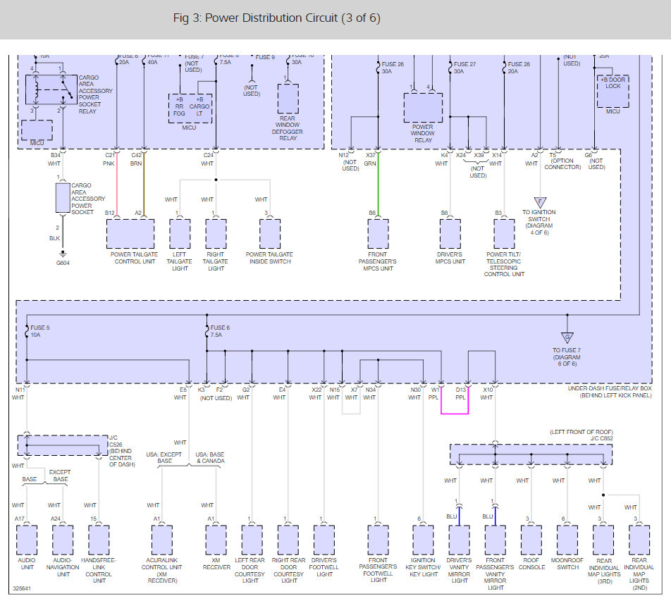

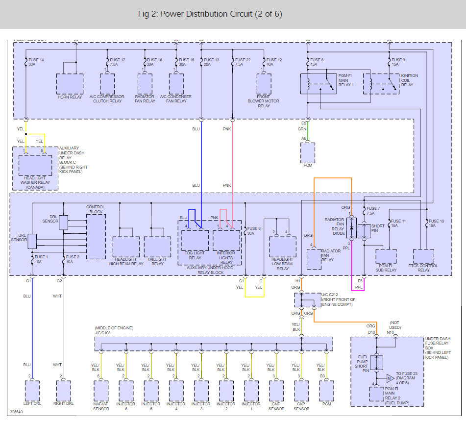

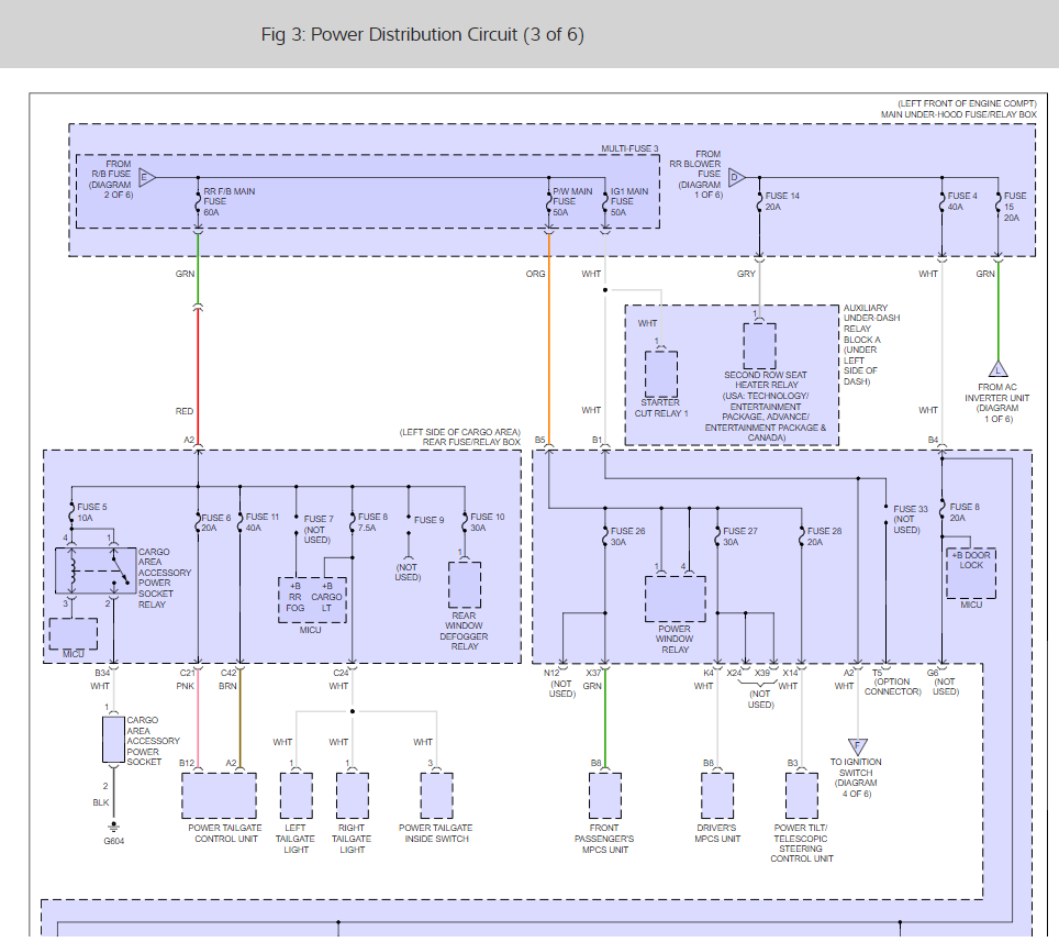

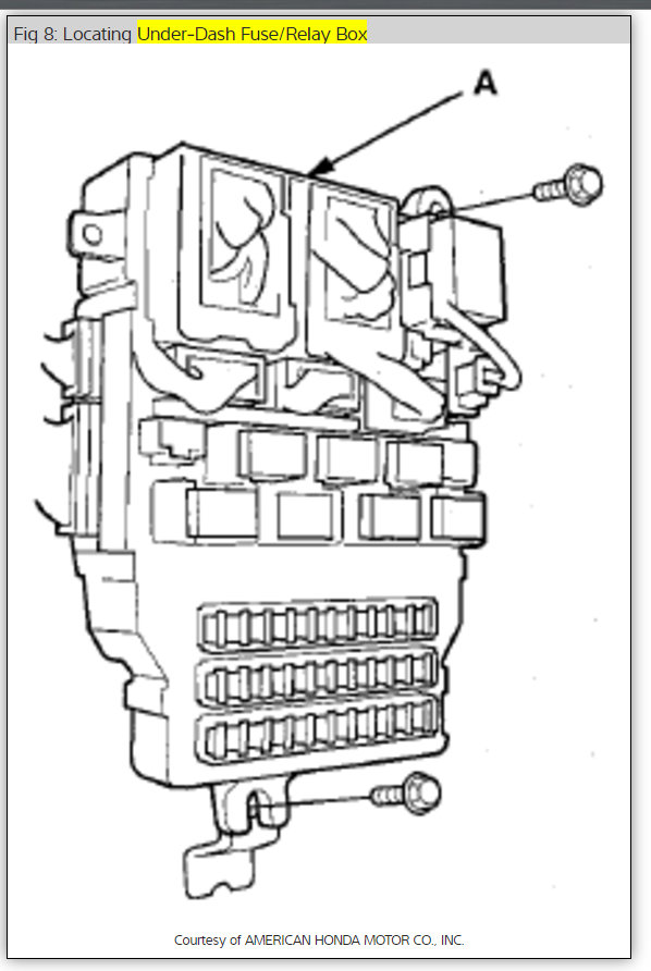

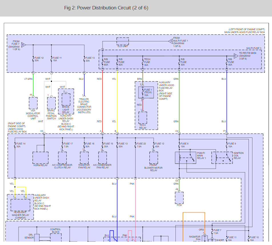

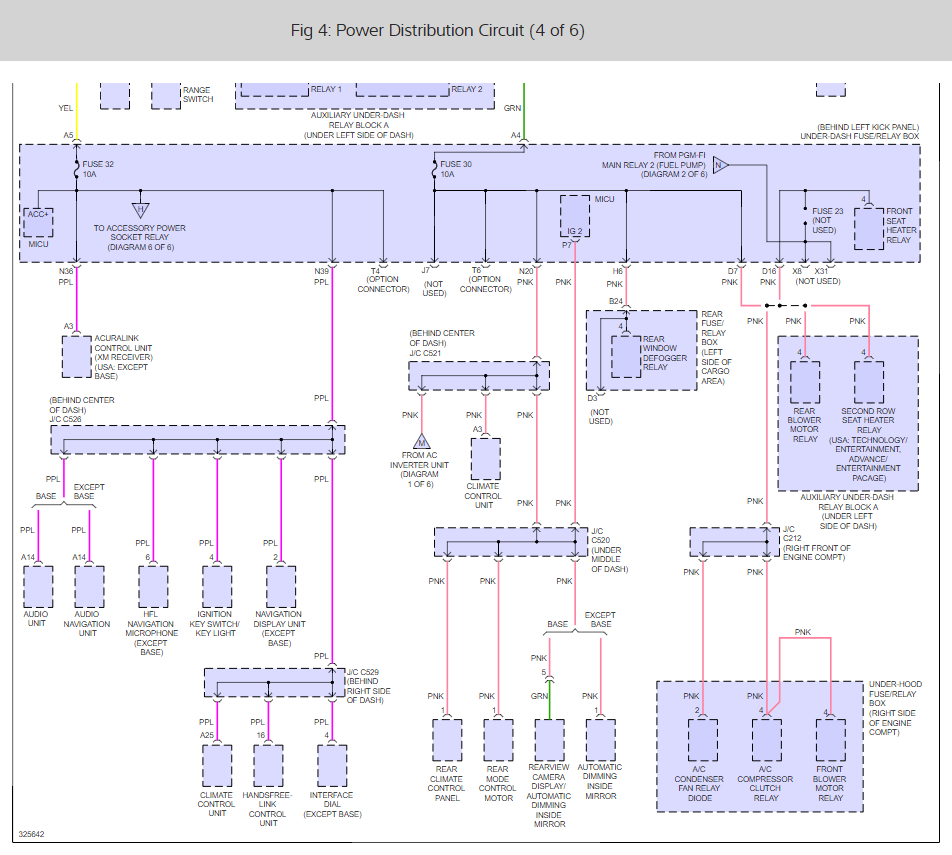

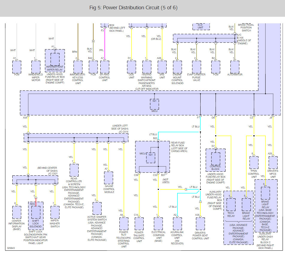

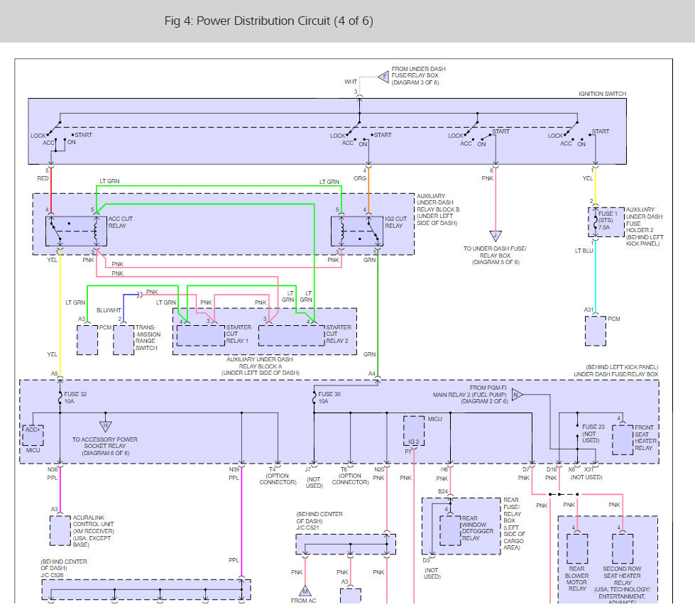

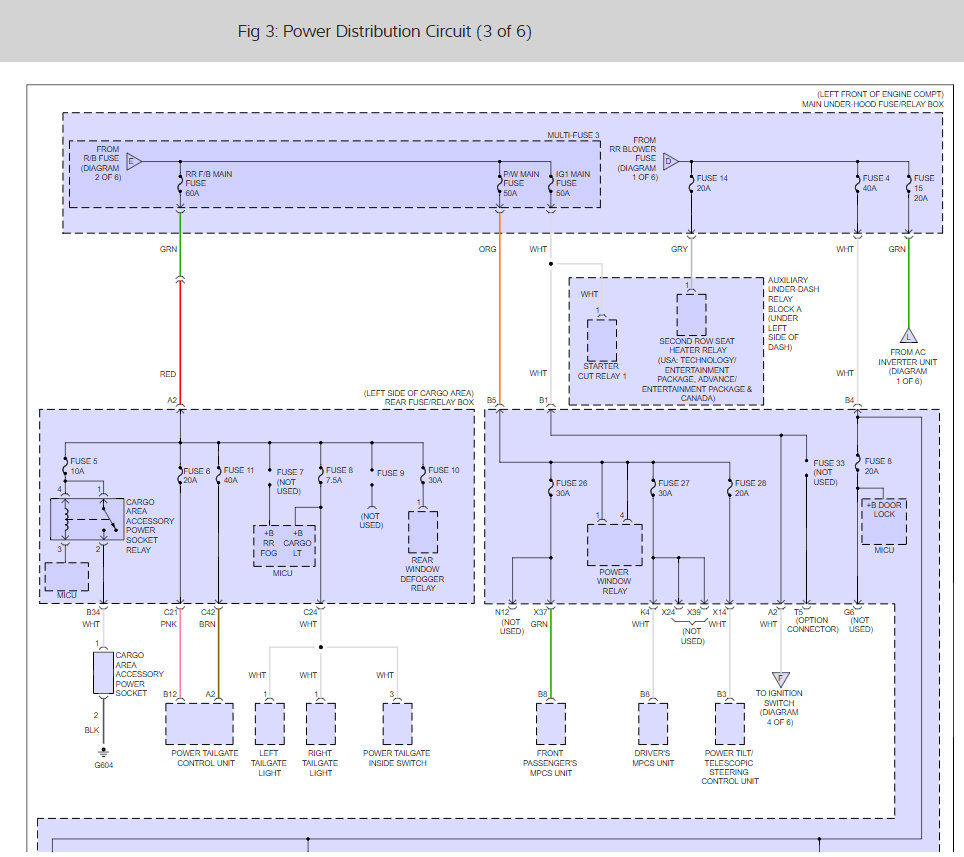

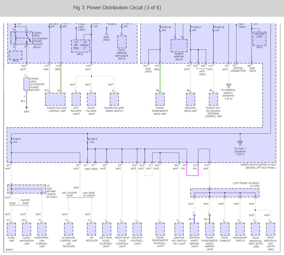

I have a current draw of 0.5A caused by the #4 fuse (under hood by the battery) or the #7 fuse (under the driver's dash) which point to the backup circuit. What should I be checking? I have already checked the hands free link or A/C clutch relay, so they are not the issue. I have no navigation system either.
Aug 30, 2017 at 1:48 PM
  • 55,423 POSTS

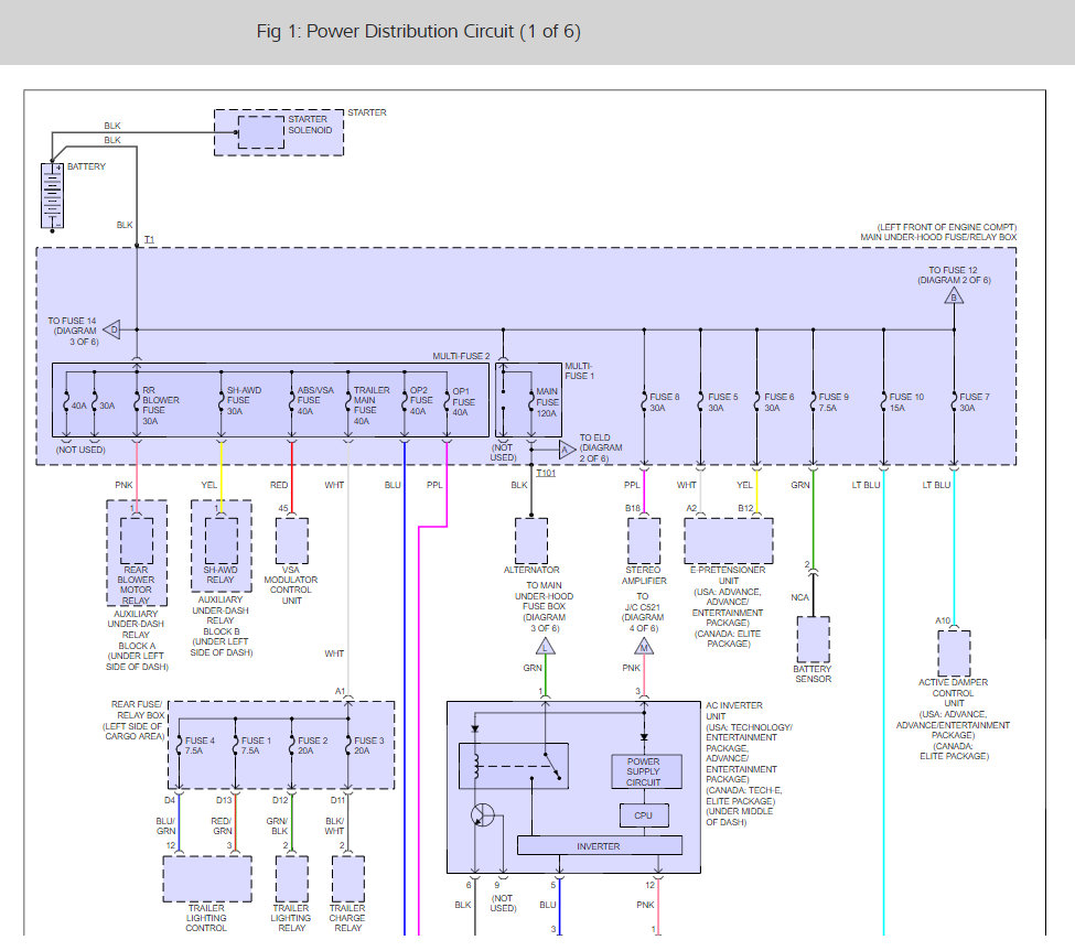

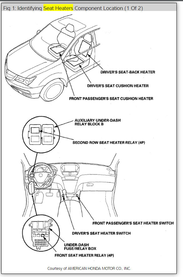

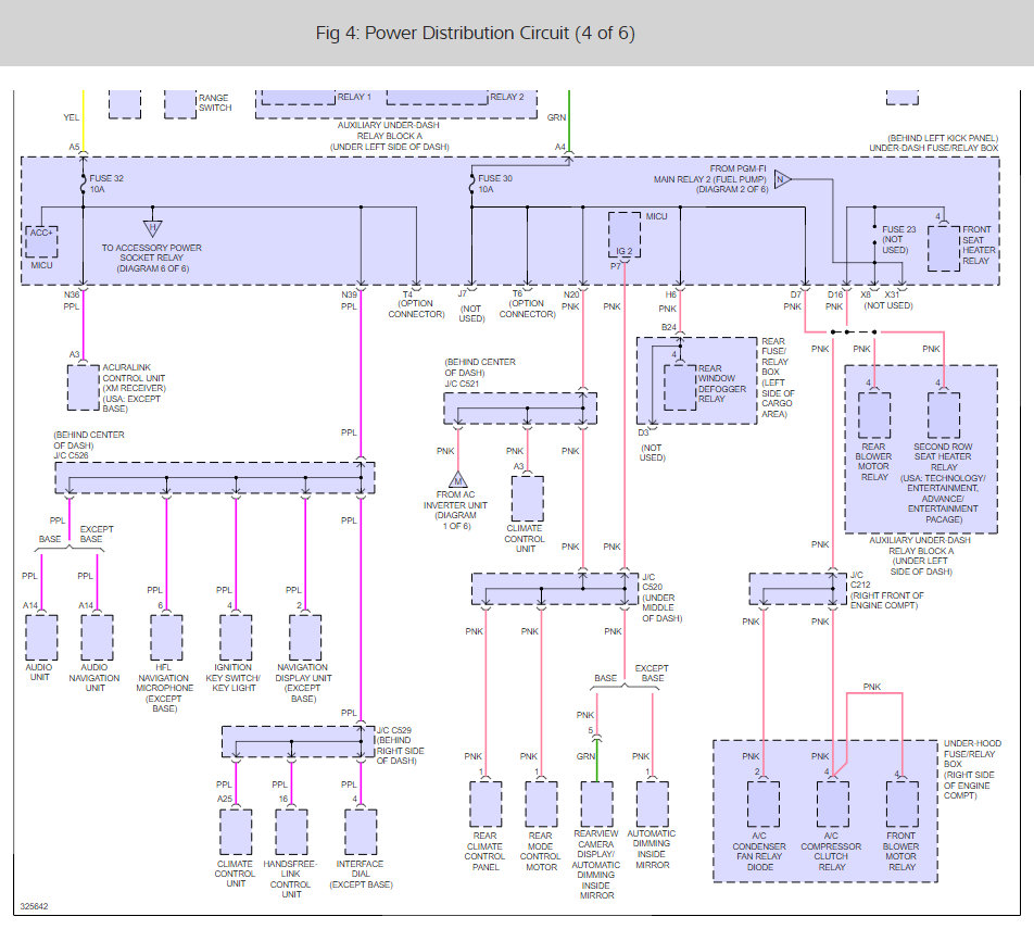

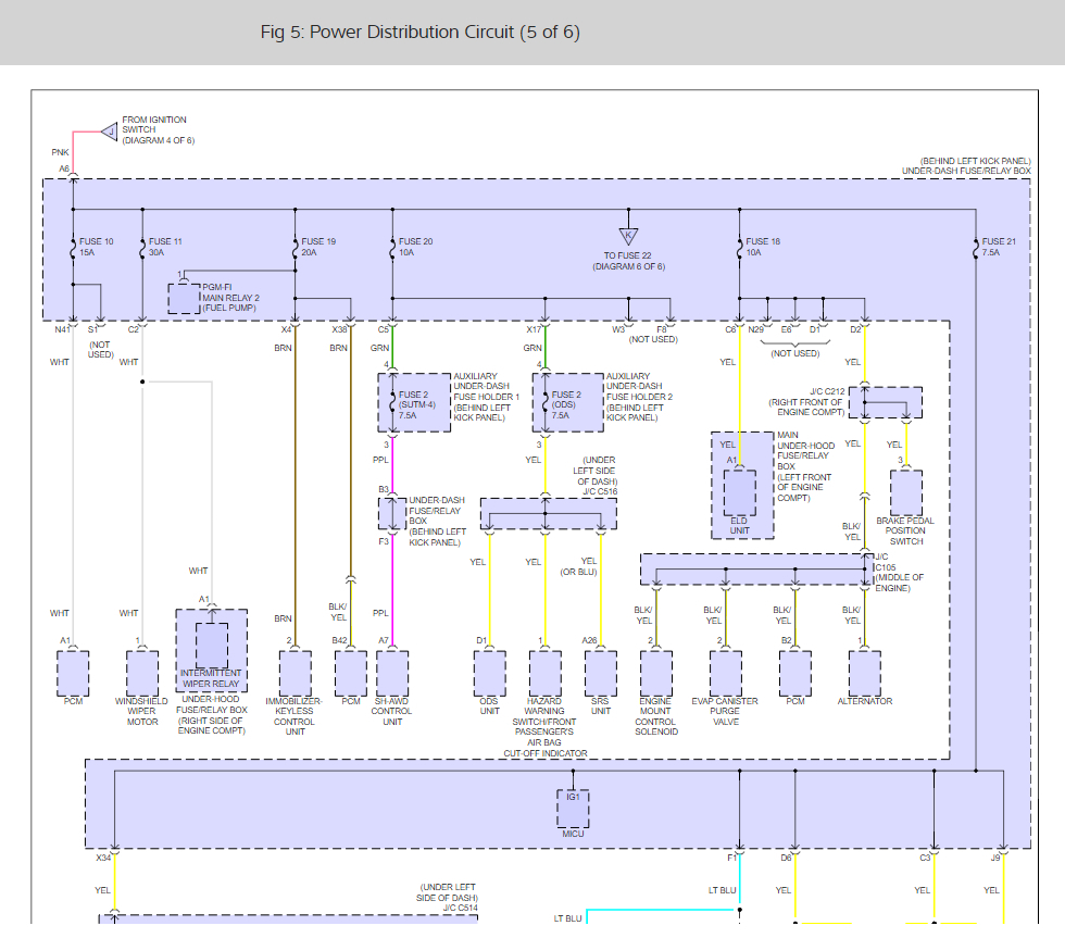

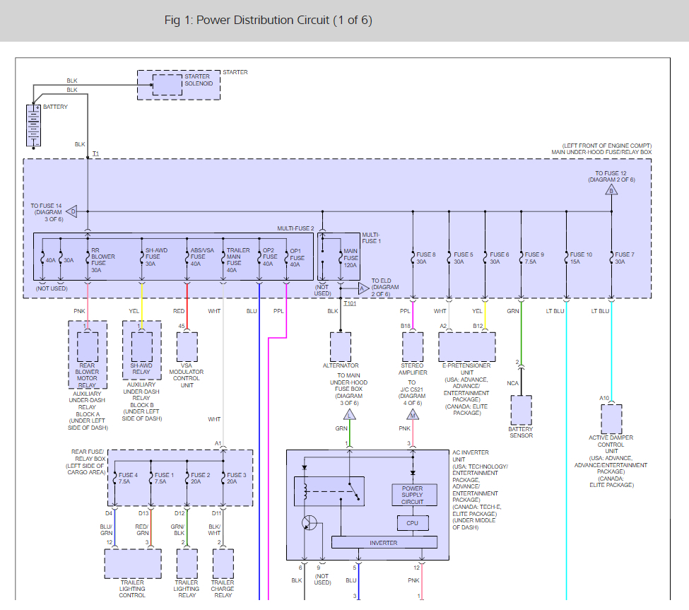

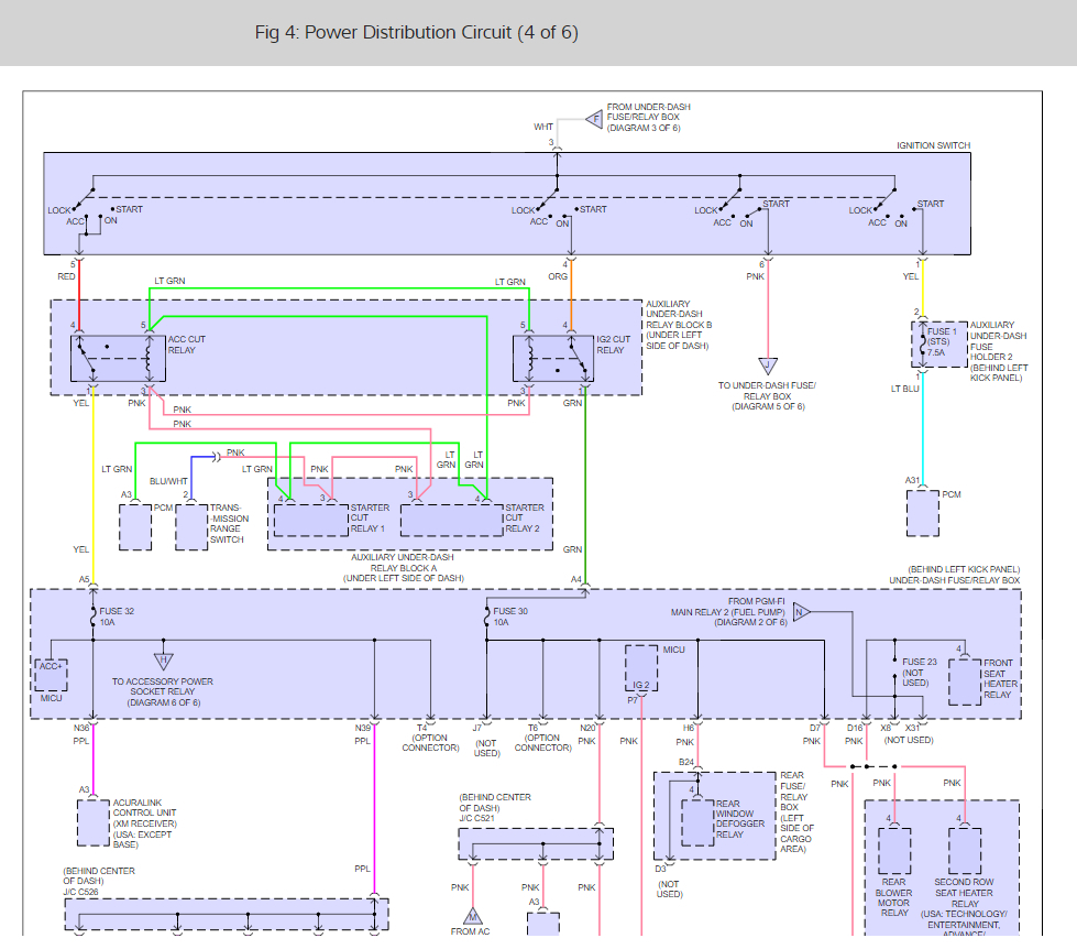

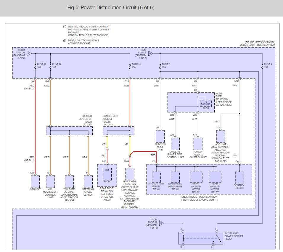

It looks like fuse #4 in the under hood fuse panel goes to the heated seat relay which could be stuck on are the seats warm? I would remove the relay to see if the draw stops. Below are some wiring diagrams so you can see what I am talking about.
Here is a guide that can help as well:
https://www.2carpros.com/articles/car-battery-dead-overnight
