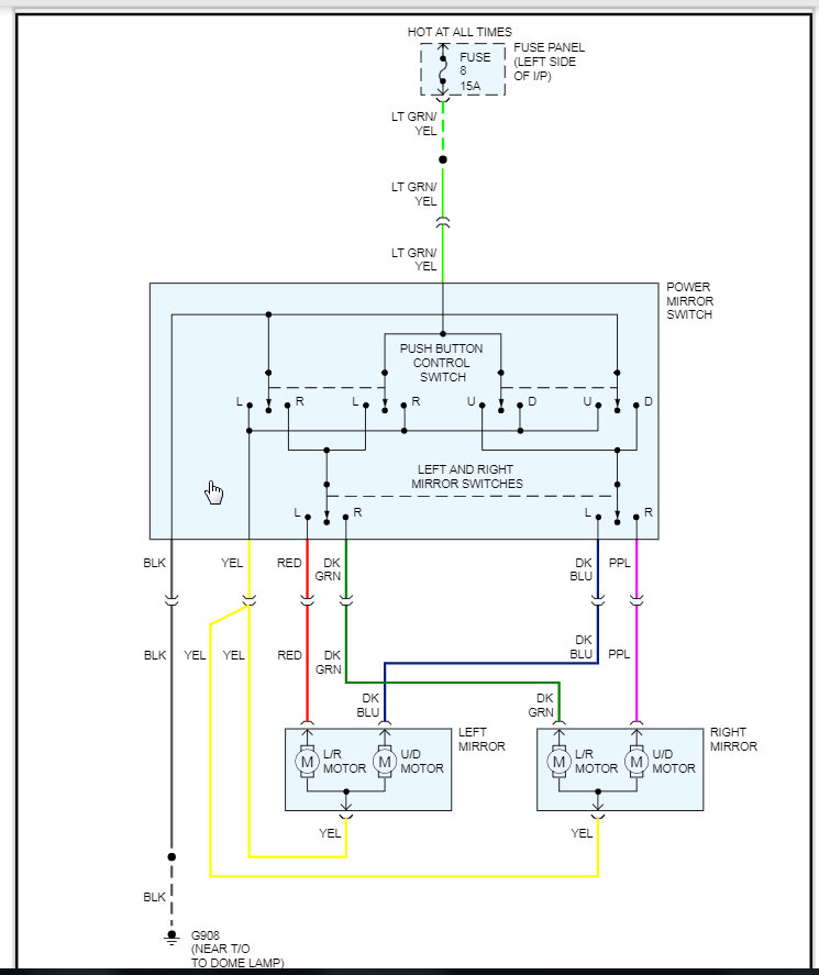

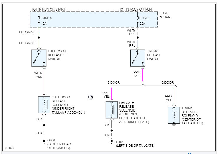

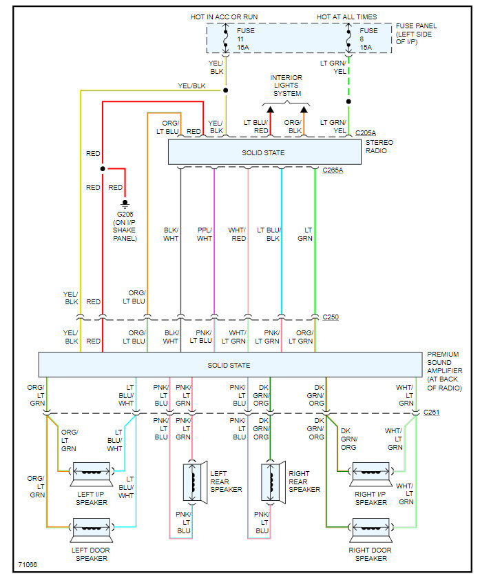

I found what was draining it used a test light fuse #8 power mirrors, fuel door, radio, and a couple more things. Does this mean I lost a ground?
Aug 4, 2020 at 2:30 PM
It could be a loose ground but the best way to find out what specific component is causing it once you limit it to a fuse is to remove the components one at a time until the draw is gone. That means any connector on this fuse should be unhooked and see when that draw is gone.
I attached the wiring diagrams. I would suggest removing not only the mirrors but also the switches and other things on each of these diagrams and check the draw on each one.
Aug 5, 2020 at 12:06 PM
